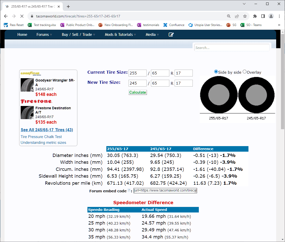

It will work, but I'm curious why you want that tire in Florida. Most seem to choose that tire because, if I recall correctly, it is a rare all-season that is also three peak snow rated. IMHO, I'd get something else for Florida.

You’re on to something Sid.
Smaller tires mean speedo reads higher, which means more miles recorded than you’re actually logging.
When there are 95,000 actual miles, the odo might read higher than 100,000 miles (I.e., out of extended warranty) and we all know what happens at 95k actual miles. ?
Hmm, are you secretly saying to change the tire size in FORSCAN to something ginormous and thus give ourselves a free "extended warranty"?

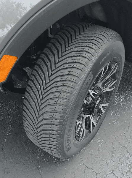

So I pulled the trigger. I went from 255/65R/17 to the Michelin 245/65R/17. I hardly notice any difference at all. It is definitely a quieter ride and tracks very well. I am ready for rain now baby!
