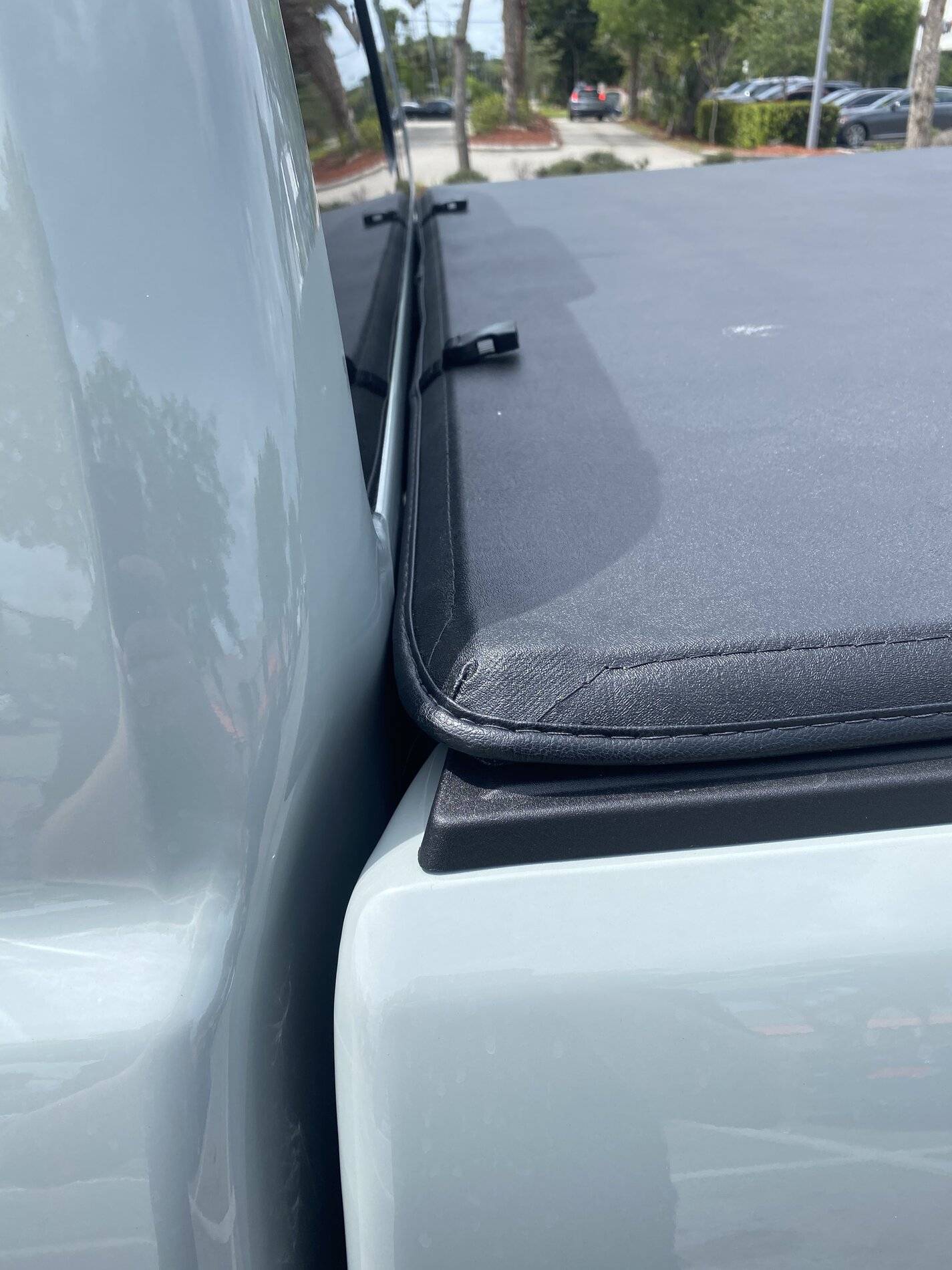

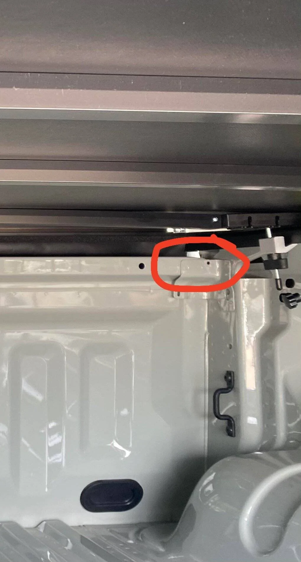

The thing is getting close to the truck as possible to cover a majority and the other issue is the strip isn’t made to go into the side divots that is in the bed, you’ll need to either fill those or live with them.
see below the holes I’m talking about.

The picture you are displaying is not a leer SR250 cover.

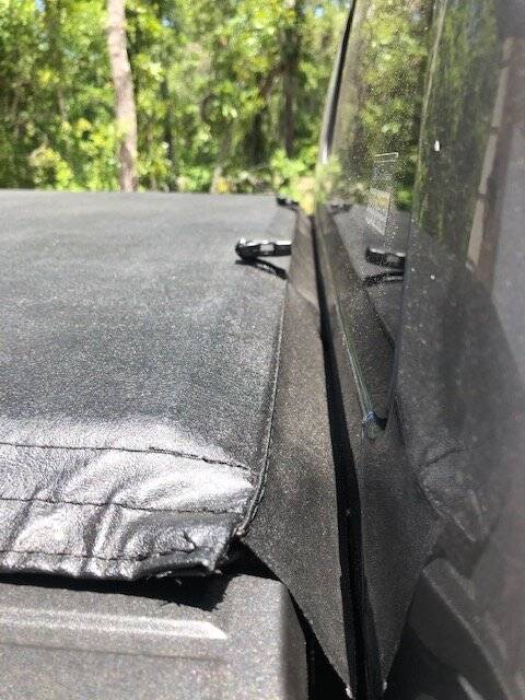

This is the Leer SR250 if you try to move the cover more forward it will expose the back of the bed

Yes to some degree that is true, this is sadly more then a leak. Bought new bulk head seal will wait for some rain sealed back up tighter also.

I don't have a Leer, but, on my Gator it wants the seal installed flush to the back of the bulkhead, meaning farthest away from the cab. I don't think you want it so close to the cab. But, yes, the seal looks too short.

I did fill those gaps with the new bulkhead seal, also ran a seal under back of tonneau rail that sits across the tailgate
I wish I would have joined this forum and seen this before I bought mine. I have the exact same issue. The rails are about 2" too short and won't allow the front and back to sit on TOP of the front bed wall and the rear tailgate simultaneously. Also there is NO seal at all on the rear, only a small piece of vinyl flap. I am returning mine but am anticipating an issue with the vendor and Amazon as he is being real cagey.
