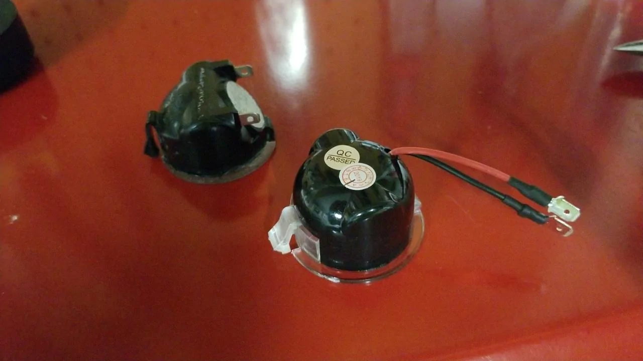

I installed the LED Puddle lights yesterday. Pretty straight forward although its not a true plug and play. You have to cut the old lights off so that you just have the wires, remove about a quarter inch of sheathing from each wire and connect it to the leads of the new light, then wrap with electrical tape. Was hoping for just an unplug and plug in the new one, but no big deal. They look fantastic, just hope they last.
Edit: Reading the post above mine, maybe I did it wrong lol
Here's the stock ones, unplugged and the led ones.
