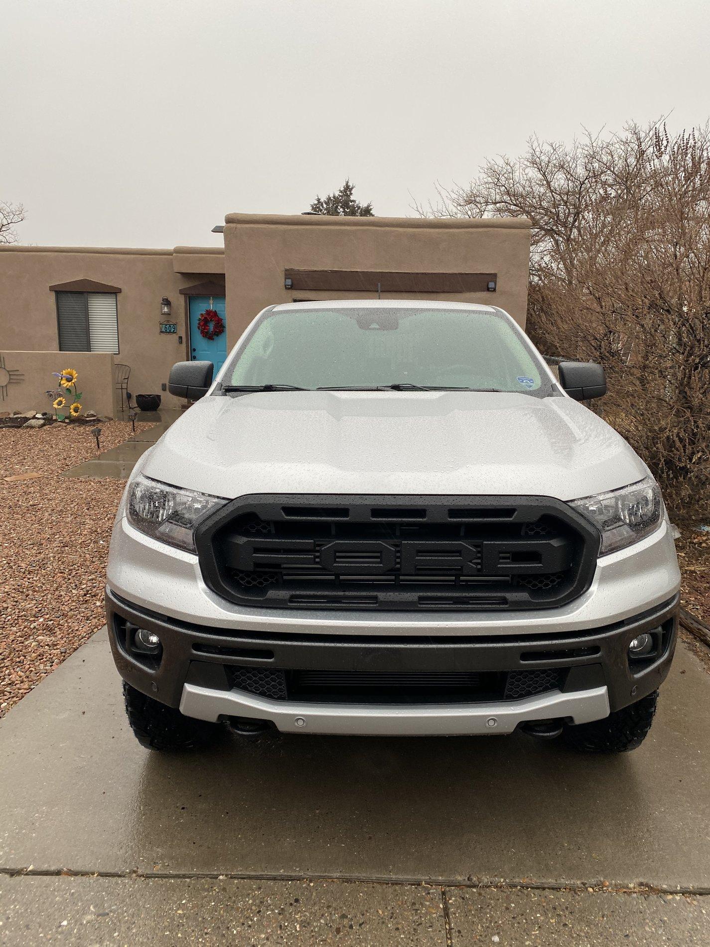

I just installed mine today and purchased from the Toyota Accessories Guy for 150 bucks shipped. Looks great and can’t complain at all. Shipping took almost exactly a week from China. Not worth paying 200 or more from others when you can get it cheaper.

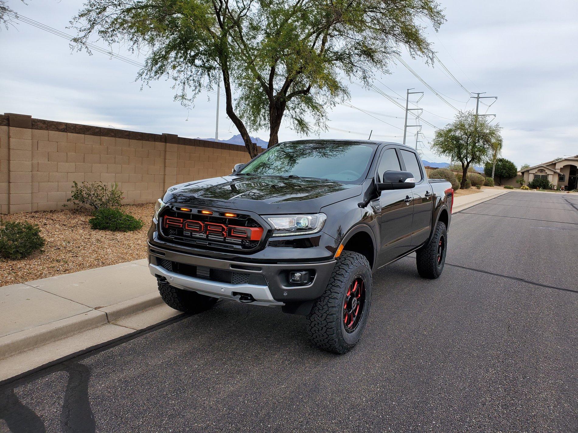

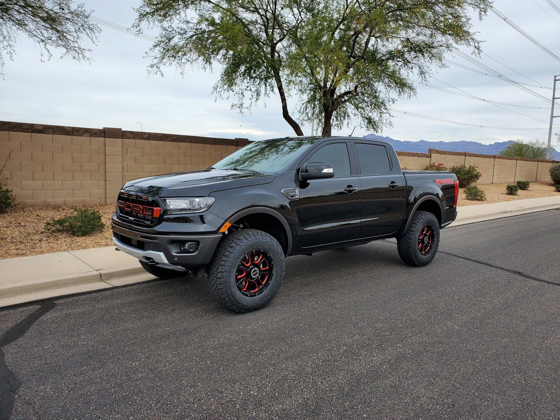

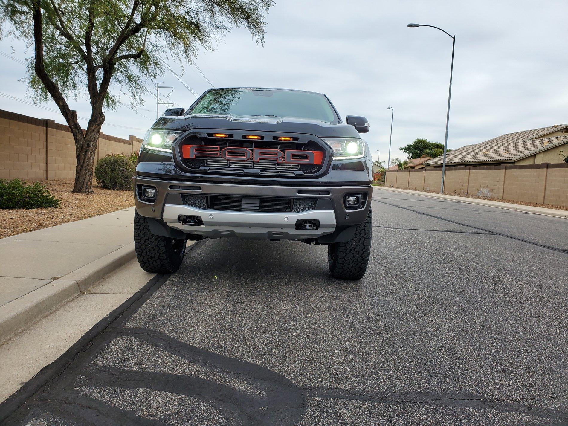

Men, I loved your tires. What size are those and did you use 2" level kit or spacers?
Thanks!
They are BFG KO2 A/T 285/70R17 I have the same size on my 4Runner and they are great tires. I went with a suspension upgrade from Icon. It includes coil over adjustable shocks and upper control arms. I have the shocks set at 2.5" in front. The rear is stock height because I didn't want to increase rake. It sits almost level with a slight forward rake. I had to readjust my headlights, but that was very easy. One thing, if you are going with bigger tires you will need to trim the intrusion beams and get wheels with a little less offset (or backspace).

Did you install any leveling kit or had to cut the crush bars? I wanna put the exact same size, I'm new on this and I want the same look as your truck.
Read what he wrote. He told you everything you needed to know.
