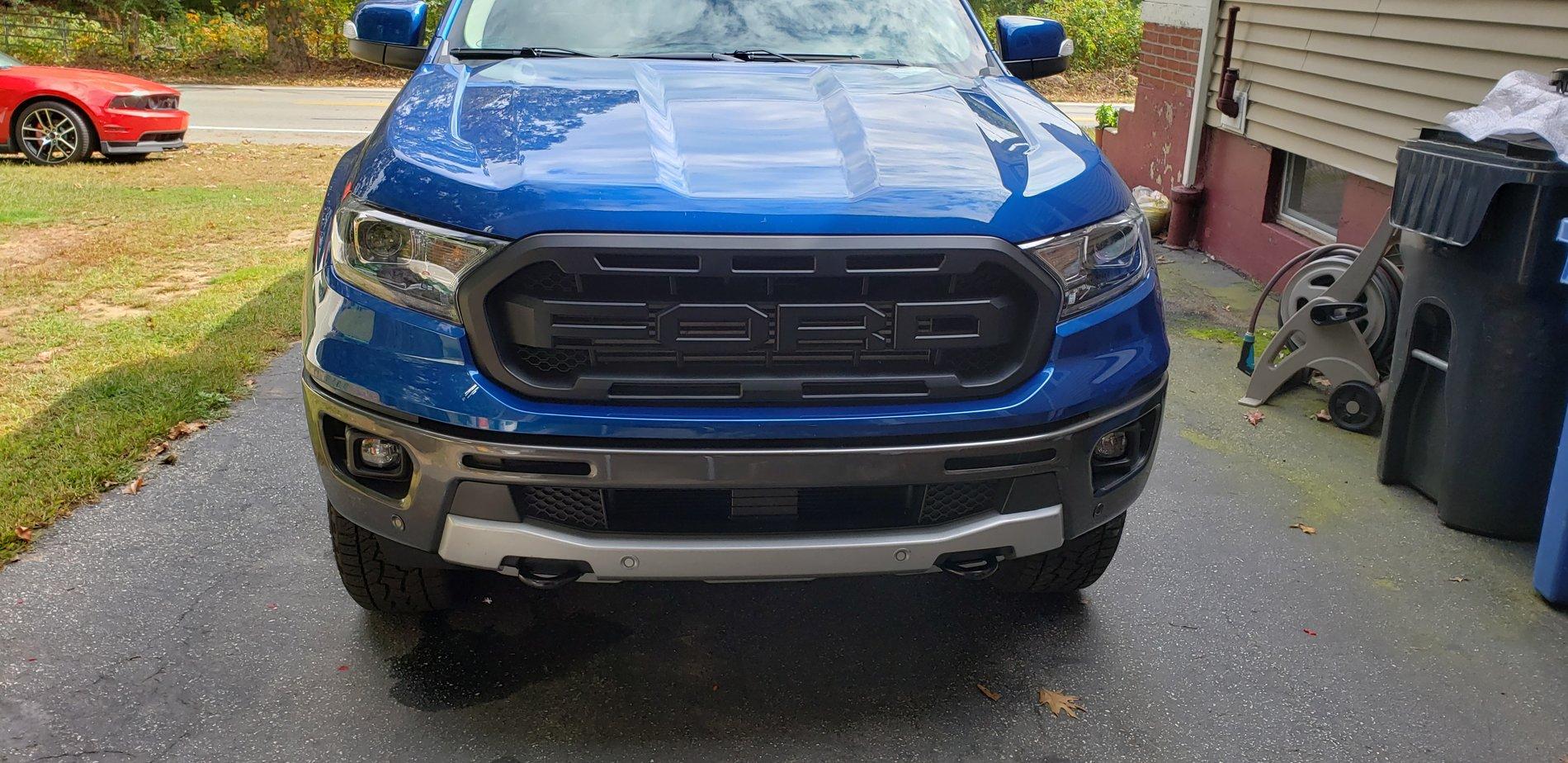

Got mine installed last night! Pretty easy swap, ~30mins. I don't see everyone's fuss about the bottom and side tabs being so hard to dislodge. I stuck my arm in and using a precision screw driver under my thumb, working right to left, pushed down and with the other hand on the outside of the grill, pulled out. Easy peasy!
I started the install of the @Stage3Motorsports "Raptor-Style Lights for Raptor Grilles" but looks like I will need to install and fab up some type of mounting point, ugh. My upper tabs are just like the stock grill and are molded, not screwed on. The Stage 3 bracket uses the upper tab's screws as a mounting point. There went the easy mount solution. Will post pics when I get everything situated. So far loving the new look!
EDIT: I just wanted to clarify that I did not buy my grille from Stage 3. I bought from a Ford dealership. Just an FYI for anyone buying these lights to double check the grille mounting solution.
