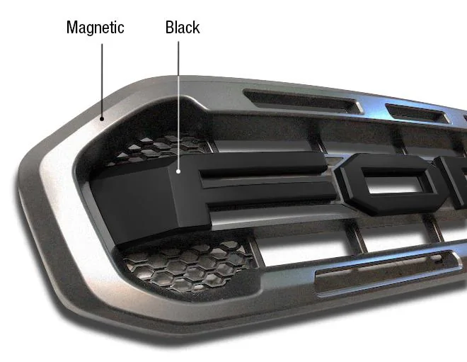

I dropped my grill off at a body shop today to get the perimeter and letters painted Magnetic to match my sport package trim color.
[/QUOTE]
Hey Tom, followed your lead and dropped my KO grille at my local body shop for a "Magnetic" paint job. (Also asked them to spray my AVS bug deflector while they had the J7 paint out.)
One thing I'm gonna do differently is NOT paint the FORD letters. I'll keep those black, to allow a subtle separation in color/tone. Something like this:
