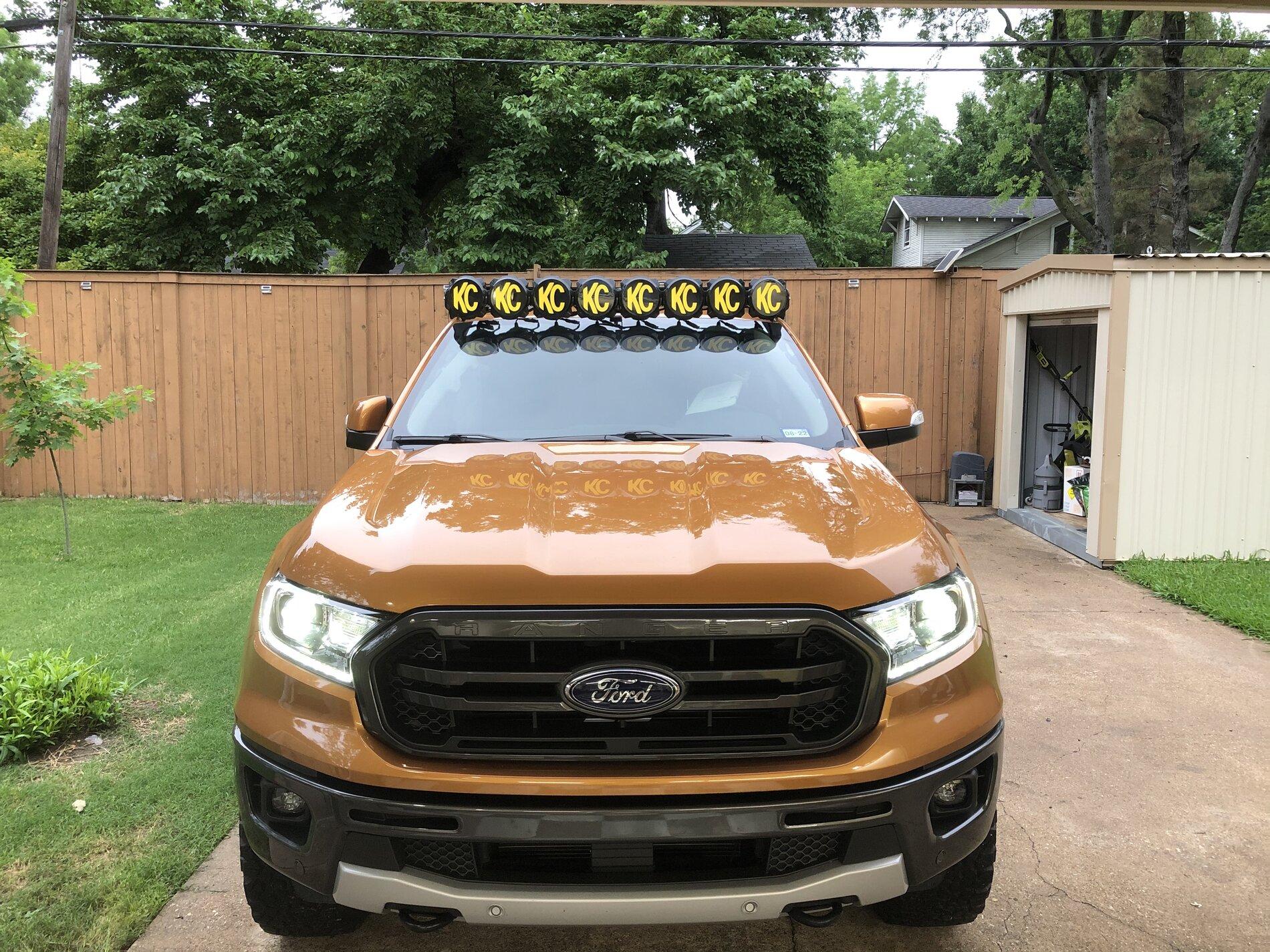

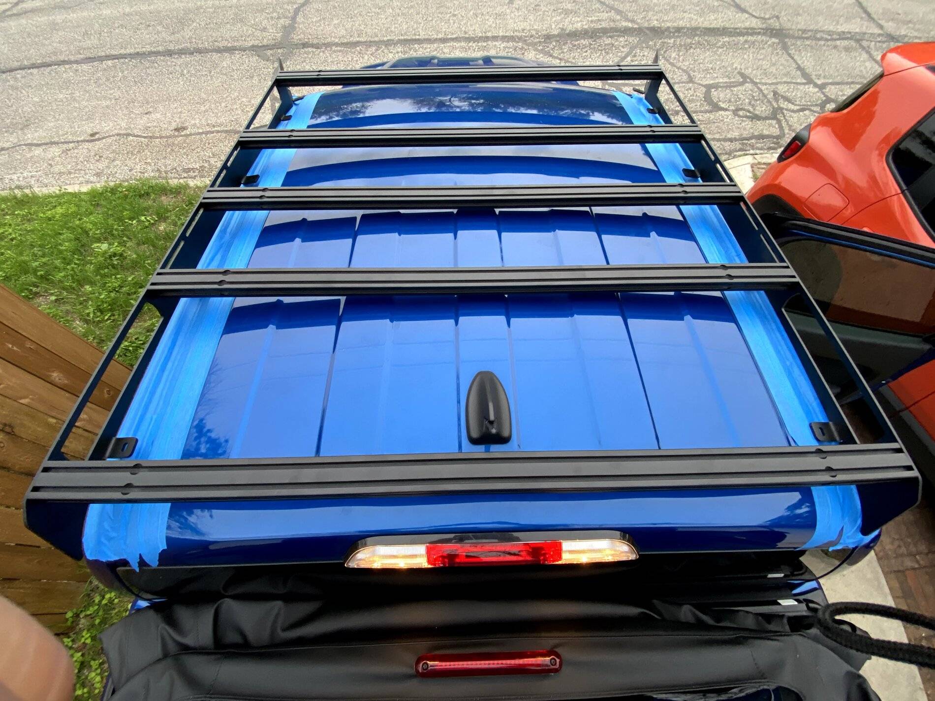

Looking at adding a roof rack with lights. The KC M Rack looks to be good quality and have everything. I noticed KC lists them as discontinued. Does anyone have any experience with these? Discontinued due to issues or just did not sell due to the price point? Looks like there still may be some new stock out in the wild to get.

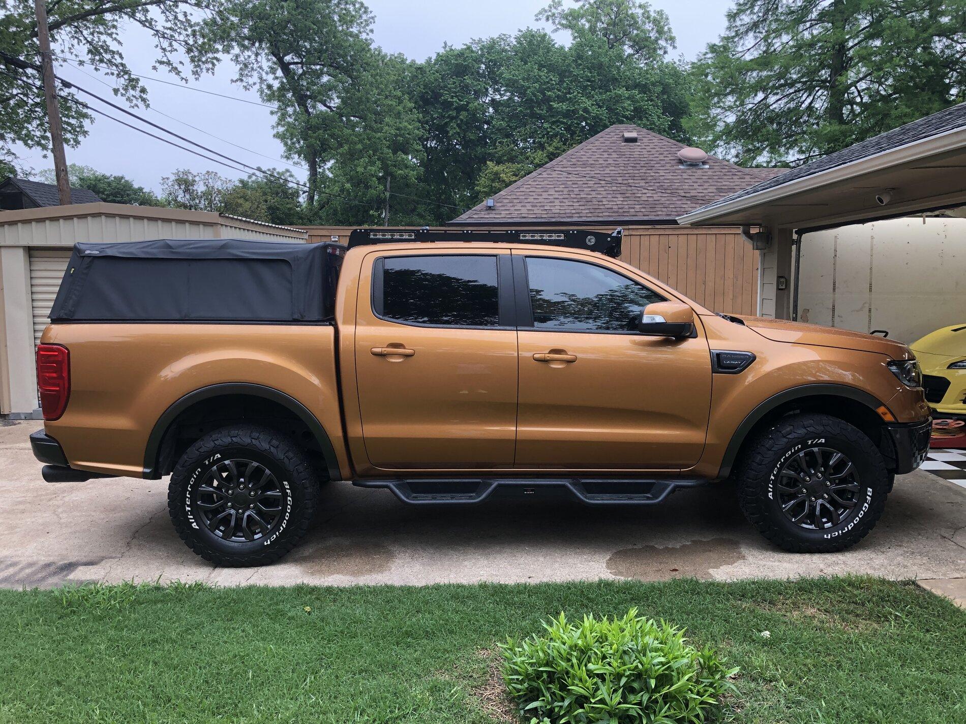

Looks killer.... Got a side view photo?

Here you go.

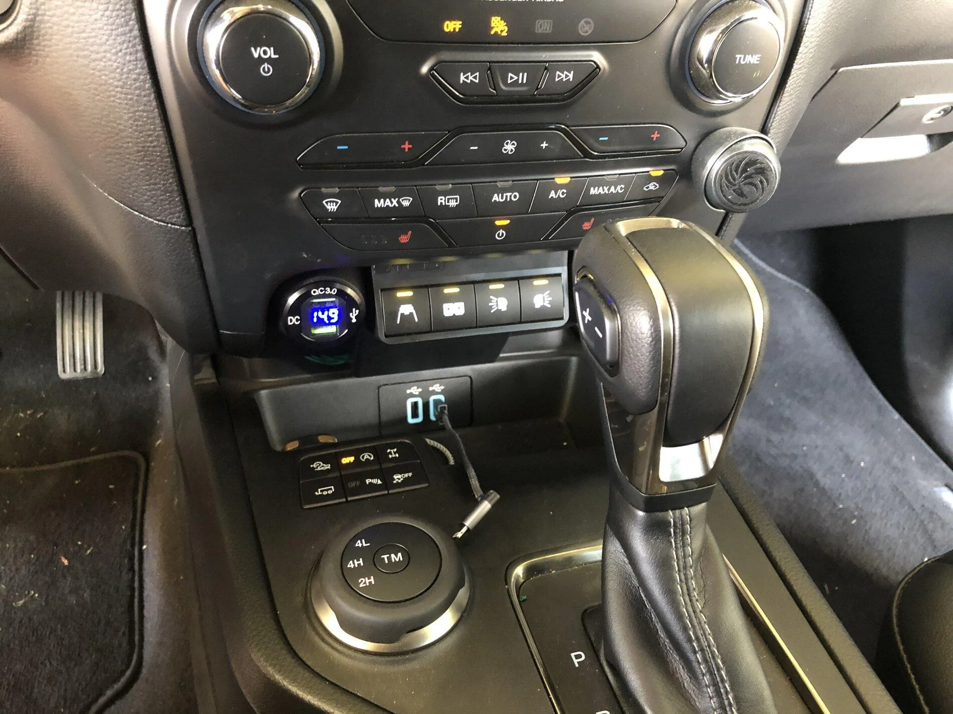

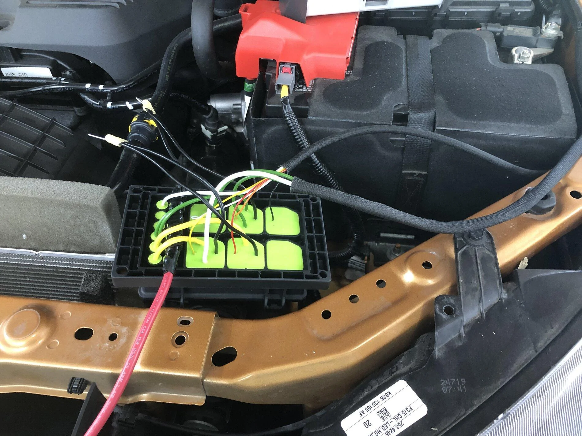

Changed my mind on wiring so probably bee next weekend on powering them up. I got the Stedi switch panel. Going to go ahead and get a relay box instead of doing separate relays. Still working in my head on a dual battery setup.

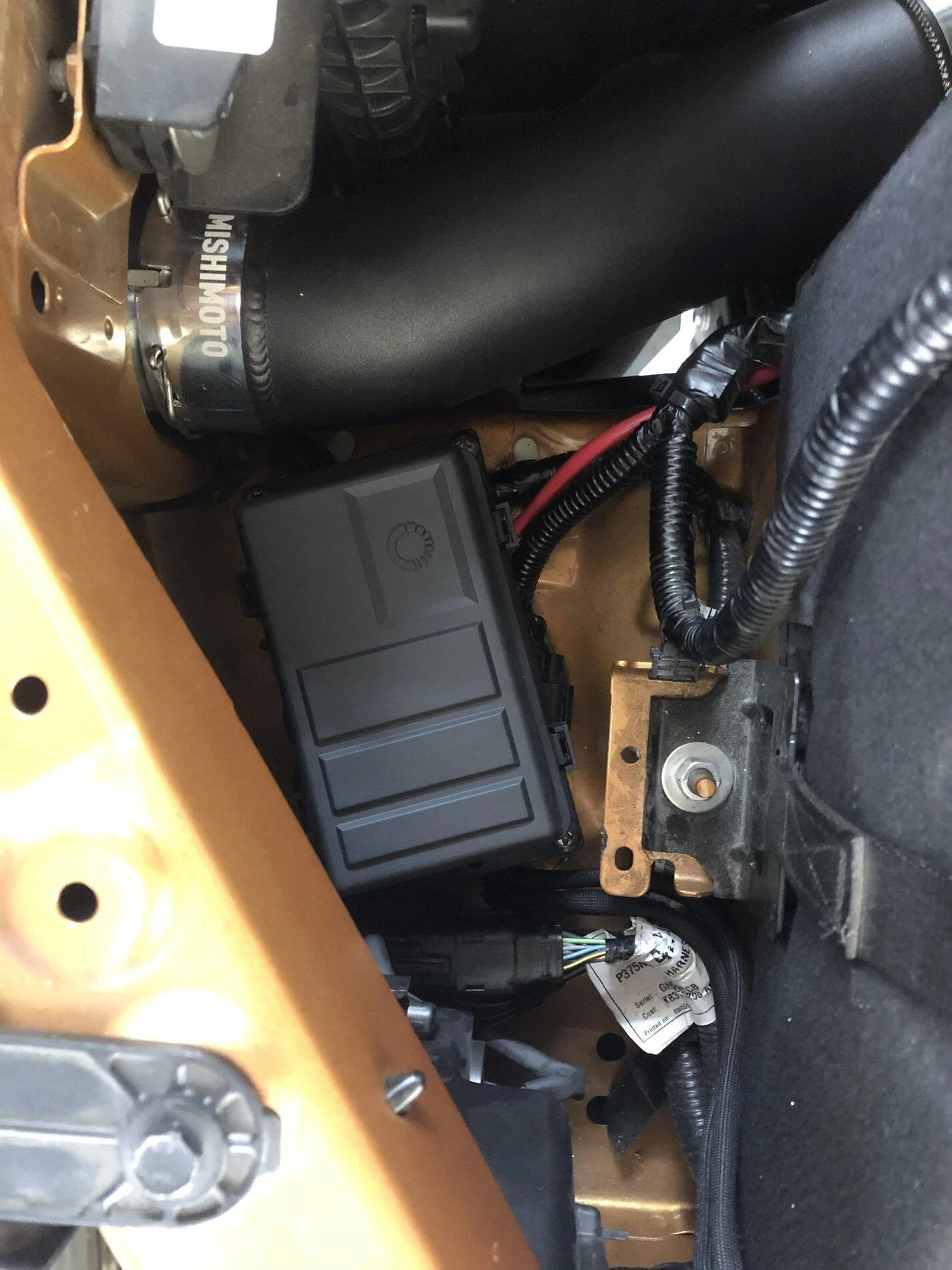

finishing out the wiring Today. Relay box mounted.

Interesting relay box, what brand is it?

I have been looking at this myself recently. I actually ordered one with the LED bar and then they contacted me saying there was a mistake on their website and they no longer offer it. They claimed to have discontinued it due to wind noise and now only offer the setup you have there for a little over a grand more. I am looking into buying just the the rack now and seeing if a Rough Country LED bar will fit it. I could care less about wind noise cause I am typically running with sirens or my system up.

I was wanting the bar also but found out it is impossible to find the curved bar. Thought I found one but when it arrived it was straight. This whole system was hard to source right now. Each part was purchased from different source. The M rack itself was a pain! First one that came in they had the wrong part number, I received a F150 M rack. 2nd one came it the box was broken up and all the hardware and cross bars were missing. Finally the 3rd one was correct with all the parts.

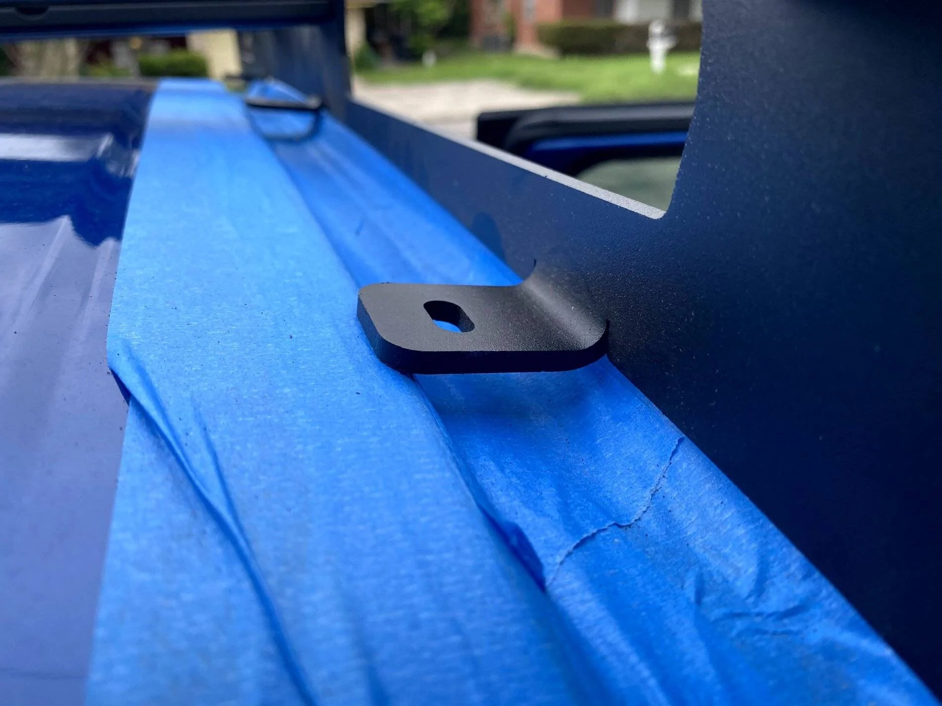

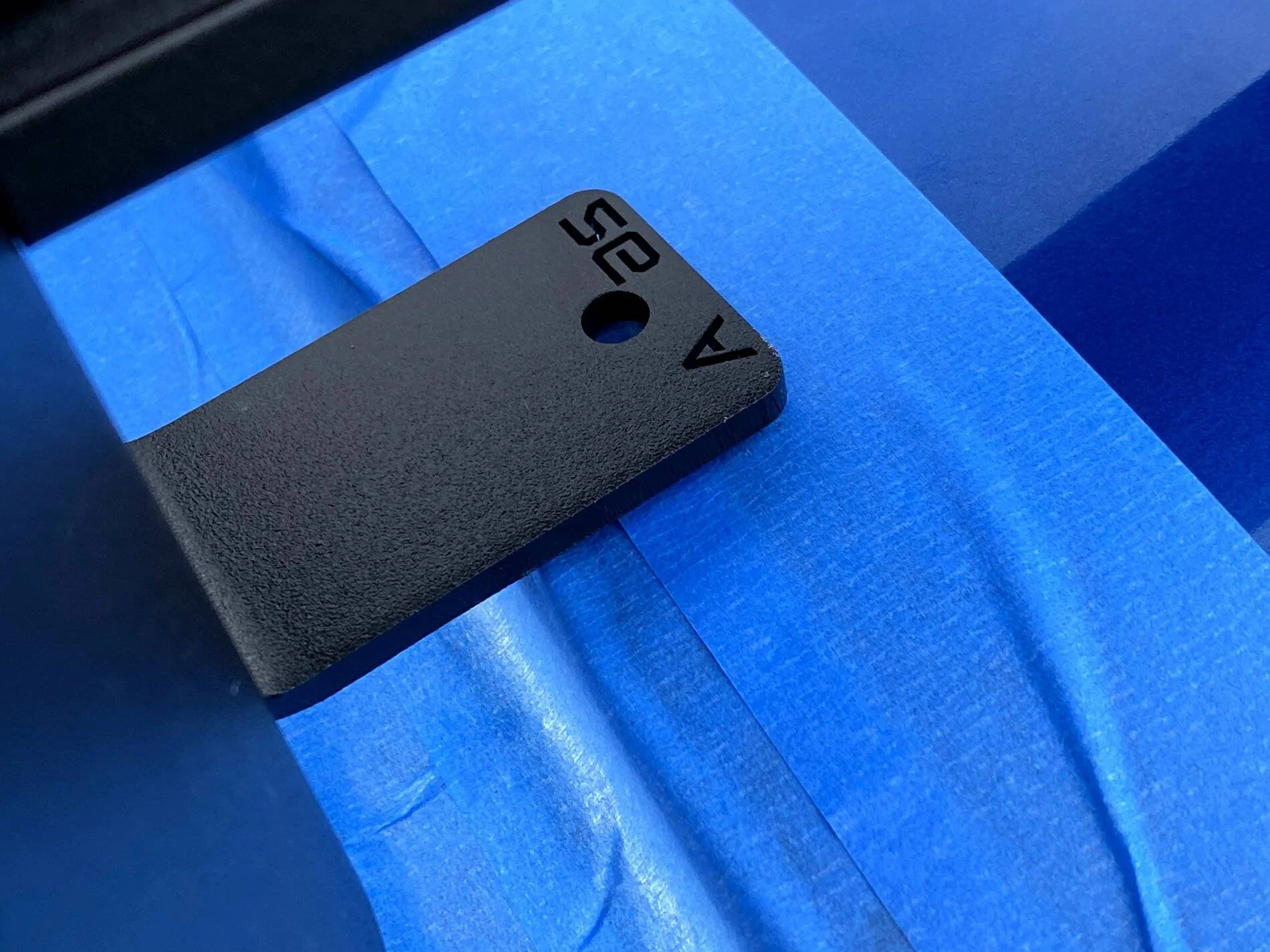

I love your setup. I ordered the M-rack without the lights. I received the rack but the parts didn't fit. apparently they sent the right packaging but packed it with a Chevy Colorado kit. Potential buyers be careful not to drill before confirming it all lines up correctly. I have the replacement one they sent and it looks like it will line up. I'm just concerned the tabs on the rack that the screws go through to mount to the roof are bent too much. I'm holding on the install for now as I am getting a bit of cold feet on this purchase...

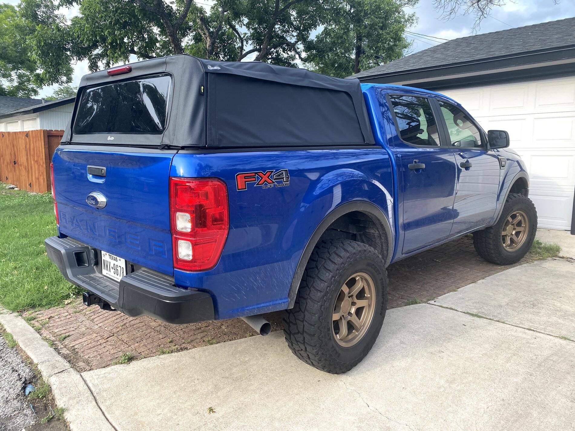

My truck for reference.

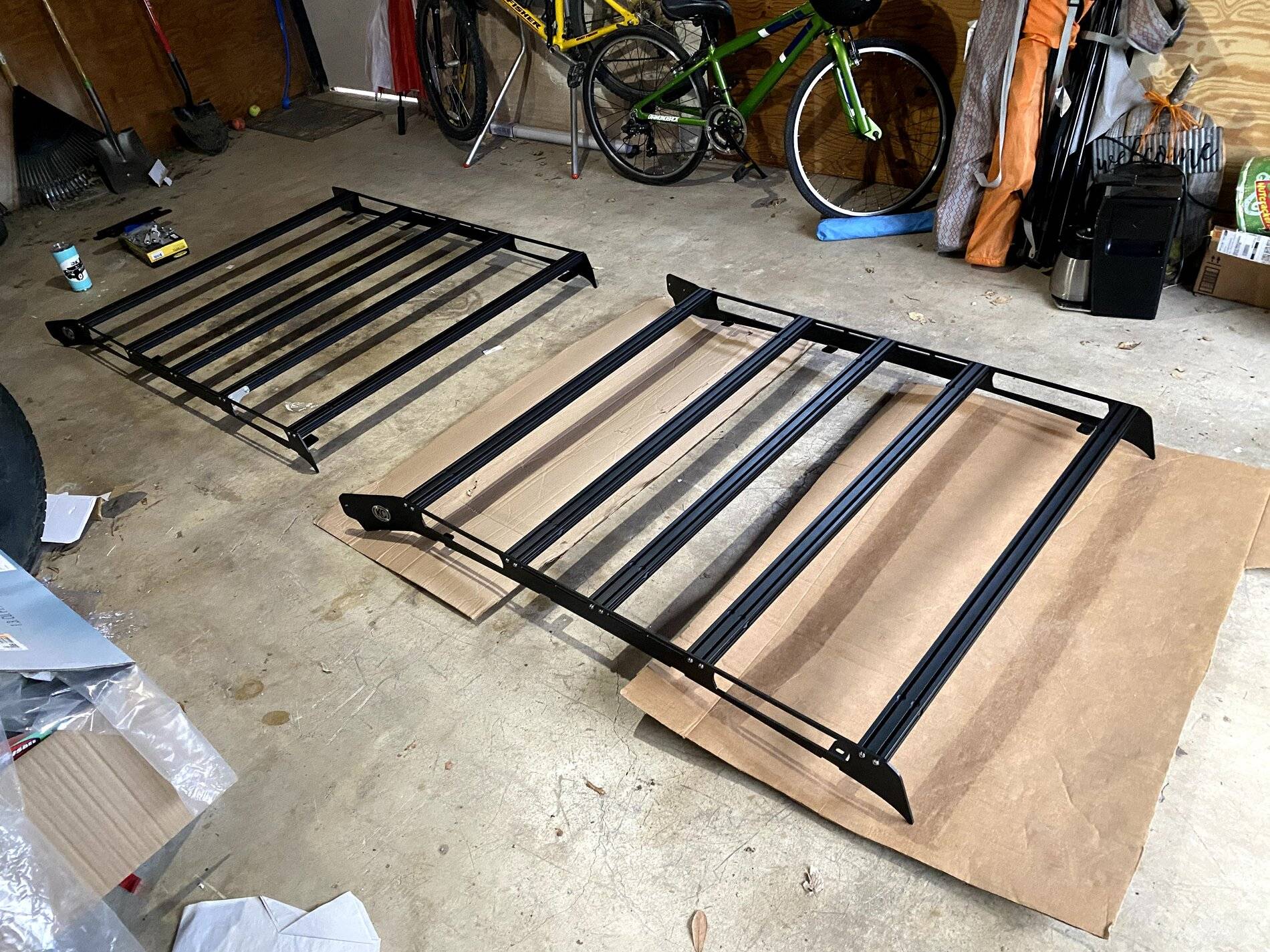

This one is the correct rack, some tabs bend up quite a bit. maybe by design?
Try guessing which is for a Ford Ranger!
(answer: right side is for the Ranger)

Mine just came in, how did you tell you had the wrong one at first? I need to open and check mine. I ended up buying a 50 inch curved light bar from rough country that I am gonna make fit the rack, but I got KC's side lights and rear chase bar.
I noticed the problem when I laid the rack on the roof of my truck. None of the tabs that have the holes where the bolts go through the roof lined up. (see photo of the wrong rack on a Ranger)...notice the hole falls to the inside of the roof, away from the channel.
Also, I see that the light bar width on the KC site says the 50" light bar for the Ranger is actually 51.625". Keep us posted on that bar and the fitment.
