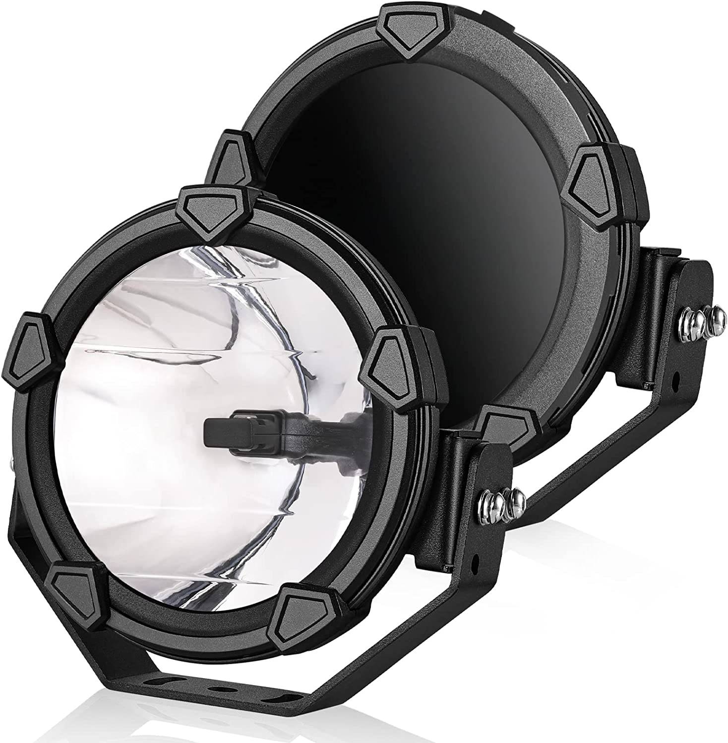

KC is 6" at 20w (each) @ $550 a pair
Knock-off is 7" at 40w (each) @ $160.00 a pair
So the two key differences;
First, Internal LED shield/director, products basically are the opposite of each other. However I am wondering if the factory worker in China tasked with taking the photo and doesn't even own a vehicle just accidentally installed the it in the wrong orientation. Dunno.
Second is reflector cup - KC having multiple directors and it appears the knock-off is a typical smooth bowl design with the directors in the glass/plastic lens.
I wonder what the actual light mechanics compare in the end, something truly worth of the extra $400?

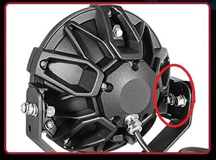

It also appears by my guess (though they do not advertise it) the brackets appear to be linkable just like a KC Gravity setup.

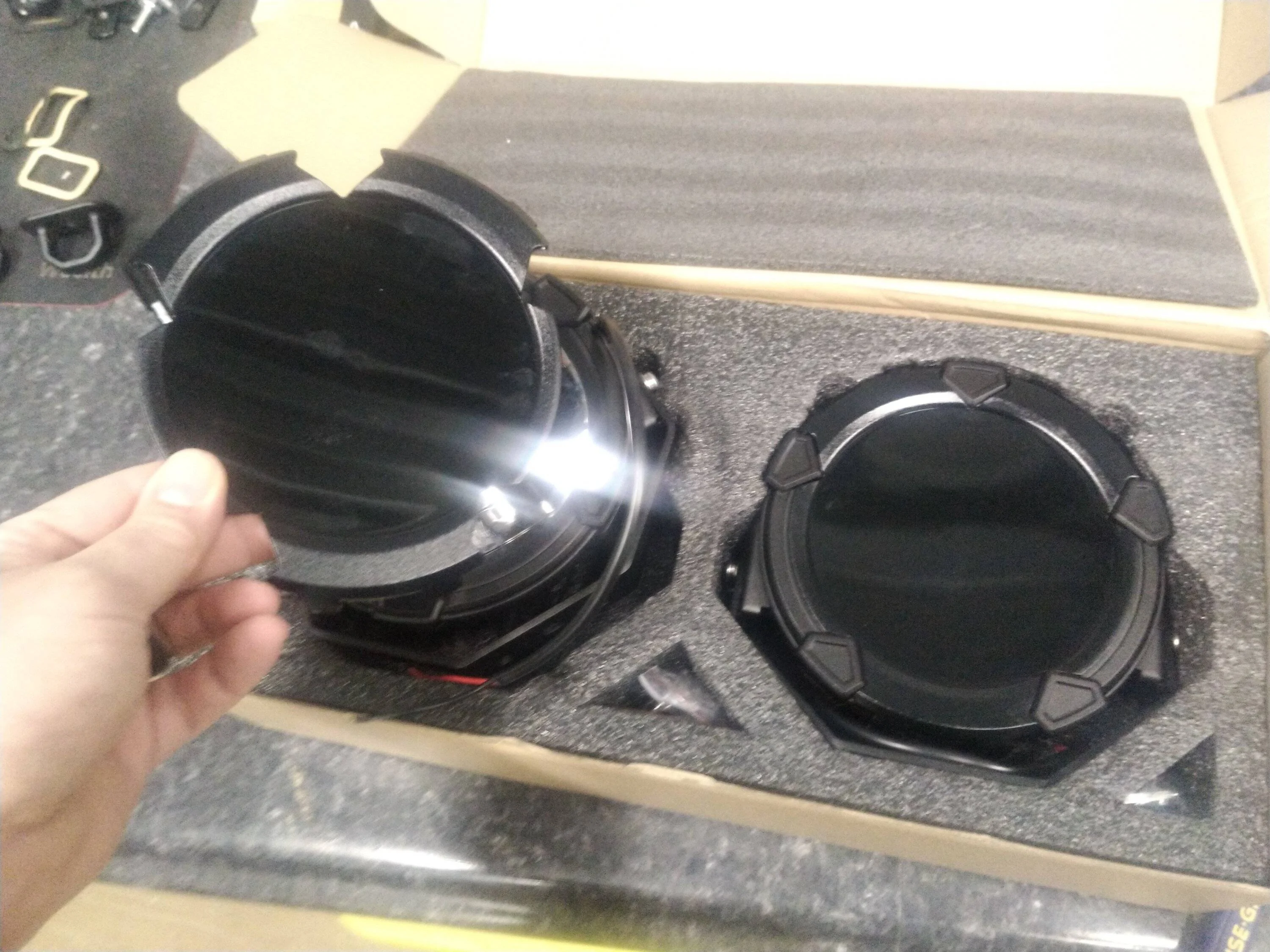

One set came in today. I am going to try and go out this evening to see what is up with them. Need to find a stand and rig up a temp harness to connect it to the battery.
Initial impressions is solid. I can find no machining marks or other obvious defects. The LED pedestal/stalk design looks like the same design many of us install in our headlights.

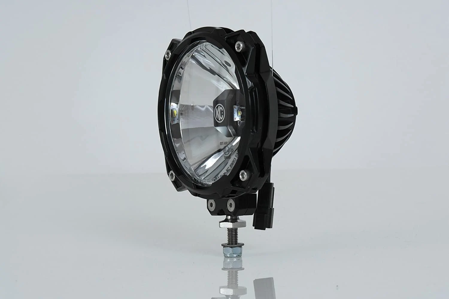

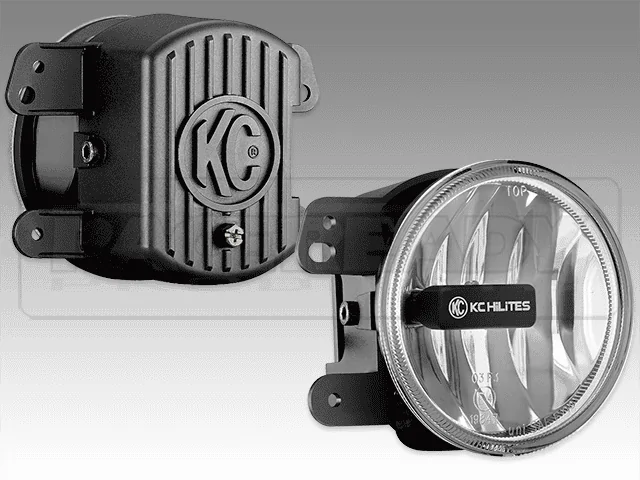

I was mistaken about the reflector cup, it is not smooth and it does in-fact have directionary design molded into it. Now that I have a hands-on look I think I get why they positioned the stalk in the way it is. Coupled with the cup design I think their intention was to project more of a rectangle type focus light and not a round one. Similar to fog lights, but far tighter. We will see.
Their cup design is basically (though not identical, fewer ridges) like this, but turn it sideways. Will be interesting to see what it looks like.

So no YT level testing with video yet, I just don't have time this evening to go out and find the proper distance. I will provide some initial redneck garage opinion though.
Before we start the disclaimer is this; the company did offer me a deal on 6 units after I discussed with them why I wanted to test these. There however was no discussion on favorable reviews, nor would I even consider it. At the end of the day it is one of the more established Chinese brand companies (kind of like Nilight) on Amazon and if they end up not meeting my needs I'll just send them back and get my money back through Amazon.
Anywho...
As suspected, while the stalk is orientated different than gucci brands, it appears to be designed that way on purpose. I will say this, while my current array of 4" spots puts light down range exactly where I want it, these new lights have considerably less spillage.
With that said, spillage only bothers me in one place, the hood. Spillage to the left or right of the vehicle is completely irrelevant to me as long as I am obtaining the light focus down the road that I want. Which the 4" spots do, but these 7" spots will do the same, but with 6 units, instead of 9 units of the small guys. The spillage is just icing on the cake. That and these 7" units are, as far as aesthetically, much nicer looking.
They are built like tanks as far as I can tell. Not glass, but standard polycarbonate material that most high end manufacturers use. Some lights on Amazon advertise this material, but its clear upon arrival its some lower cost variation of the formula. The easiest test is to just drag your fingernail across it without pressing in. The really cheap shit will leave a hair line scratch. These you can thump on them and they are solid.
Also these are powder coated and the quality seems on par with anyone else on the market. Again some lights advertise they are powder coated (and they really are), but again - it is some low cost mixture. I can usually tell when they show up either with a gloss finish or a matte finish. In most cases the glossy finish is a solid top coat, but has no texture, and one compromised chink in that finish usually results with more to come as the bottom surface was not prepped with any care and no adhesion occurred. These lights have that standard matte sheen and textured surface of real powder coat. The coat is uniform with no obvious defects. Cheaper stuff will have tiny clumps in some spots or uneven thickness.
Screw, nuts, bolts - all look industry standard.

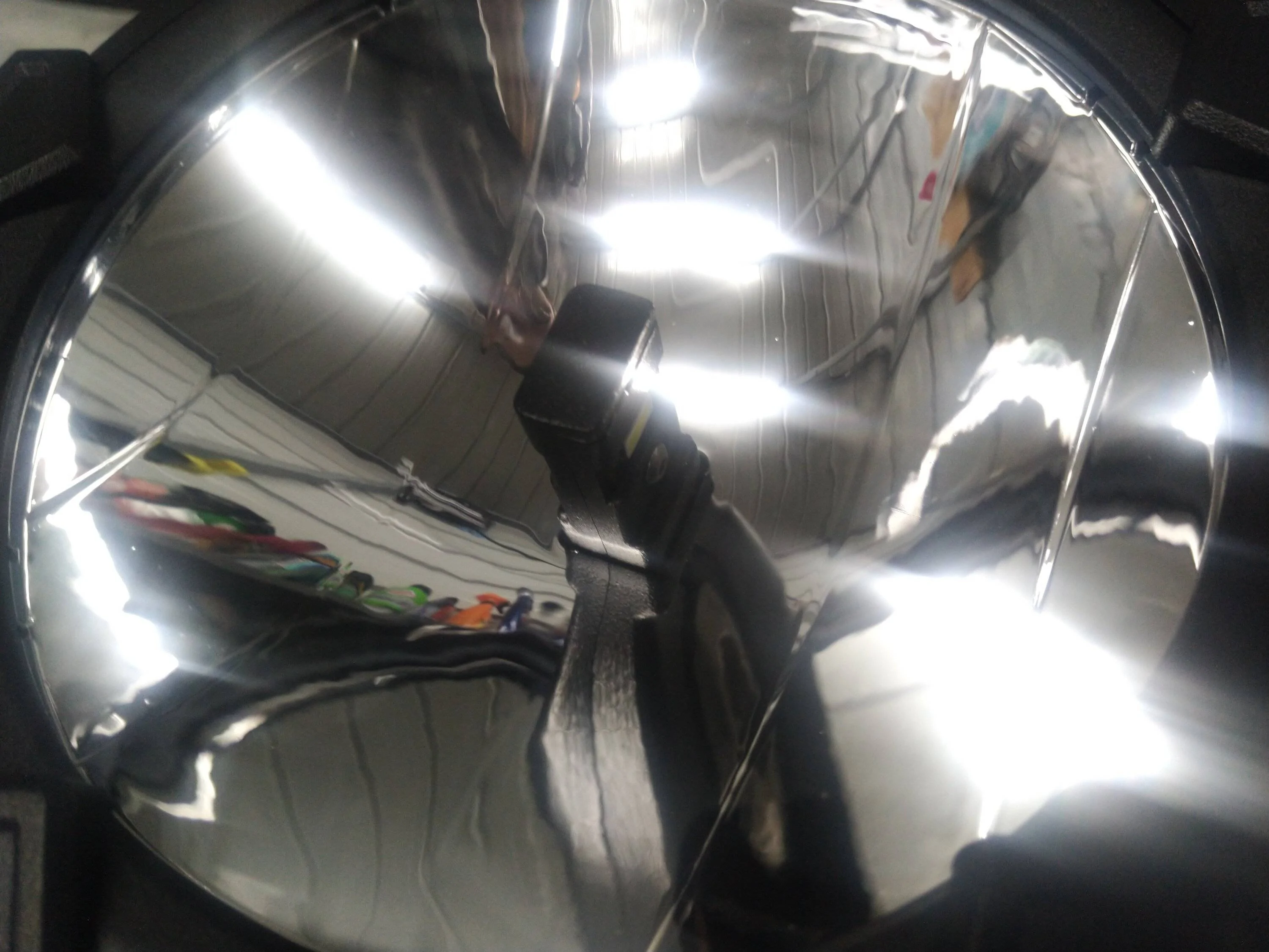

The reflector cup shows no sign of low quality plating. It is a a mirror-like finish. The really really cheap crap you can see the underlying paint where they did not plate the entire cup piece properly.
Ingress of the wiring is similar to my old light bar with a nut and cap design. I have no doubt it is waterproof.

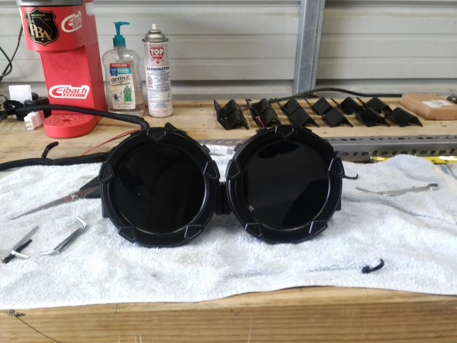

They come with light covers and the design is simple and they lock in place firmly. You are not going to have them fly off. I will give them credit, their method of installing the cover is far more low profile and subtle than being vinyl bagged or over-sized full housing covers (aka hella, kc, etc etc). This may sacrifice strength however, but the only time I run covers is in warmer months, and that is for just keeping bug guts off them, not for anything else. Georgia has no law to cover them when not off-roading.

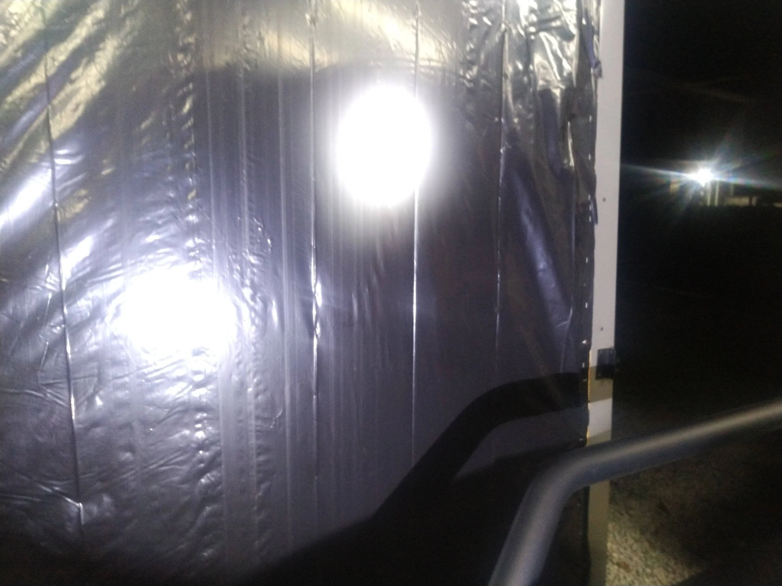

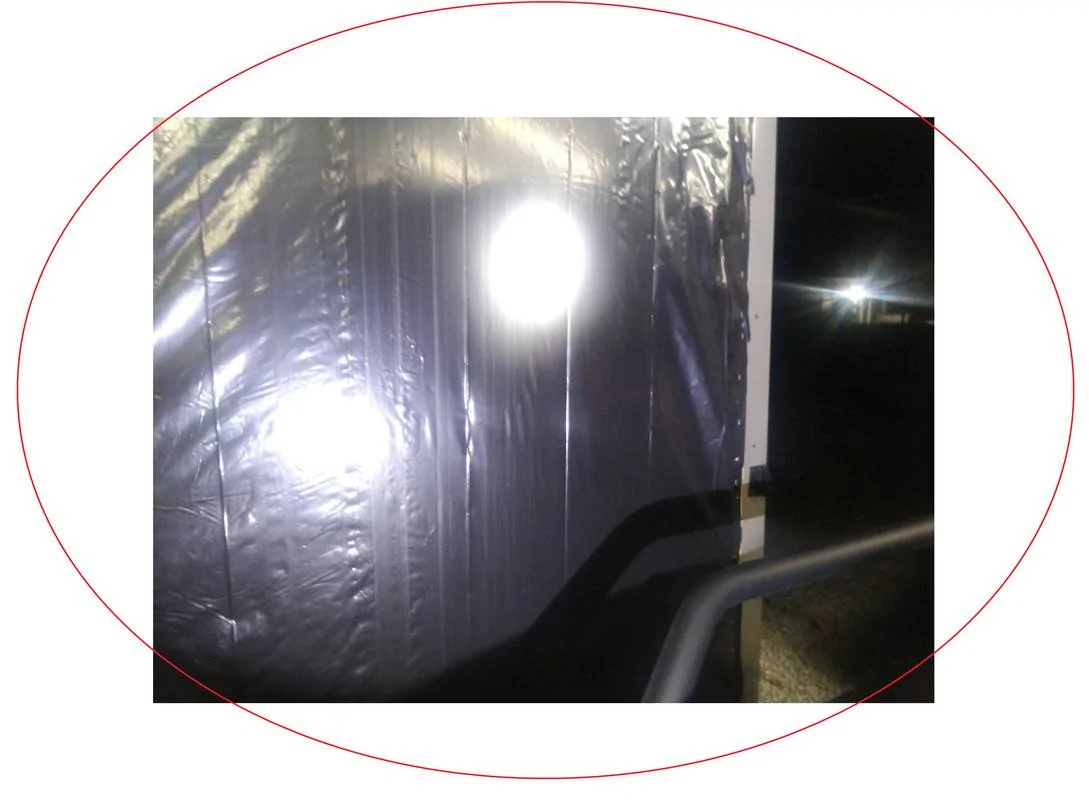

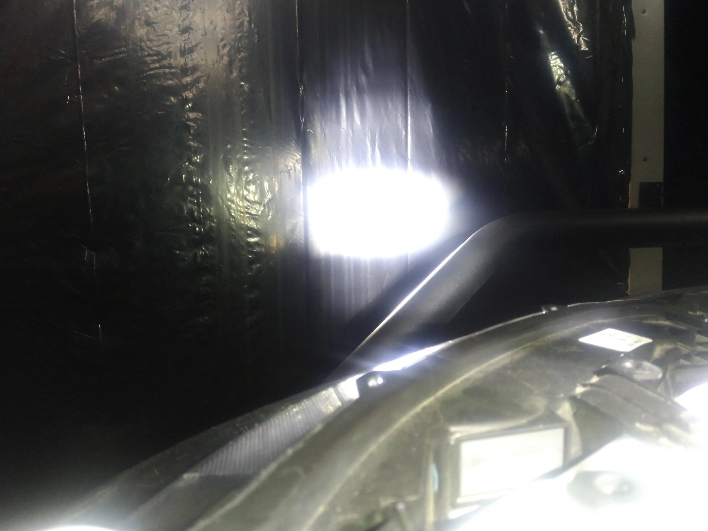

Edit: Photos added to reference spillage (red indicators). Spillage will grow in size as it goes out, but the intensity will also die in equal phases.
The first photo shows one of my 4" spot lights. Very focused center beam, but as you can see the spillage creates another ring with a radius that is larger than the camera can capture. The second photo is the 7" spot light and the spillage are four distinct directions with very subtle ambient spillage. If the 4" spot lights rated spillage at 10, I'd say the 7" is a rated spillage of 3 as a direct comparison of the two. I'd rate the KC as a 1.
As you can see it created an oblong/rectangle pattern instead of being round. You can see by the color the intensity differences, but we are talking 25W vs 40W, so almost double the juice flowing behind the 7". The 4" is a single outward aim'd diode, the 7" is a dual cup facing diodes.

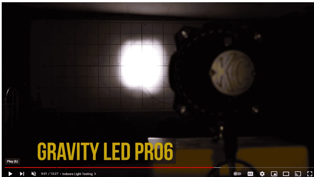

Edit: Found a video and screen capped it. Keep in mind the distance to the wall in this video is probably about 3x from my hood to the garage door. But clearly spillage is less on the KC and its a square shape pattern. I wanted to include a picture of the KC gravity pattern, but not surpringly all I can find on Google images are either instagram photos from KC or their consumers and KC's "data" graph sheets on their own product. If anyone is able to locate a screen shot from a video or a photo of a beam pattern showcase (against a wall like a lot of other companies do...) let me know please. If I can manage to find something I will come back and add it, but they aren't making it easy.
So initial impressions of spending $160 vs $550; Is reducing some spillage really worth another $400 dollars? Also keep in mind the price compounds as the number of them you add grows. It is not looking good for KC in my opinion, but we won't be able to make an informed decision until I get a moment to actually stretch the lights out at reasonable distance.

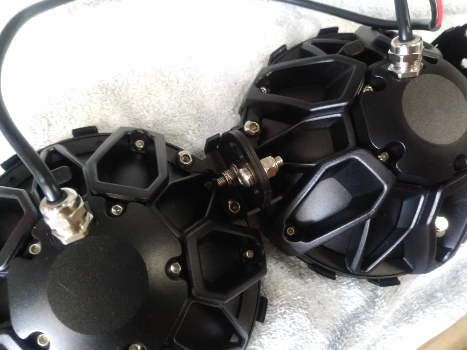

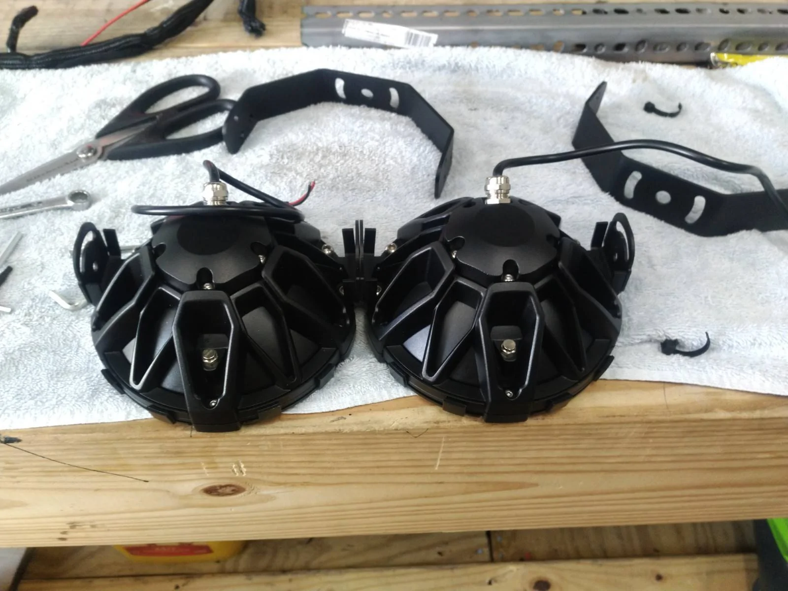

No major updates yet as the other sets were delayed in delivery, so it will probably be next week before we get to see some actual performance tests.
However, I was tinkering with them today and my assumption was right. Not sure if it was intended or not, but you most certainly can hard link these together. More so if you wanted to, the bolts have enough length you could also hard link them with the brackets still installed. So really you could do that, or buy some heavy duty L Brackets (or fab something else up) and just have brackets on the ends.
