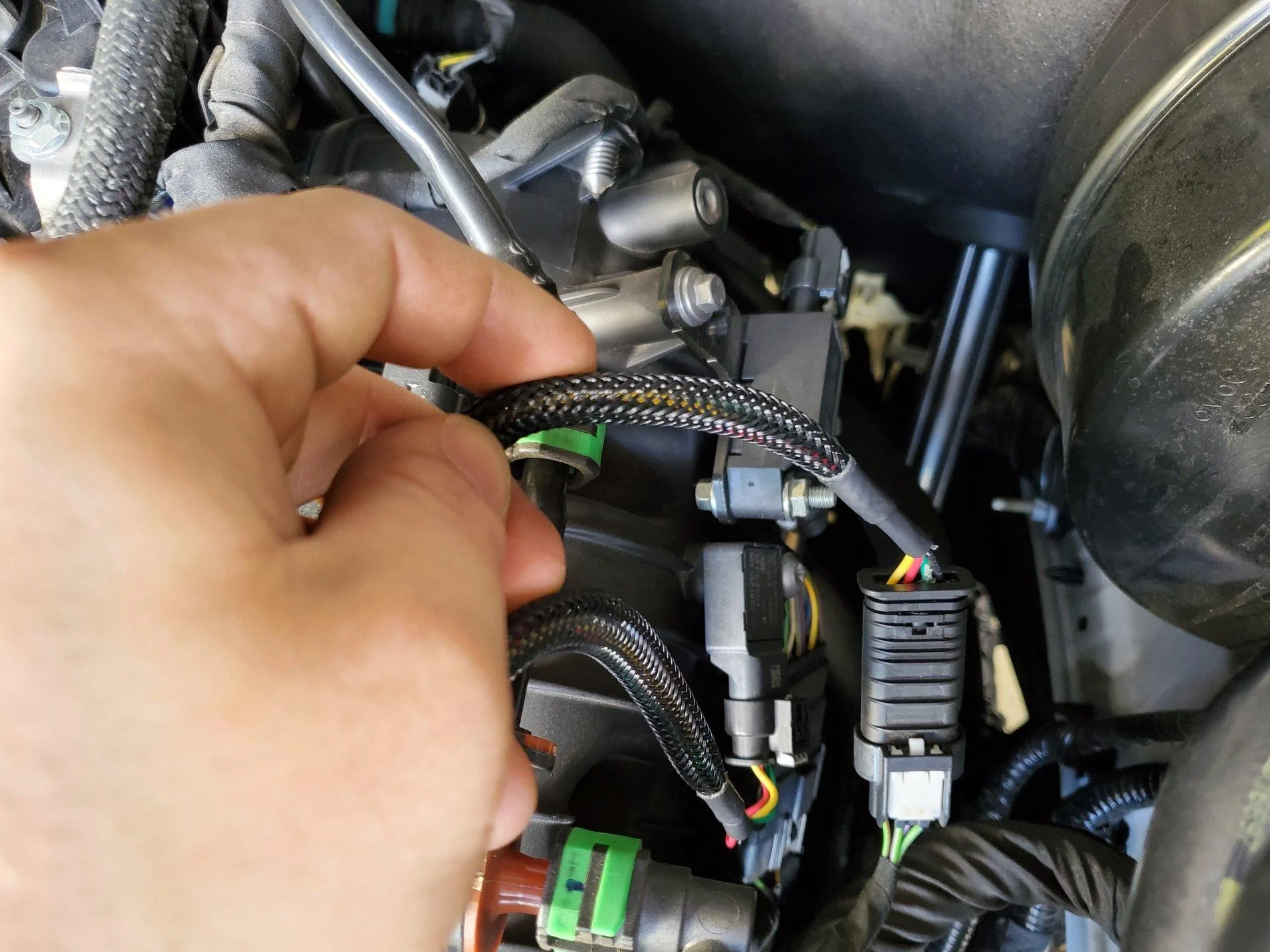

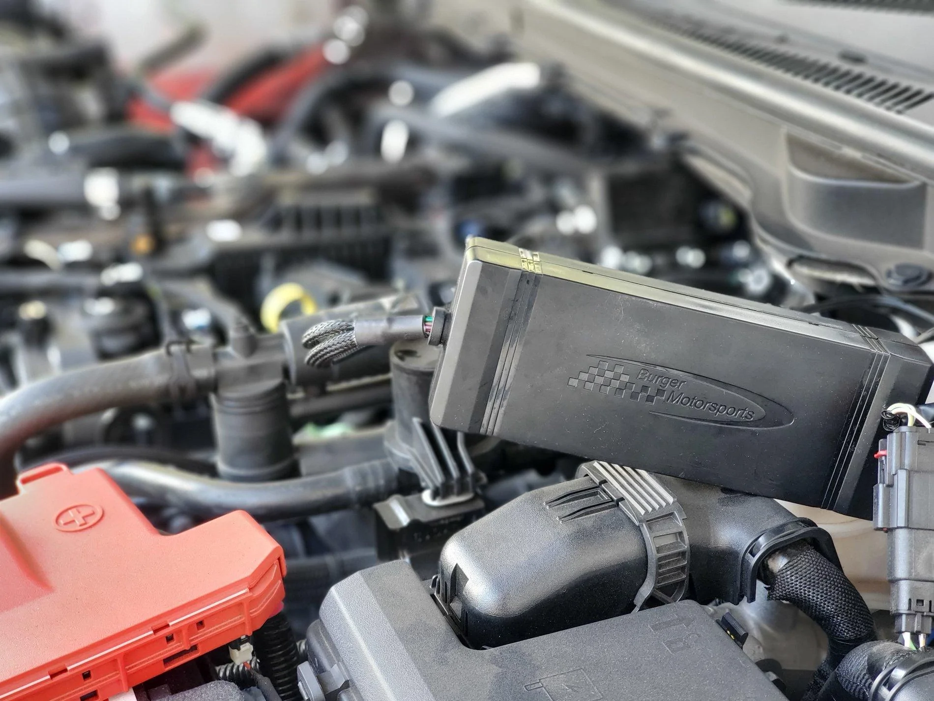

I just recieved a finalized jb4 system today, gunna be sending them logs and fine tuning everything now, how is hptuner?

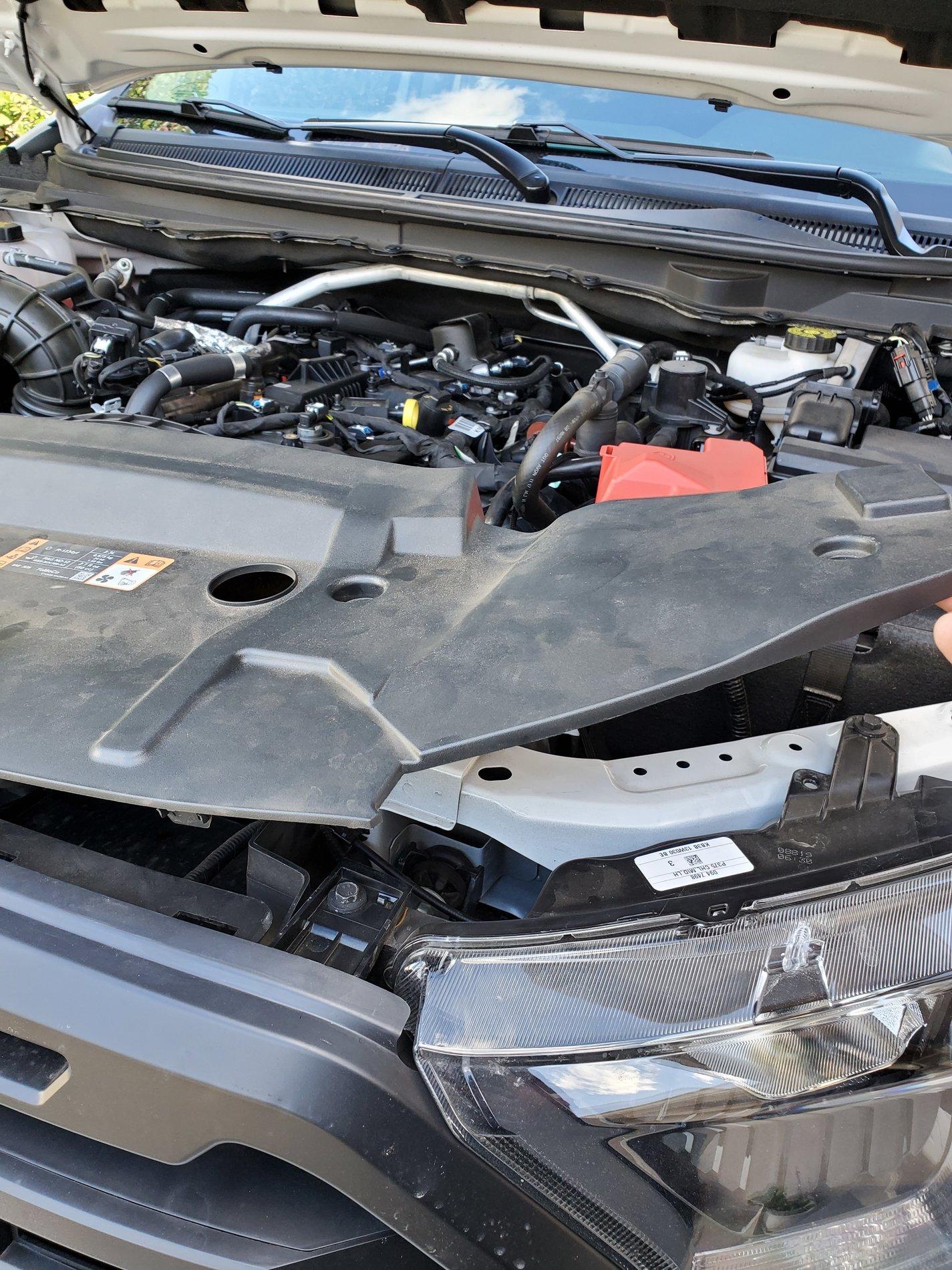

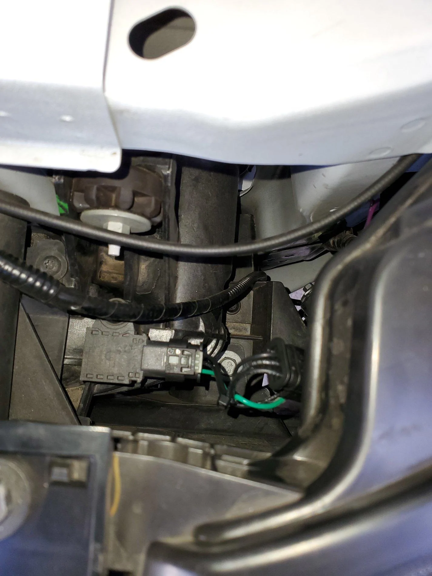

The JB4 is super easy to use and install. I’ve put them on and off, in about 15 minutes each way.
Does your setup have Fuel Control wires too? And are you doing custom mapping through a USB?

OP, is JB4 using your pictures to develop DIY install info? Need an over view showing all hookup points. Step by step helps.

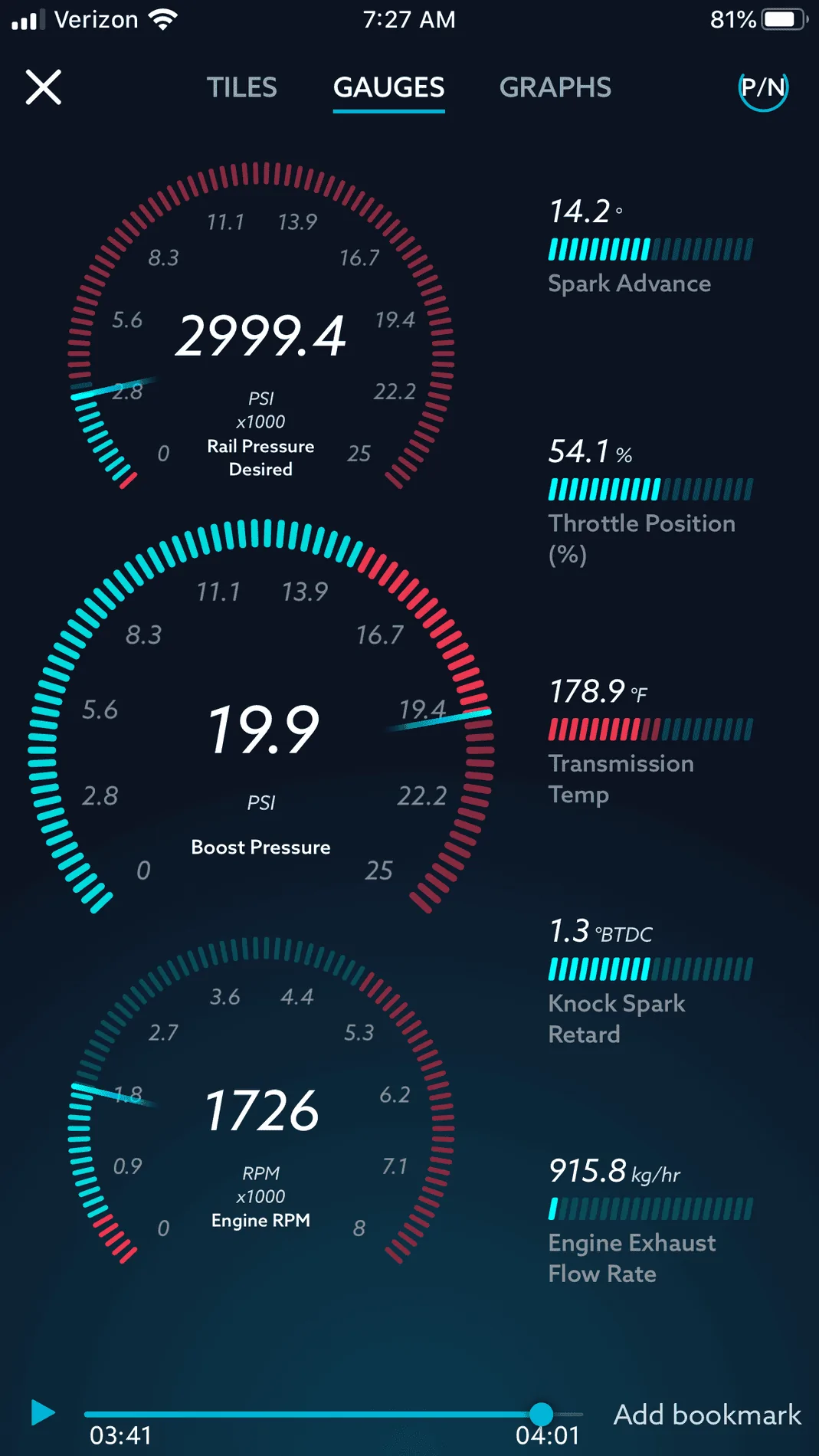

I tend to see 18-19psi on mine in stock configuration. This is on low octane fuel and @ 5,200ft elevation, reading from an auto agent 2. Not trying to disagree, but curious if there is maybe a different PSI sensor that the auto agent is pulling from? I've pulled up MAP and it tends to follow based on atmospheric pressure to match up to 20psi spikes.
