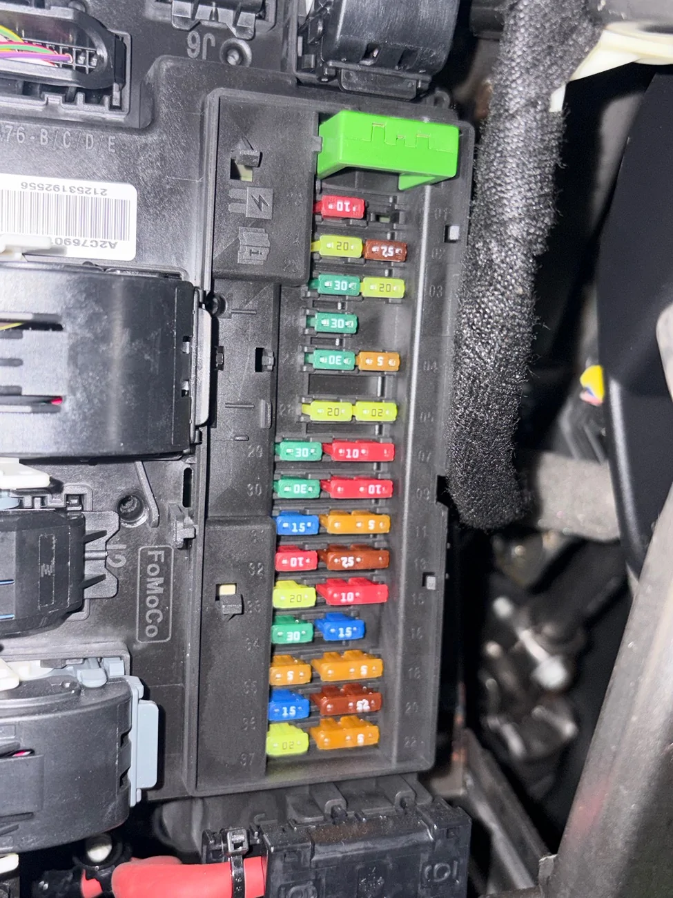

With this not being the normal (loud clicking) sound, it sounds like the actuator is hunting for correct position. Might just need a recalibration.
Pull the FCIM Fuse #12 in the cabin fuse box for a few minutes and then reinstall.
I don’t have one labeled 12. 2021 Lariat
