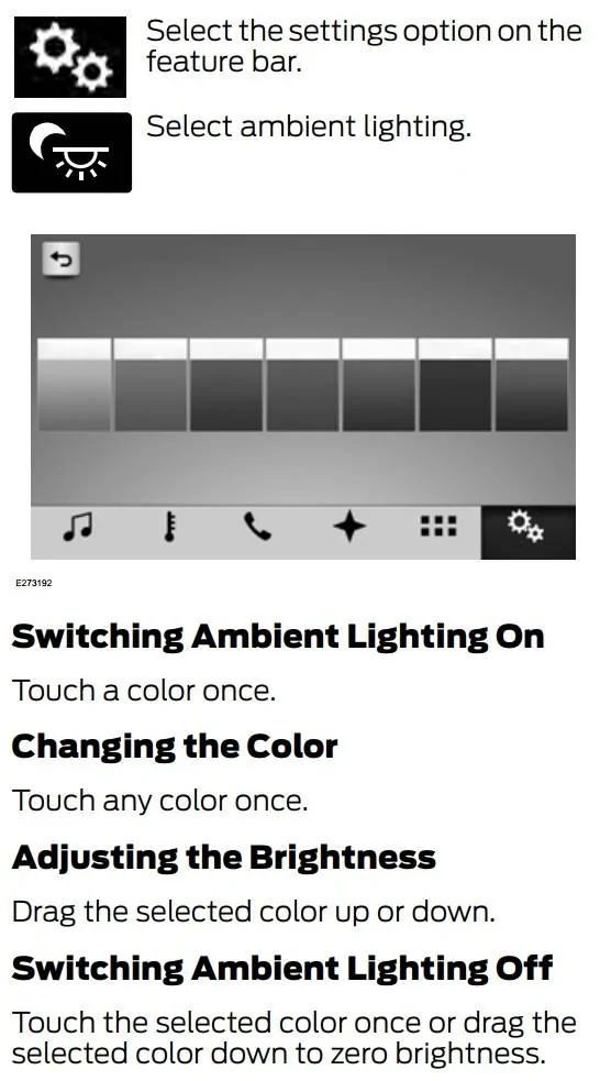

If you have Ambient Lighting...
Oddball
Troy
Oct 23, 2023
79
Toronto
2019 Ranger FX4 Lariat
Yes, I have the lighting on. I may not have been clear; the ambient lights are on in the driver door handle and both footwells, but not the passenger door handle

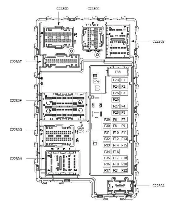

3-Wire Connector C620
Pin 1 - Power (Green / Red)
Pin 2 - LIN Control (Brown)
Pin 3 - Ground (Black / Blue)
Check Voltage - Pin #1 to Ground
Check Voltage - Pin #1 to Pin #3
Should Read 12 Volts or Battery Voltage
Check LIN Control wire (Ohms Scale)
Disconnect BCM Connector (C2280D) Pin # 38 Brown / White
Disconnect Light Connector C620 - Pin 2 (Brown)
Meter Check Wire - Pin 38 to Pin 2
Should be 3 Ohms or Less
If this does not check good, then we need to move to C275
If the wire checks are good replace the LED Tube Assembly
If not, then note where the issue is and we can dig further into the harness
as power and LIN split into separate harness runs
Power is spliced off the (Center) Bin Light, Runs to C225 then to the C620 Connector
LIN Circuit (Control) Is spliced and feeds LF & RF door lights
BCM - C2280D to C275 and splices off to both doors
Note the Pinout (Numbers)
