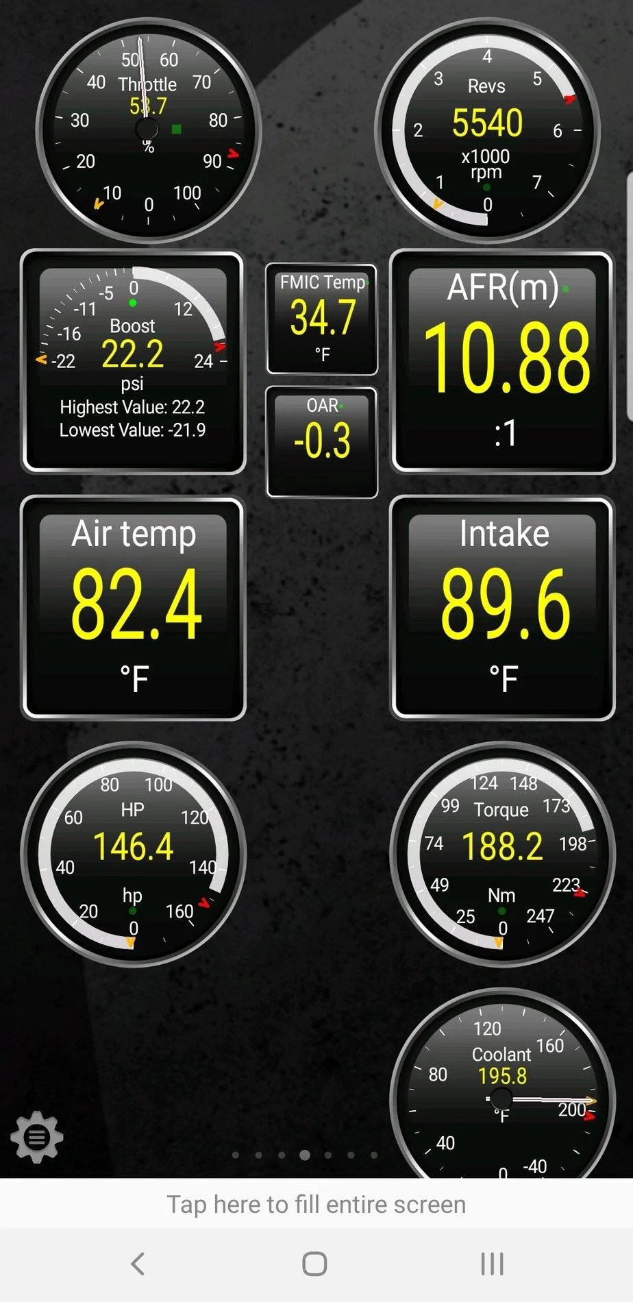

I hit 22psi. Stock. NVM the fmic temp. The Ranger must use a different sensor than the Focus ST I used to have so it doesn't read the same.

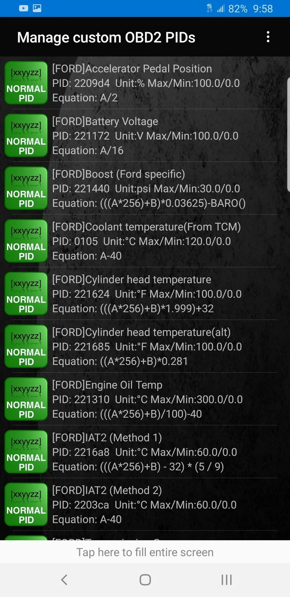

If you can find a working PID for the charge air temperature (intercooler temps) let me know. Mine isn't correct for the Ranger. It worked fine on my old Focus ST so not sure what has changed. And Google isn't helping me at all.

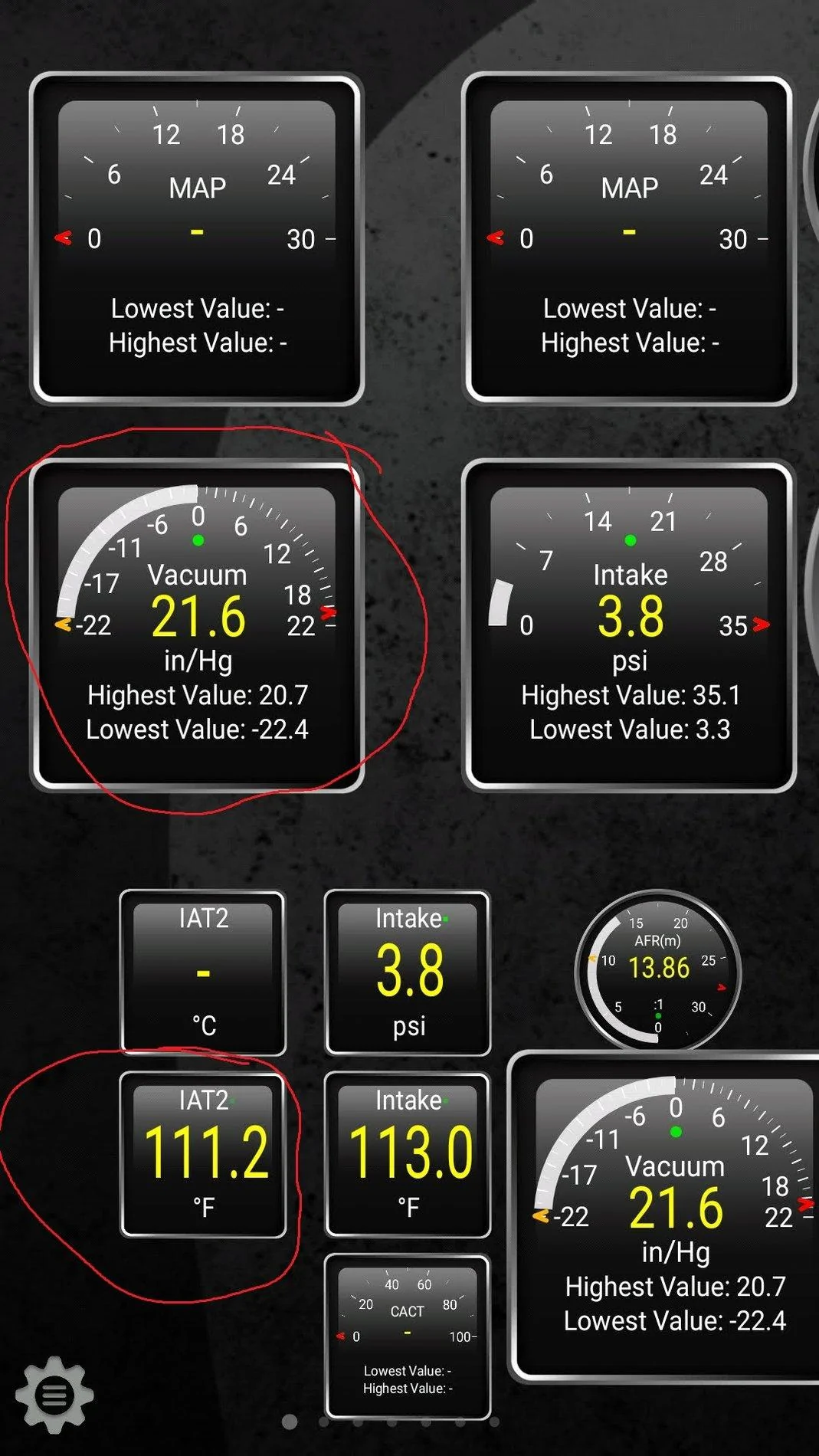

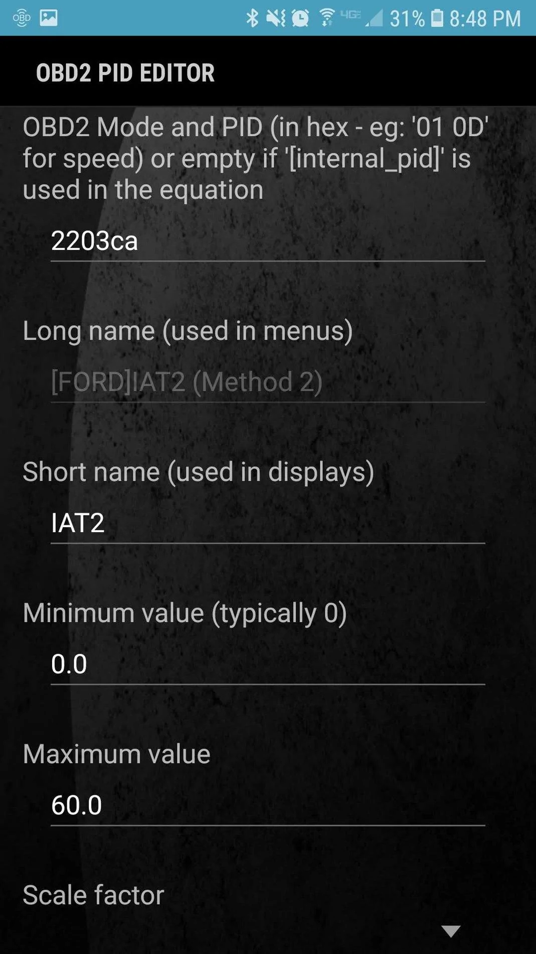

Ok I messed with it a bit after work. From what I can tell the "[FORD]IAT2 (Method 2)" PID is for the charge air temp measured at the intake manifold. So after the turbo and inter-cooler. Seemed to line up with what I would expect and brief research shows some other ecoboost guys using this.

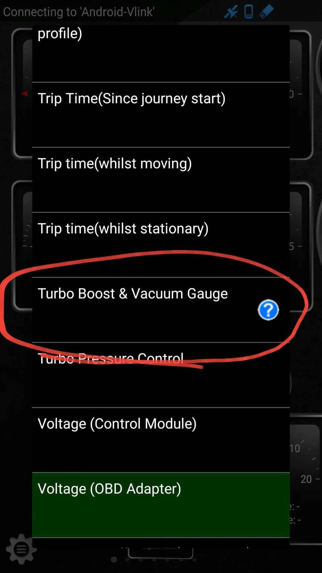

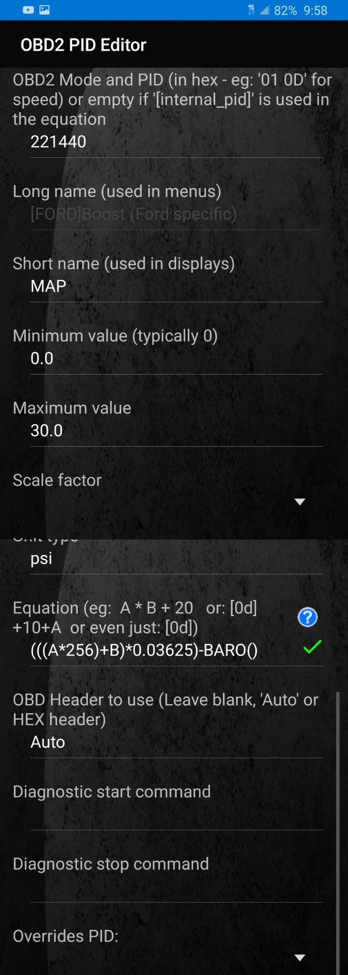

Also the Torque built in "Turbo Boost & Vacuum Gauge" Seemed to be the correct PID for intake pressure that automatically takes out the Barometric pressure. Its what worked best on my truck.
As for peak boost, just messing around on my way home from the gym I saw 21.5psi max. Possible with a pull on an on-ramp or highway 22 or greater should be within reason.
PS ignore the dumb gauge layout, I was just adding a bunch of PID's to check for function.
