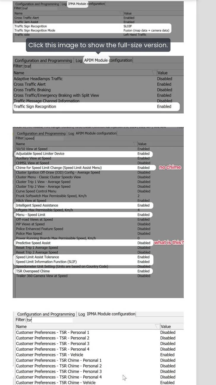

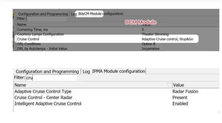

Just going to throw this out here... it sounds like the s/w isn't actually created for the Ranger - which is probably why it isn't sold with it. I realize there are some things you can do in Forscan to change how things work, but then there are other things that you can change in Forscan, but doesn't actually change how the truck works.
The main example that comes to mind on our 5Gs (which run Sync3, not Sync4 - though perhaps you have a MY24+ 6G, which does come with Sync4) is that you can enable the climate screen on the RHS of the Lariat cluster. But you can't actually control anything from it, and it freezes up if you do.
This iACC sounds like the same thing. It has some code there, perhaps at one point it was going to be a feature, but then it was canceled or abandoned or whatever reason pulled from the program, so the code remaining is incomplete because it was never followed through.
