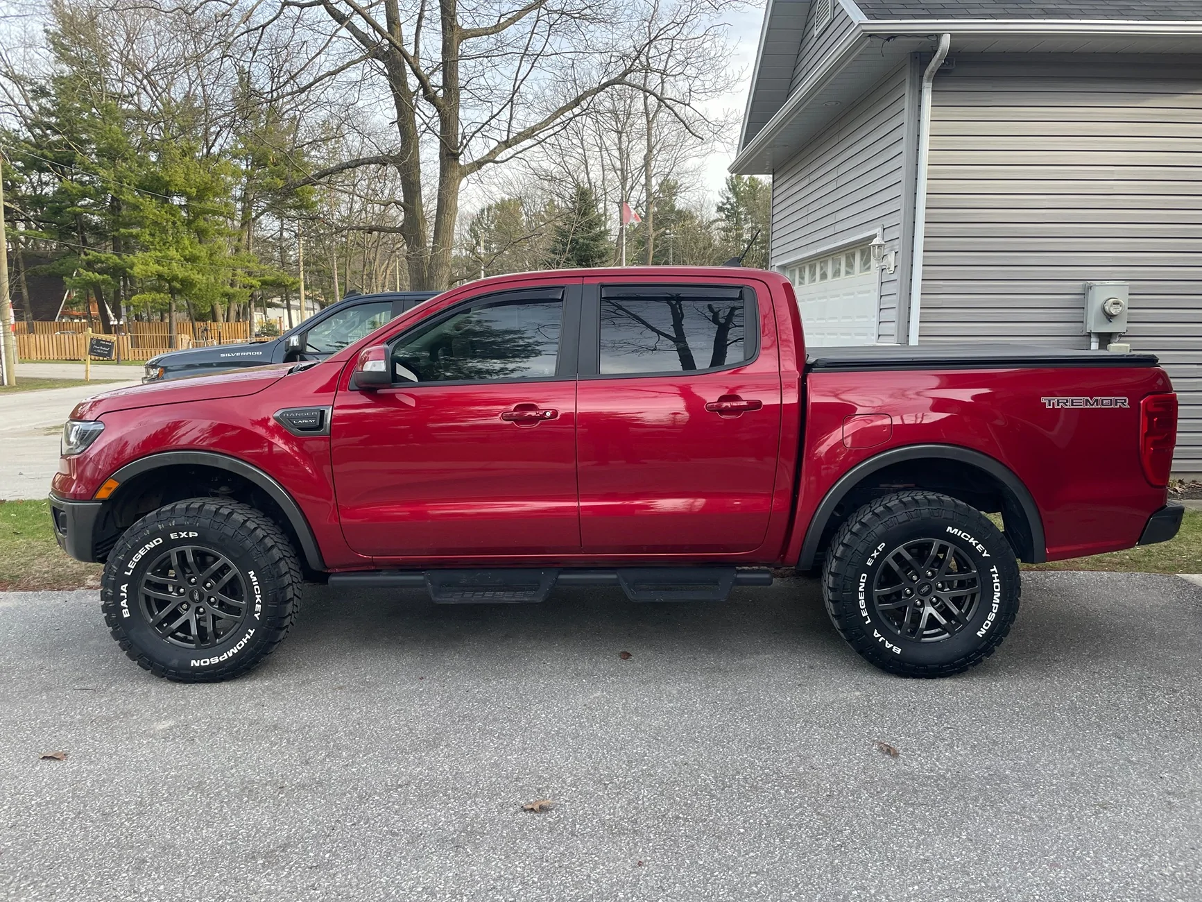

I can confirm that 33x11.5 on stock rims with 1.25” spacer works just fine.
This doesn’t answer your question though. The extra 1” width of the tire might interfere when the steering is turned to full lock. I would measure the remaining space I have for you, unfortunately I have my winters on right now.
If it does work for you, I’m wishing I went with the 12.5” width, as it will look bad a$$!

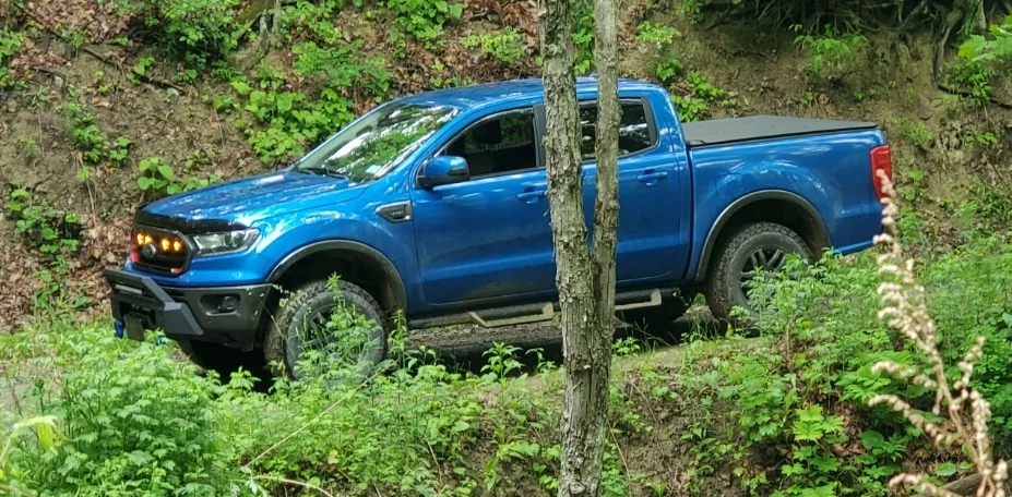

I have no problems with 285/75/17 I think that equals 34s"?
of all things it rubs on the plastic air dam LOL
Roush rims and I have no idea if there is an offset?

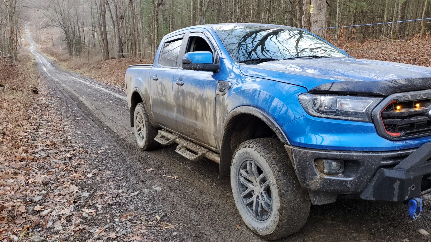

Do you a pic of your truck , going to that tire size and wanted see what it looks like . Thanks
