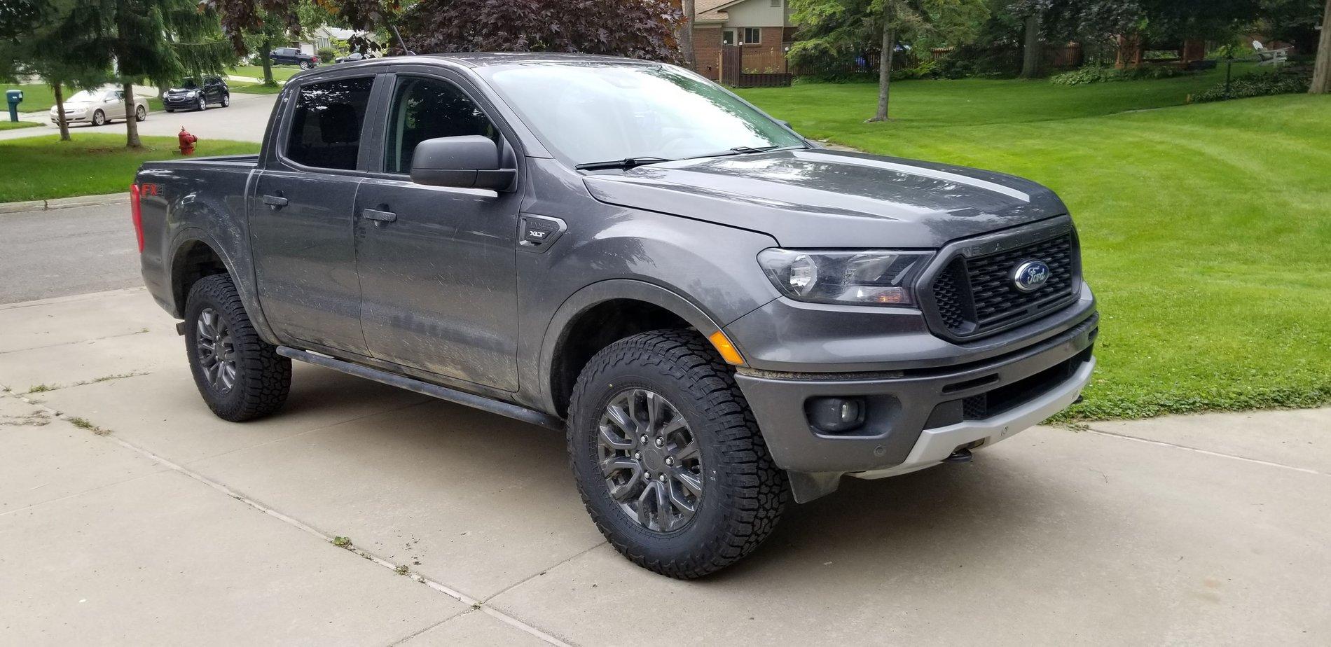

Must have tossed the photo, but here's someone else's w/Falken's
