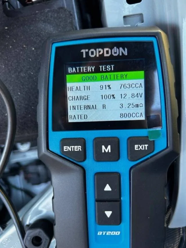

An example of my starting point before adding the Battery Minder.
My Goal is to get 100% Health - Higher CCA and a Lower IR reading.
This result is taken after 13 months of ownership, the readings have maintained since new.
I have zero issues with the battery or functions but want to see if I can get better results when testing.
Proactive / Preventive Maintenance
Thus, install of Battery Minder and raised SOC to 80% (Nov 4, 2023)
Will monitor monthly to see progression towards my goal.
Depending on next check (December) will leave SOC as is or bump to 85% and check again the following month.
My hunch is that 85% is the sweet spot.
What this is doing along with the Battery Minder, is setting the SOC to an optimum level per my driving habits and conditions and keeping the battery health maintained to 100% vs although good battery (result) and no noted decline in health since new 91%
Note my first test Jan 23, (4-Months) ownership resulted in similar result on Battery Health.
Hence my goal to get 100% health on every battery test, as at factory setting 75% it is staying the same and zero improvement and zero decline as well.

It is simple. Drive 300-500 highway mile in one day. Returns all to normal. Really shouldn't be this way.
This is my town car. 10-15 miles a day. I use the van for long drives. Better for sightseeing and has a toilet.
First car in 50+ years I've had to drive a lot or use a charger or maintainer to keep the battery charged.
Ford truly dropped the ball on this one and they will never admit it.
