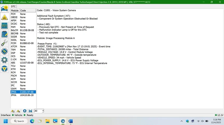

You might want to make sure that the CCM (radar module) is fully seated in its standoff mounts. Mine got bumped and three of the mounting pegs became disconnected and caused the module to slightly tilt. All I did was press in fairly hard on the module to reseat it to its mounting pegs. They just snap in. The warnings went away after that. I was getting a C1001:97 fault code until reseating the CCM module. The code pointed to the camera, but it was actually the CCM (which is connected to the IPMA camera module).
