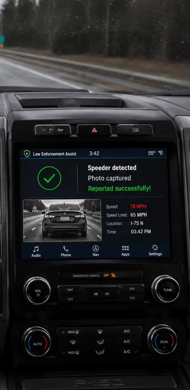

Fords new sync technology that uses your cameras to report speeders directly to police. Automatically takes pictures and sends them in freeing up cops for other things.
Stevedbvik1
Oct 4, 2021
2,856
8,647
2022 Ranger Tremor XLT
Uh , wouldn’t you have to be going 78 also to be that close to get that picture. Would it report both of you?
Probably. This AI and data center stuff needs someone to pay for it.

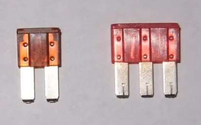

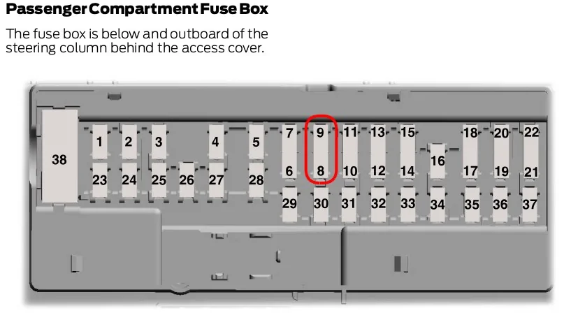

I pulled the Telematics fuse 9 (Driver's side lower dash panel fuse box), added a single 10A fuse in fuse slot 8 for the security horn. The fuse on the right is the original two in one fuse. I installed the 10A single fuse in the left most section of the shared double fuse 8&9 slot.

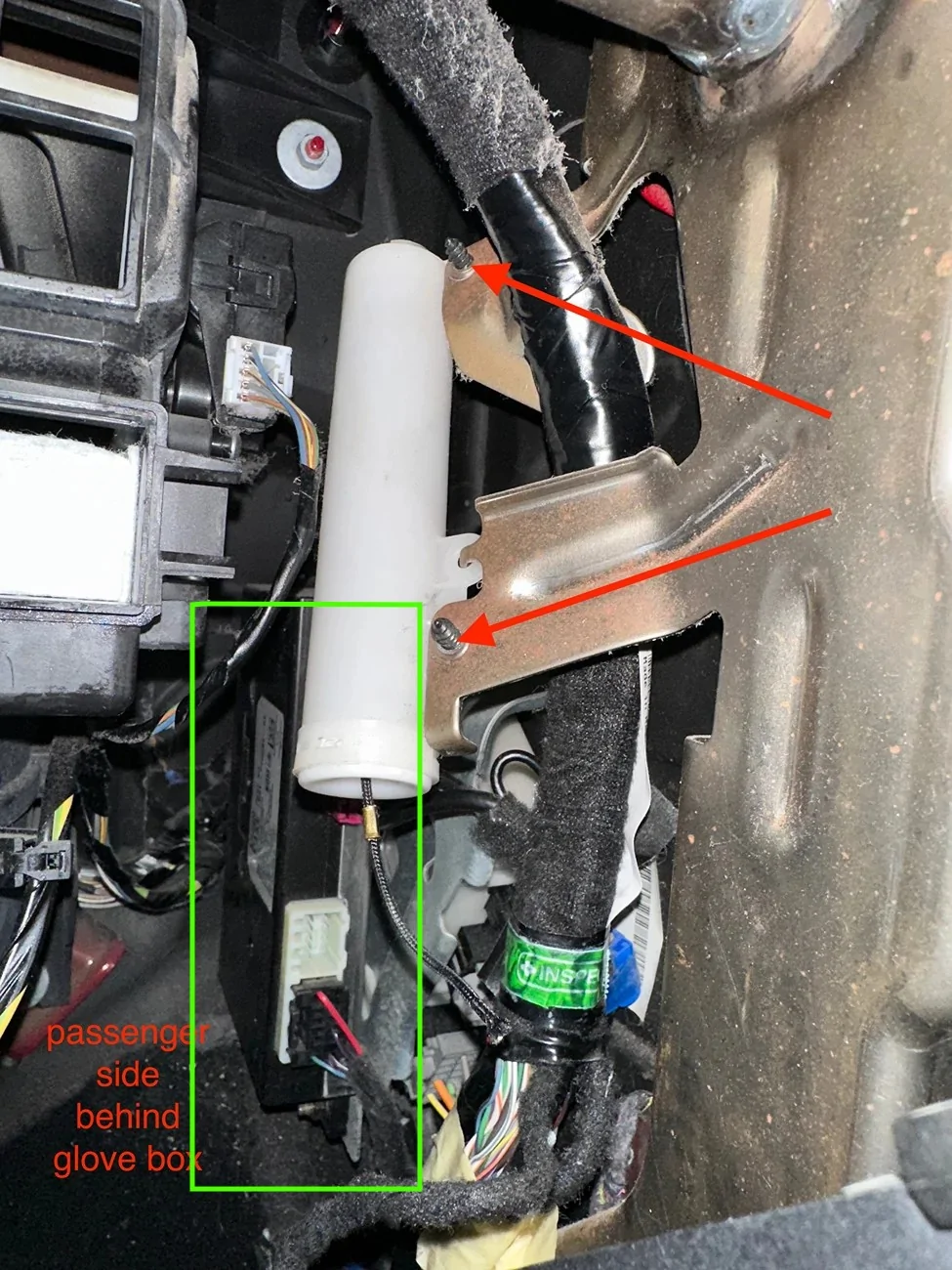

I then unplugged the cellular modem in the passenger foot well (The green box). I didn't even drop the glove box, simply looked up from the foot well and removed the big plug in the white socket. I left the 2 antenna cables plugged in.

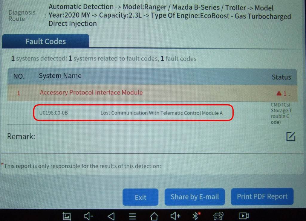

I then hooked up my xTools D8 and scanned for any DTCs. I had one DTC in the APIM area. It reported that there was no communication with the Telematic Control Module A. Just what I was hoping for. No other systems were affected.
So Telematics have been successfully disabled - no calling home to Momma!
It may (maybe not with the Telematics fuse pulled) still collect data, but it is definitely not going to be able to send that data anywhere. The picture below shows the error code with explanation.
