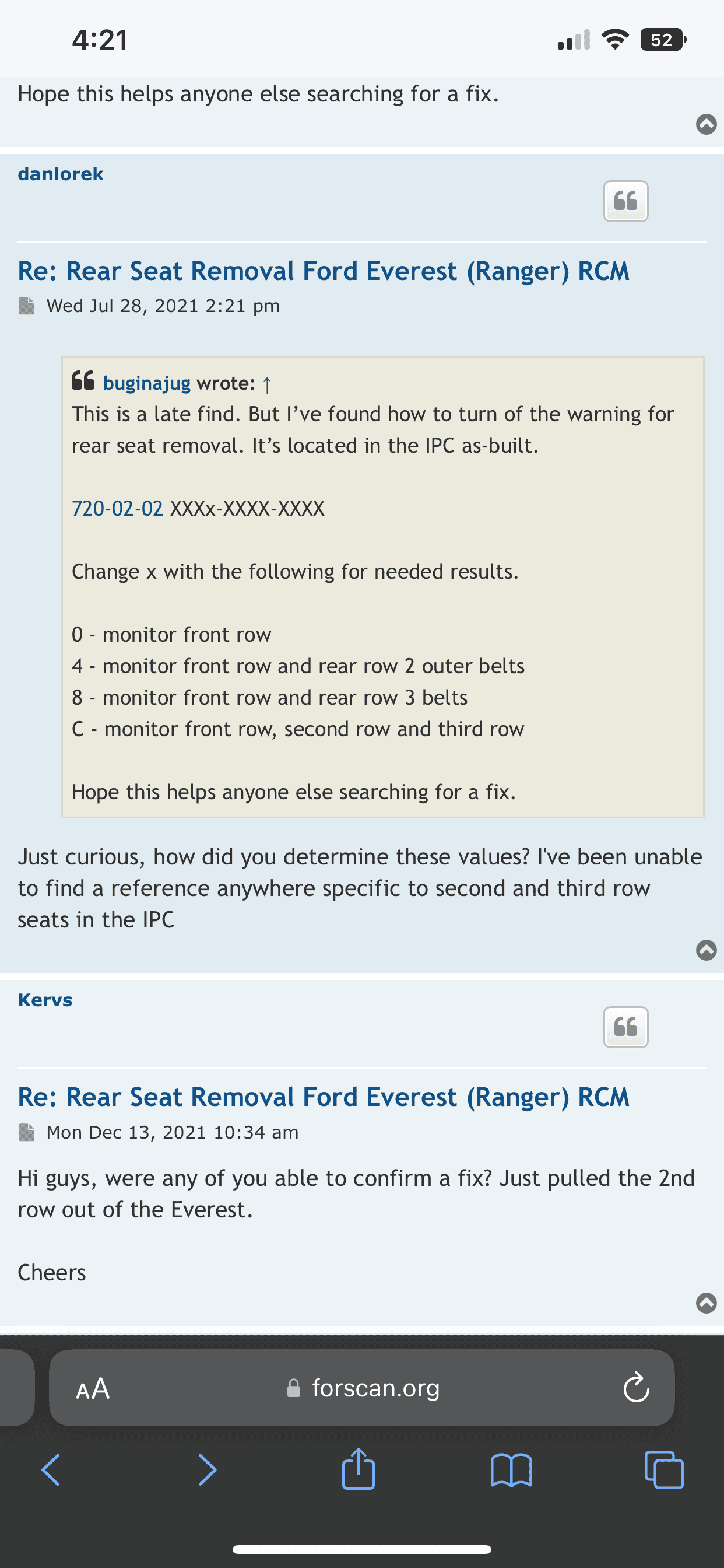

Did you ever figure this out? I’m have the same issue now can’t figure out how to get air bag light off. Was able to get rear seat malfunction off with Forscan in the IPC as built. Not sure if this will help did you ever get airbag light off??? Nothing in the RCM in Forscan helped either.
