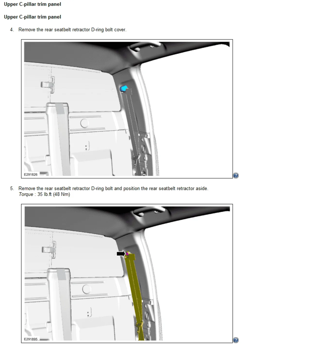

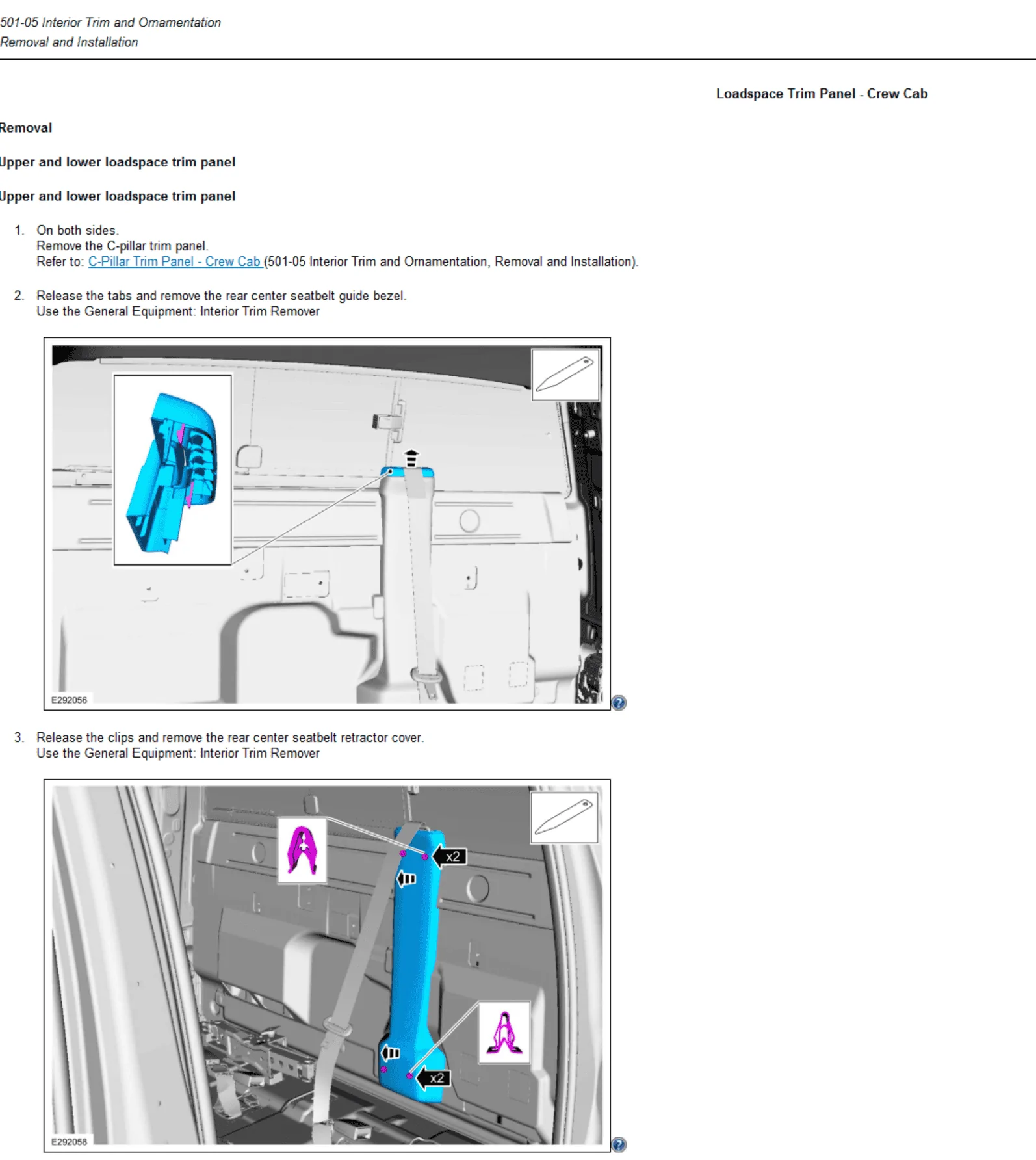

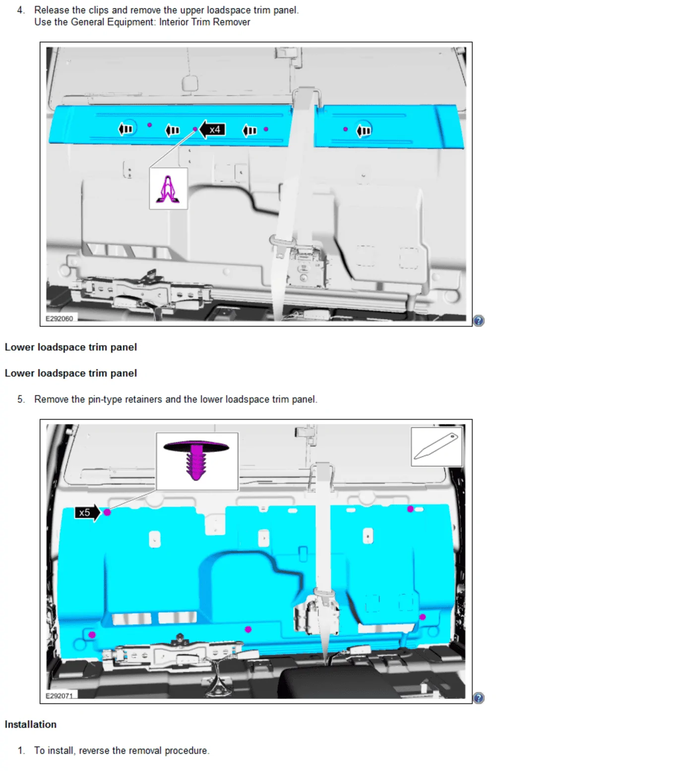

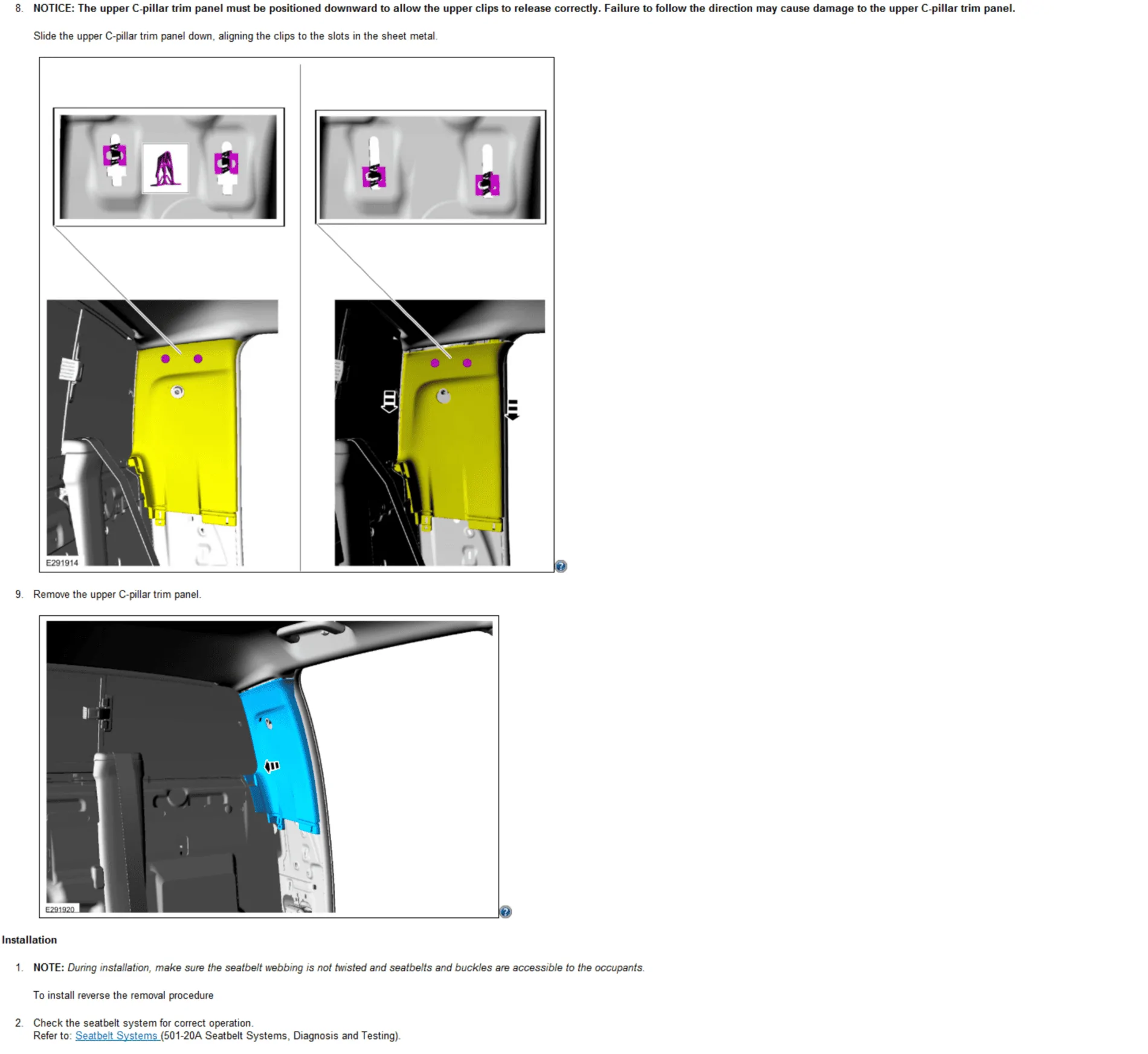

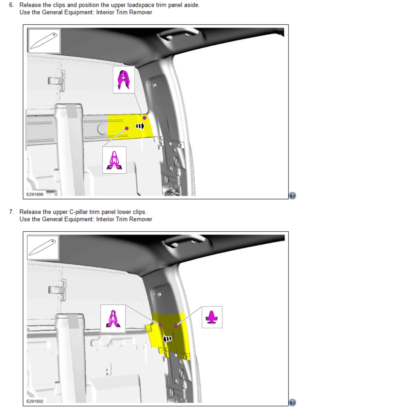

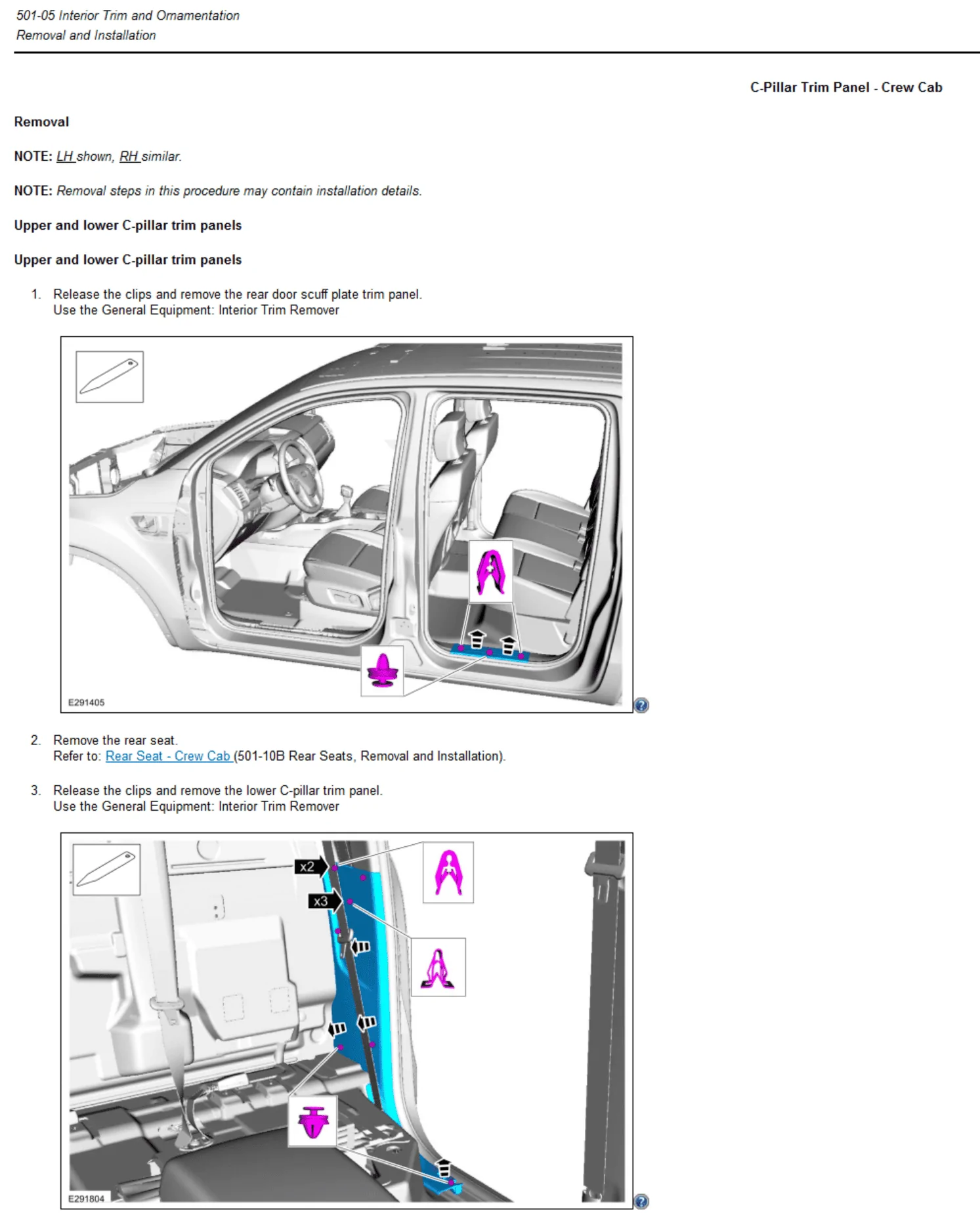

Here's from Service Manual on back panel, do you need to remove the C pillar also?
Awesome. thanks. Can I buy a service manual somewhere?
Those "pin type retainers" are a nightmare to get out. Need a to buy a bag of them as they always seem to be mangled.

The manual is pricey, but as you can see, invaluable too Manual 2019 ranger is where I got mine.

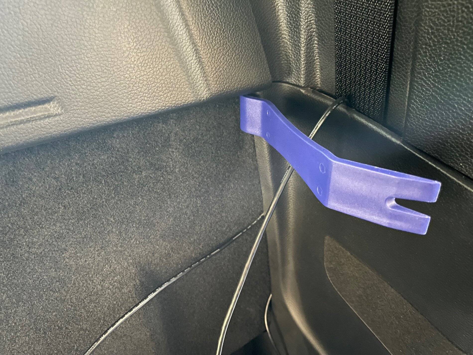

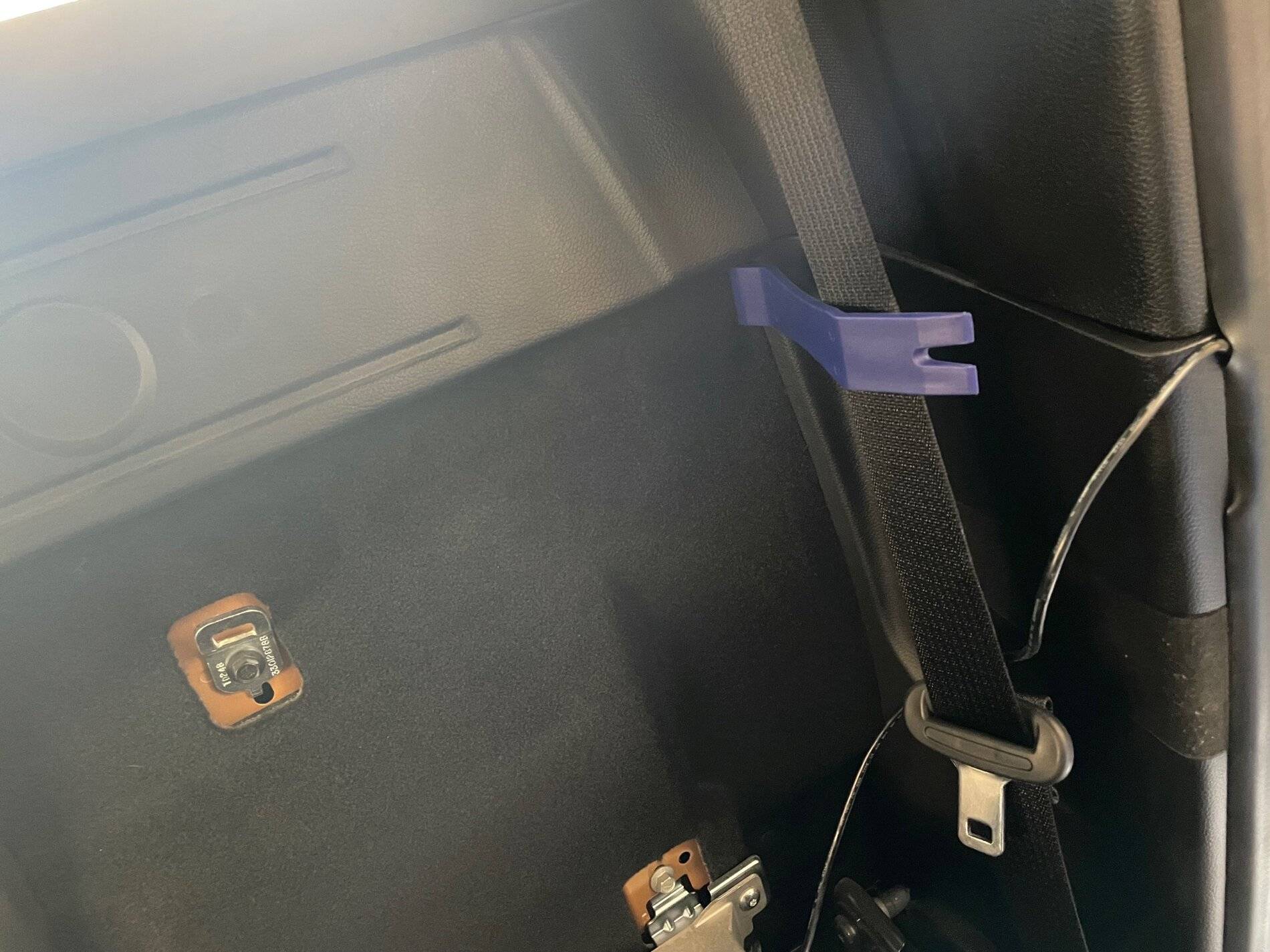

Make sure you get the panel removing tools, I think Dave (@AzScorpion ) mentioned and there is a kit with tools and those retaining pins you can get or just pins.
The blue ones I haven't looked for...yet...as I took everyone's "take it slow and easy" to heart on all the pin stuff.
