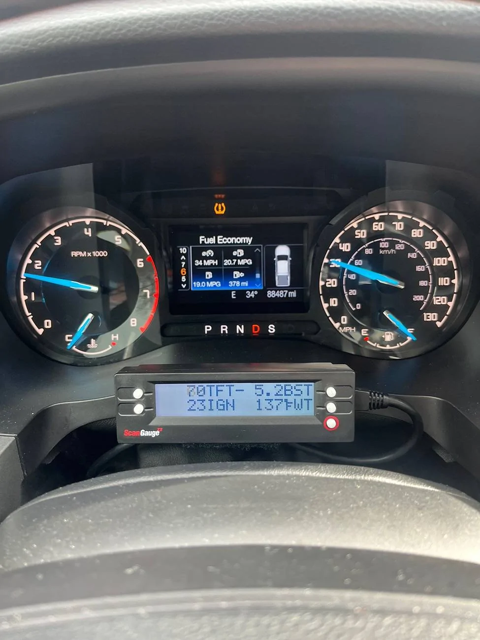

I went for the 2, because of mounting location.
Does it display boost? Curious as I have a FPP Tuner installed.

There are a variety of ways to get the trans temp, but they all boil down to (see what I did there?) needing something that can interact with the OBD port to show you the value of the PID for the trans temp. I have the Livernois tuner, and I'm pretty sure it can show that, but I also have the free Forscan software on a cheap Windows laptop that I can use to do all kinds of things to the truck, including show live readings of any PID I like.
I'd check the ford tuner you have - it likely has a diagnostics/monitoring mode you can use. If not, I recommend forscan.
