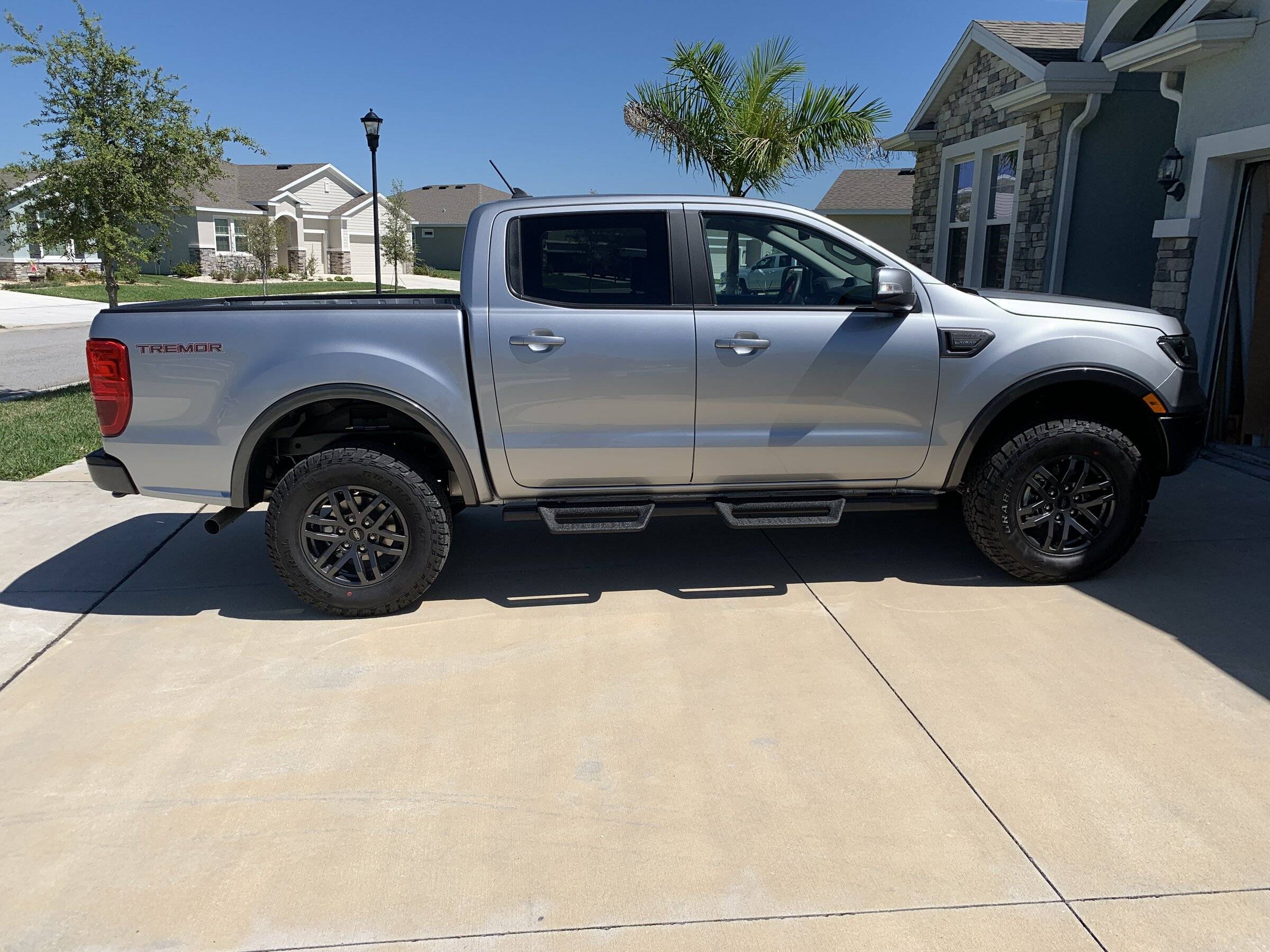

Hi everyone, I just picked up a 22 Silver Lariat 501 Tremor last Saturday. I paid MSRP no markup or dealer fee's Mullnax Ford in Florida.
I love this thing, I added an OEM receiver hitch and wiring, tailgate Damper and Truxedo Sentry CT bed cover, waiting on my bedrug but see ford has it as well for less money. 300 miles on it and can't keep my @$$ out of it :) It rides beautiful and sits right (to me)
I am trying to figure out how to retrofit the rear tow hooks with the class IV receiver, has anyone done this?
also question for Tremor owners with factory Tow package, what is your tong /tow weights?
Thanks!

Welcome, nice looking truck, let the mods begin.
To answer your question about tow ratings. All Rangers with tow package are rated at 7500 towing and 750 tongue weight. More important than these ratings is where you fall into the GCVWR which is the total combined weight of the truck, trailer, and all added mods , cargo and people in the truck. The other important numbers are the axle ratings on the truck. These ratings will be on the sticker on the drivers door. The only way to check these weights is to take your rig to a CAT scale and weigh it. Your tougue should be between 10 and 15 percent of trailer weight and can eat up close to half of your trucks total availablle payload.

Welcome! Great looking Tremor. I picked up my 22 Tremor xlt about a month ago. Awesome little truck!

Hello and welcome! I'm new here as well. You got a nice looking truck. Just like you I absolutely love driving mine ♥
