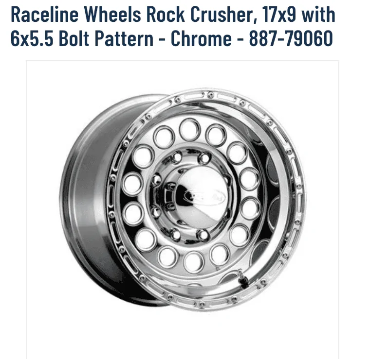

Just gonna ask you guys, can't find good help locally. This is what I want, what do I need,(spacers, rings) to get these Rims and tires on my Ranger asap? I don't want any poke if possible.
Got the 3 1/2" lift and Fabtechs intrusion bars on the way. 17" rims.

Those wheels have 0 offset (according to that part number) so they will stick out a bit.
Search the site here as there are many running that size tire with 17x9 zero offset rims. You can get a good idea of what it will look like.
And I highly recommend getting the hub-centric centering rings.
I had my wheels on for 5000 miles and always dealt with a steering wheel shudder when transitioning through 60-65 mph.
Finally spent the $20 (in twelve easy monthly payments!) for the set of centering rings and the shudder is basically gone.

I just posted that pic for the look of the rims I want. I'll have to ck to see if they're available in different offsets.

For reference, my wheels are 17x9 with a +20 offset and 265/70/17 tires and the edge of my tread lines up almost perfectly with the edge of my fenders.
Edit: Looking at the Raceline page for that wheel, it is only available in Zero offset.

Well that sucks. I don't like the spoked rims "everyone" is selling, and I want to go chrome. I guess, I'll have to keep looking.

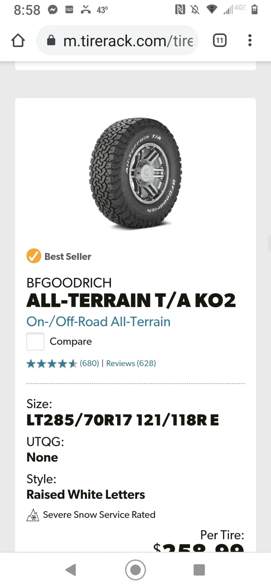

Those tires will give you the look you want, but at the cost of ride. Someone else just posted that they're not happy with them after a few hundred miles.
Do you know where? I'm looking for sidewall strength. The Duratracs won't cut it

Got it. Checked it out. If I stick with the C rated tires I should be good. I'm still going with them because of the amount off roading I do. Literally every week.

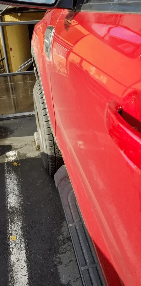

also for scale, I'm at +20 offset and I barely poke. This is I think the lower minimum. I bet at +25mm I wouldn't have any poke at all, it's really close. Anything lower will result in poke - hence my +20mm pictured here
the above ones you posted at 0 offset will poke further, or the most common upper max ones mounted by guys like @jakelife at -12 will poke further still.

Excellent free advice. Thank you. I've put the rims on hold for now. I just can't find any I like. I guess I'm old cuz everything I like is called "retro", and any rims I do like the offset is as always 0 or -12mm or more. Screw it. Got the tires coming. Im just gonna stick with the stock rims for now.
