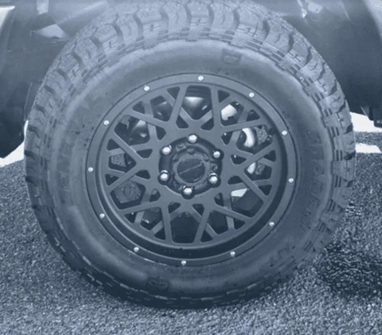

Is that not what normally comes on these? As mentioned new to all this. This was completely stock when I saw it at dealership.
They're Fuel wheels. Not sure if that's a Roush add-on or what but it's definitely not factory.

They've got aftermarket wheels on there with probably a lower offset than factory. It's gonna rub the crash bars with that much tire.
Have someone turn lock to lock with the truck running. You'll see where it's rubbing pretty quick.

At the very least, it's the wrong wheels and tires for a Roush. It should still have interior, intake, exhaust.
Can you post more pictures? Below is the link of what the Roush on what you should have. It also states that its about 13K over vehicle price

I'm a Ford Roush Performance Dealer in Canada and I can tell you right away that the Fuel Rim is not included in the Rosch Package. I'd be curious to see your bill of sale and see what items were on it. Reach out to me if you need help with that.
  • Includes
    • ROUSH Grille with Dual LED Light Bars
    • Custom Fender Vent Badges
    • Dual Tip Performance Cat Back Exhaust System
    • 2.0 Off-Road Performance Suspension System
    • Satin Black 18” ROUSH Wheels
    • 32-Inch General Tire Grabber ATX Tires
    • Premium Interior Leather
    • Magnetic Gray Fender Flares with Integrated Accent Lighting
    • Custom Red Tow Hooks
    • ROUSH Floor Liners by WeatherTech
    • Serialized Interior Badge
    • ROUSH Key Fobs
    • Certificate of Authenticity
    • Standard Graphics Package

Very nice truck nonetheless. If the dealership won’t help then I would recommend getting a “skinnier” tire. Do you know what crash bars are, if so have those been modified?

Sounds like dealership fu**ed me. Awesome. I was told this was the Roush package … what the AF.
I mean it’s an amazing truck. It appears the only difference is wheels and tires which is easily replaceable.

That’s what’s on the truck now … says 32” ..
however - it’s only when it s a very tight turn or u turn: that’s when the rubbing occurs. Nothing else. Basic turns either direction are perfect.
As other have stated. Definitely not Roush wheels and tires.
You should drive it up there and speak with your salesman/salesmanager.
The Fuels are nice wheels. But at a minimum they owe you the proper size tires
This is not a service problem. It's a sales problem.
305s are way to wide for that wheel on a leveled Ranger. It'll look better with the proper sized tires as well.
