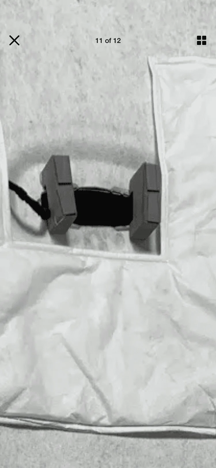

Going to pop out my dome light tomorrow to see if those gray blocks are there. I doubt they are.
As for magnets this is a pic from f150 I found on eBay. You can see the support with what appears to be magnets on the top. I wonder if the Ranger gray blocks have magnets on them as well.

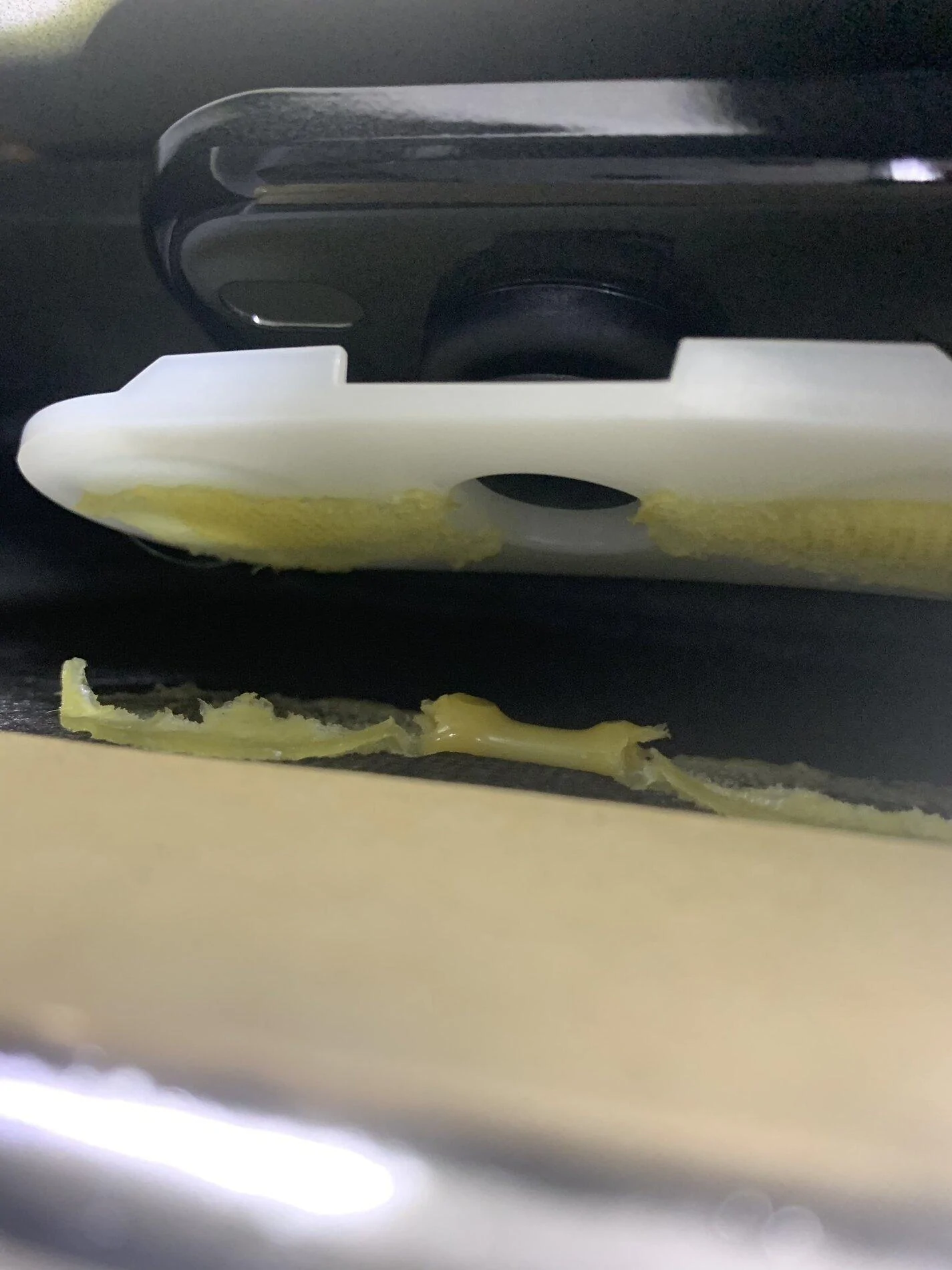

So I am not losing my mind. Check this out. Removed the dome light and stuck my phone up there and took a pic. The attachment mount is ripped off the headliner. The gray foam isn’t attached to the roof. It’s just a spacer block. This attachment holds it up. Now to fight with the dealer on fixing it.

since you're already in there.....glue it and be done with it.
I have to go back to the dealer for another issue (seatbelt bucket getting replaced) so will use this as a teaching moment for them since they don't know there is an attachment point there. They need to make it right.
