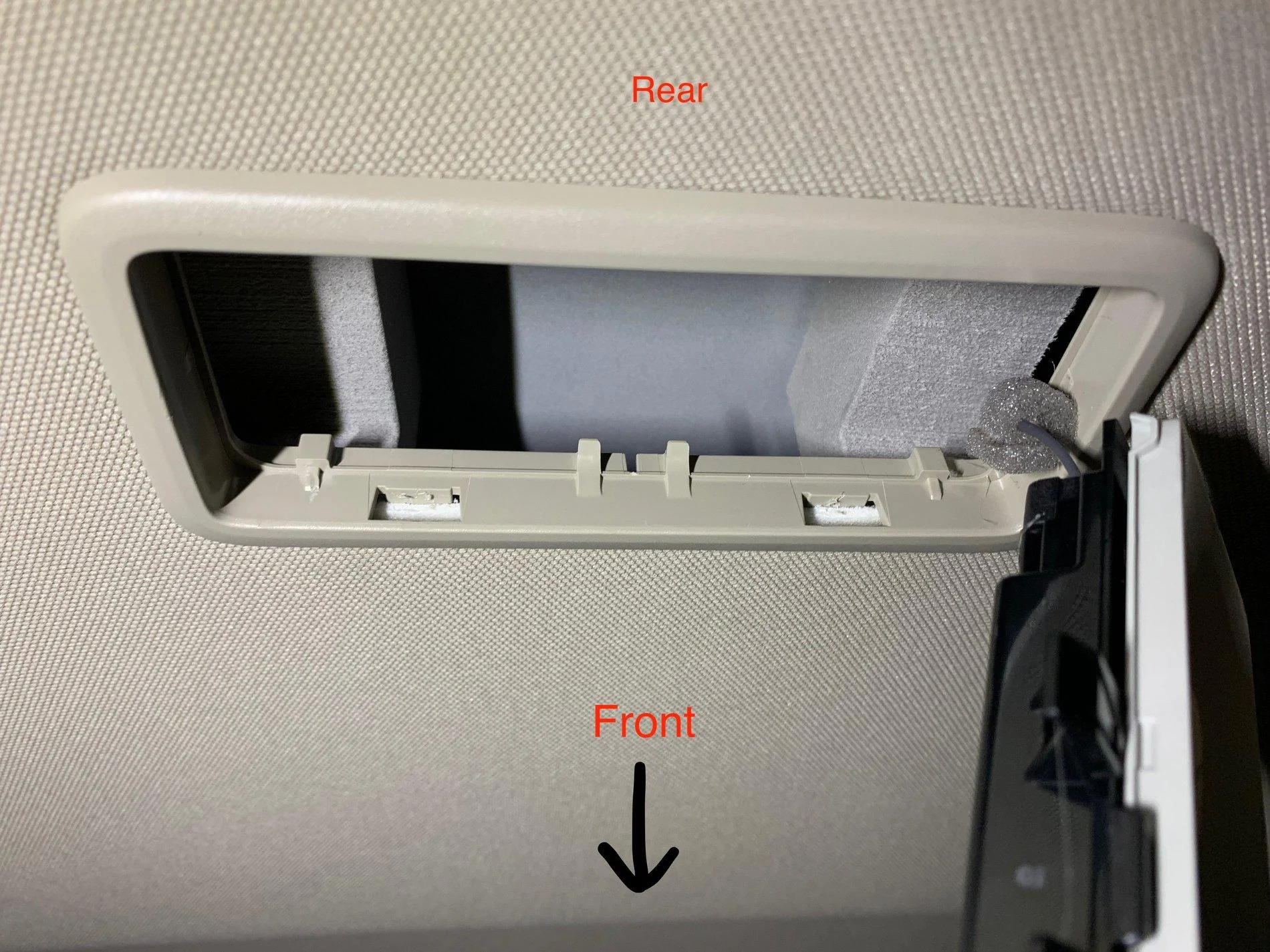

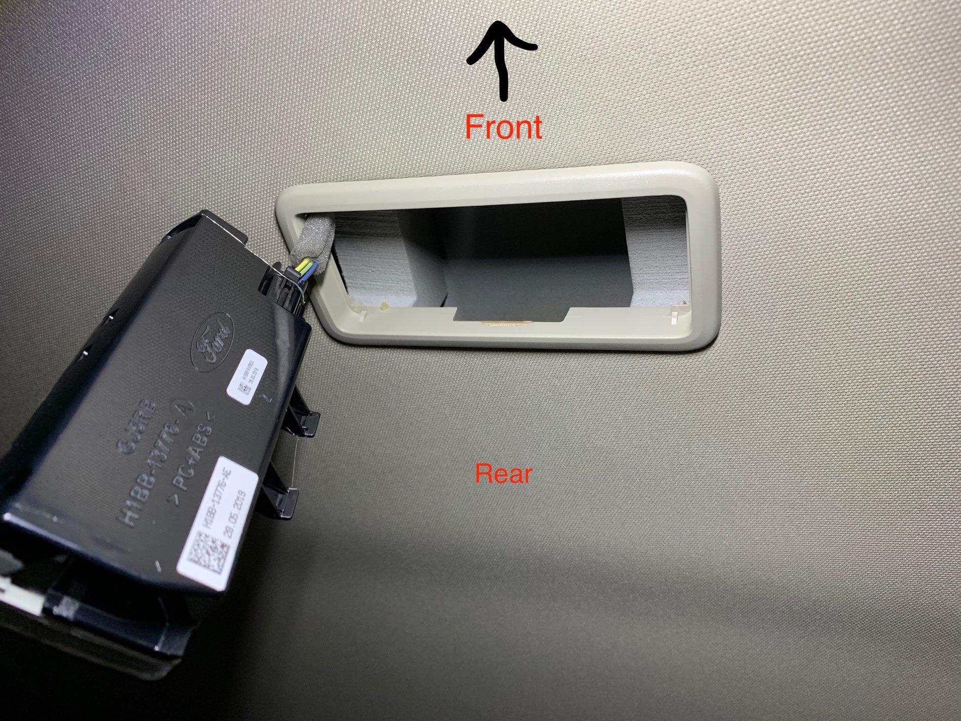

I can take some pics to show how it is clipped in. Its just a matter of releasing the clips just right and pulling it down. Then right behind the dome light is a strong magnet that's attached to the headliner, which holds it up to the metal roof.

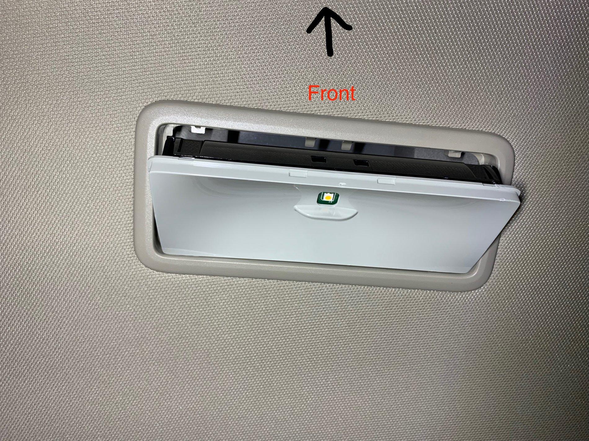

So, removing the dome light is very easy once you know exactly where the clips are located. All you'll need is either a small flat head screwdriver or a plastic trim removal tool. Slide it up in between the dome light and the trim on the front side, and pop it loose. You can see in the pics where the retaining clips are. The dome light diffuser doesn't need to be removed, which I figured out after getting the whole assembly loose. The trim piece stays attached to the head liner.
