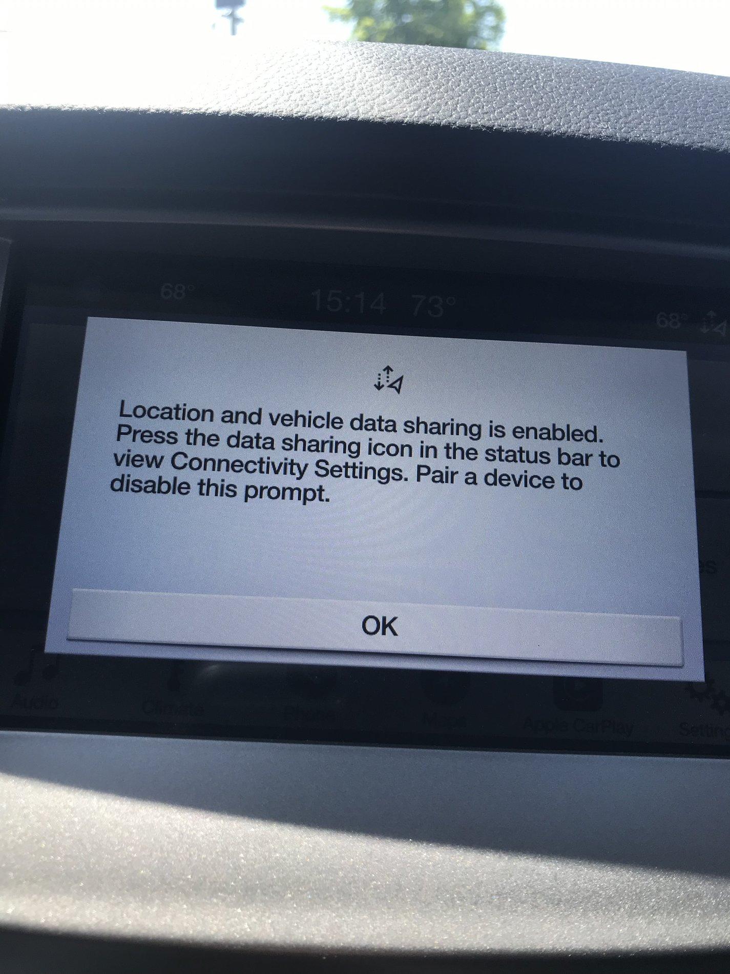

I'm now getting a pop-up about syncing a device. My phone is synced and I connect it via USB. Not sure after attempting to do whatever it is asking me to do.
What build # did you update to?
UofMEngineer
Apr 19, 2019
516
334
20' Escape Hybrid,18' Fusion Hybrid
Showing “19052_PRODUCT”
Probably that data services one then. Usually pairing the phone and accepting once gets rid of it. A couple others have also said they keep seeing this one at random too. Not sure why though.
Here is the message I’m getting. Going to unpair my phone this evening and see if that gets rid of it.
MSG W
Kirk
May 7, 2019
264
231
Missouri
2019 Ford Ranger Lariat everything on it but Chrome Package
My phone is paired and I get that one but not all the time
UofMEngineer
Apr 19, 2019
516
334
IIRC the times I noticed it were when I'd swap phones. So my wife would drive one day, then I'd jump in the next and it'd hook to my phone instead and the pop the pop-up. Do you use CarPlay? Might be because that disables the Bluetooth connection, or some timing thing. I don't recall seeing this very often at all in 3.4, so maybe there are some improvements baked in there when it becomes available.
