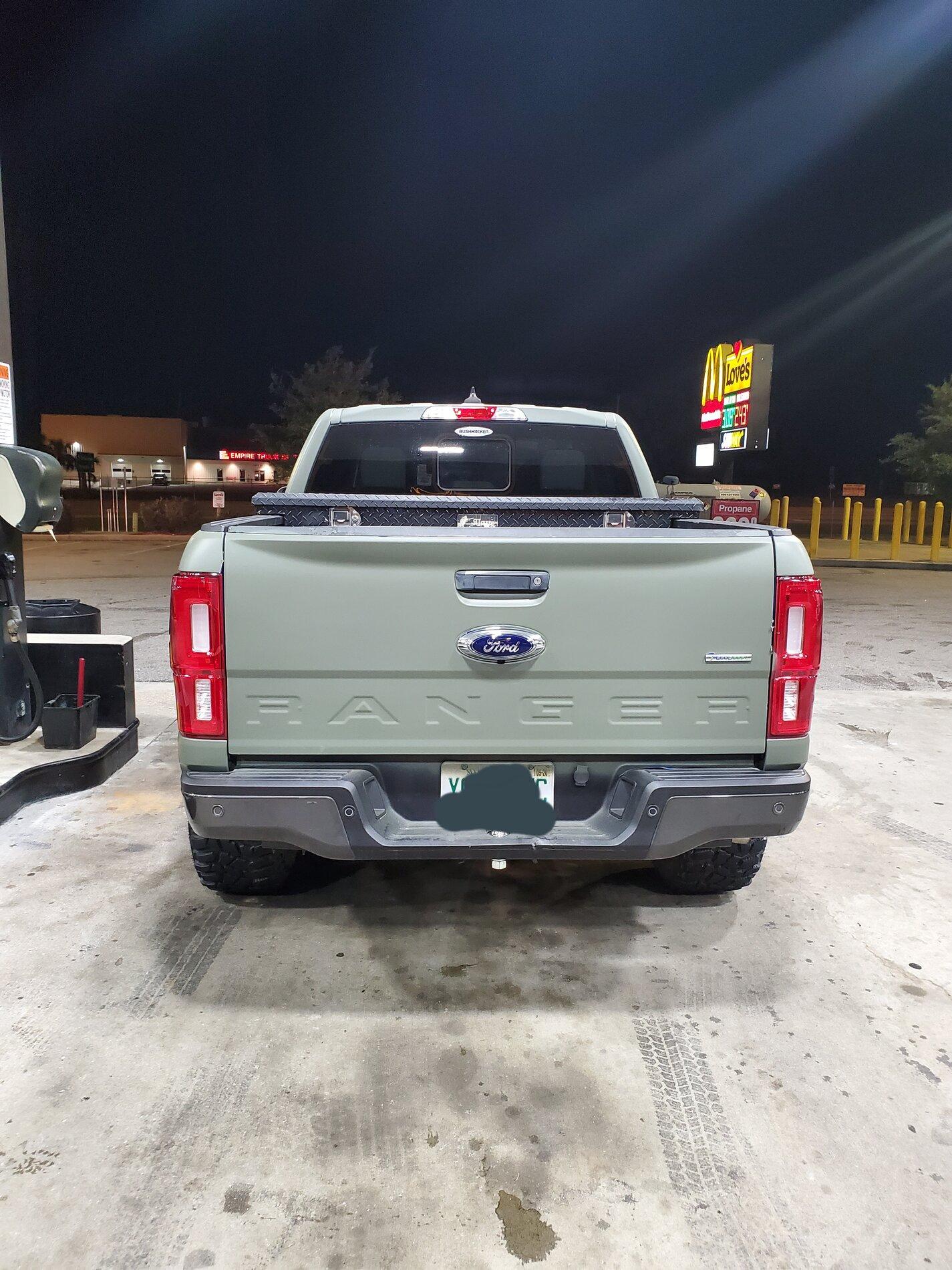

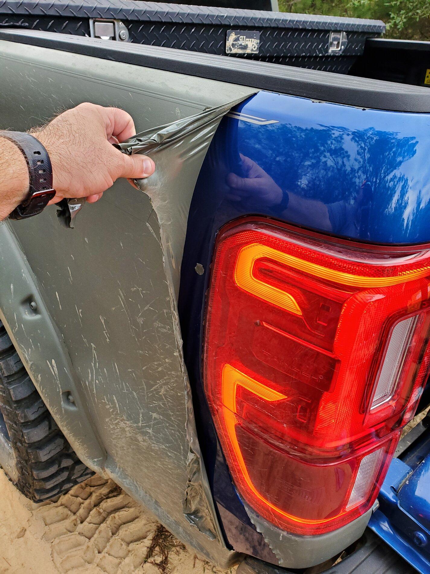

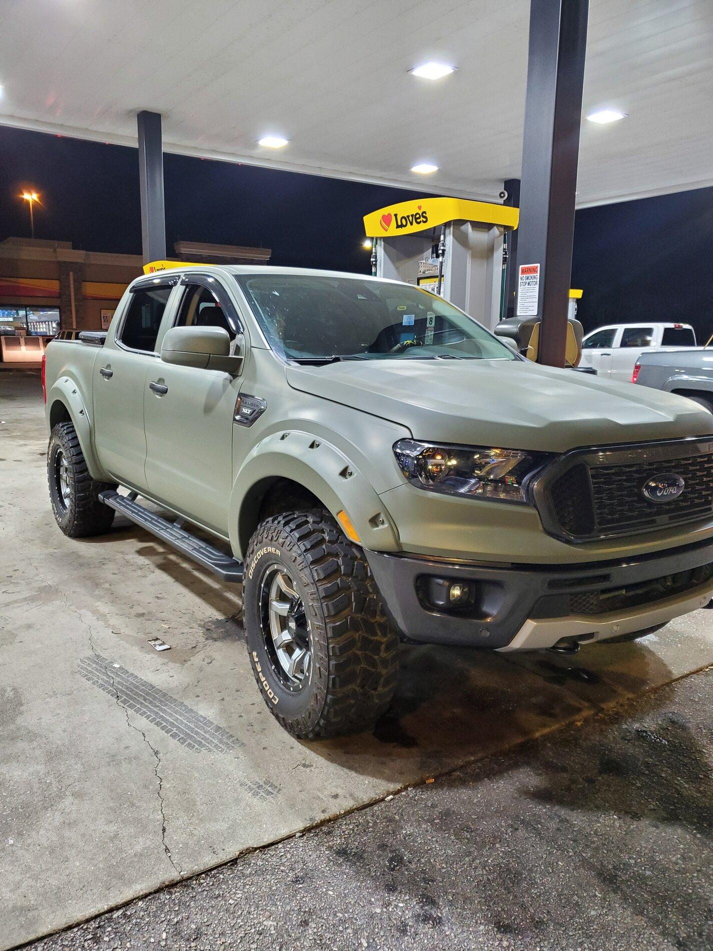

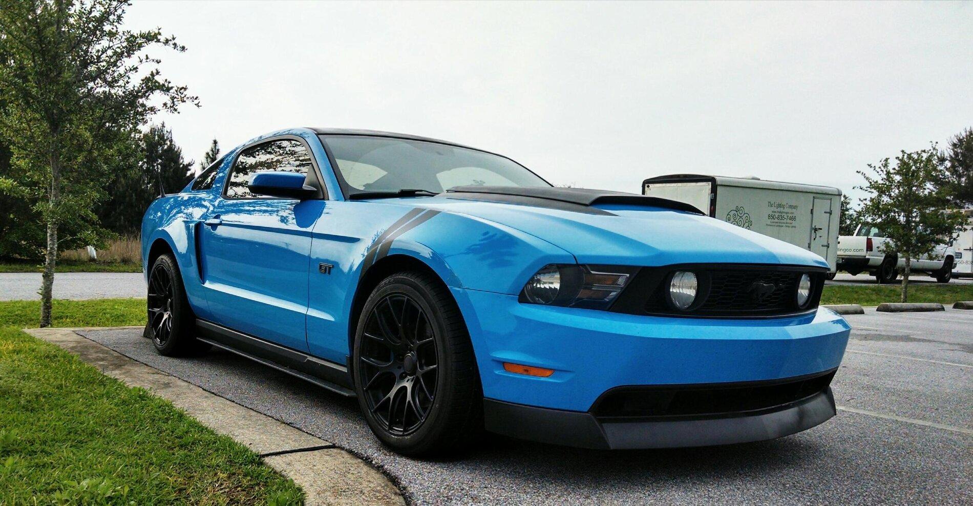

When I first bought my Ranger back in May of '19 I looked at the expel to get added. Like you it was nearly 5k for the entire truck. Hell for that I could repaint the entire truck white to hide the pin stripes off road. So with that I just decided to go the plasti dip path. I had years of applying dip to my Mustangs in one form or another. I mainly off road during Hunting season and I just need to protect the clear coat. After the season I just peal it off. I spend roughly $250 to get four coats of dip. Just finished my second season with extensive brush contact with no scratches. Like plasti dip expel will fade over time and become hazy. This happened on my 2010 Stang where I had it applied to the nose. It worked well to prevent rock dings but just too expensive for my taste.
