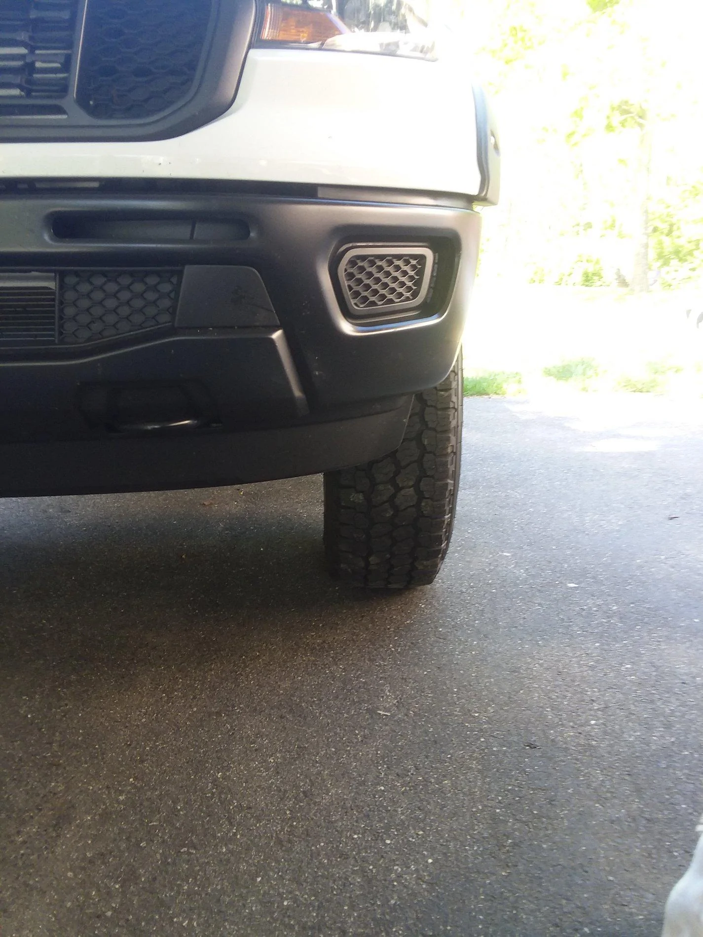

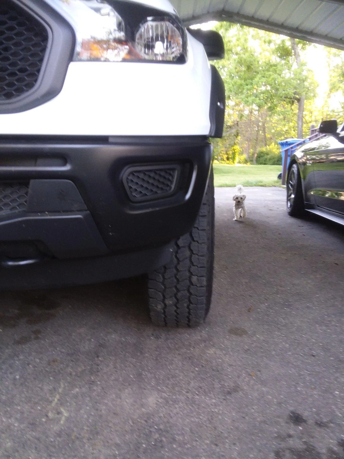

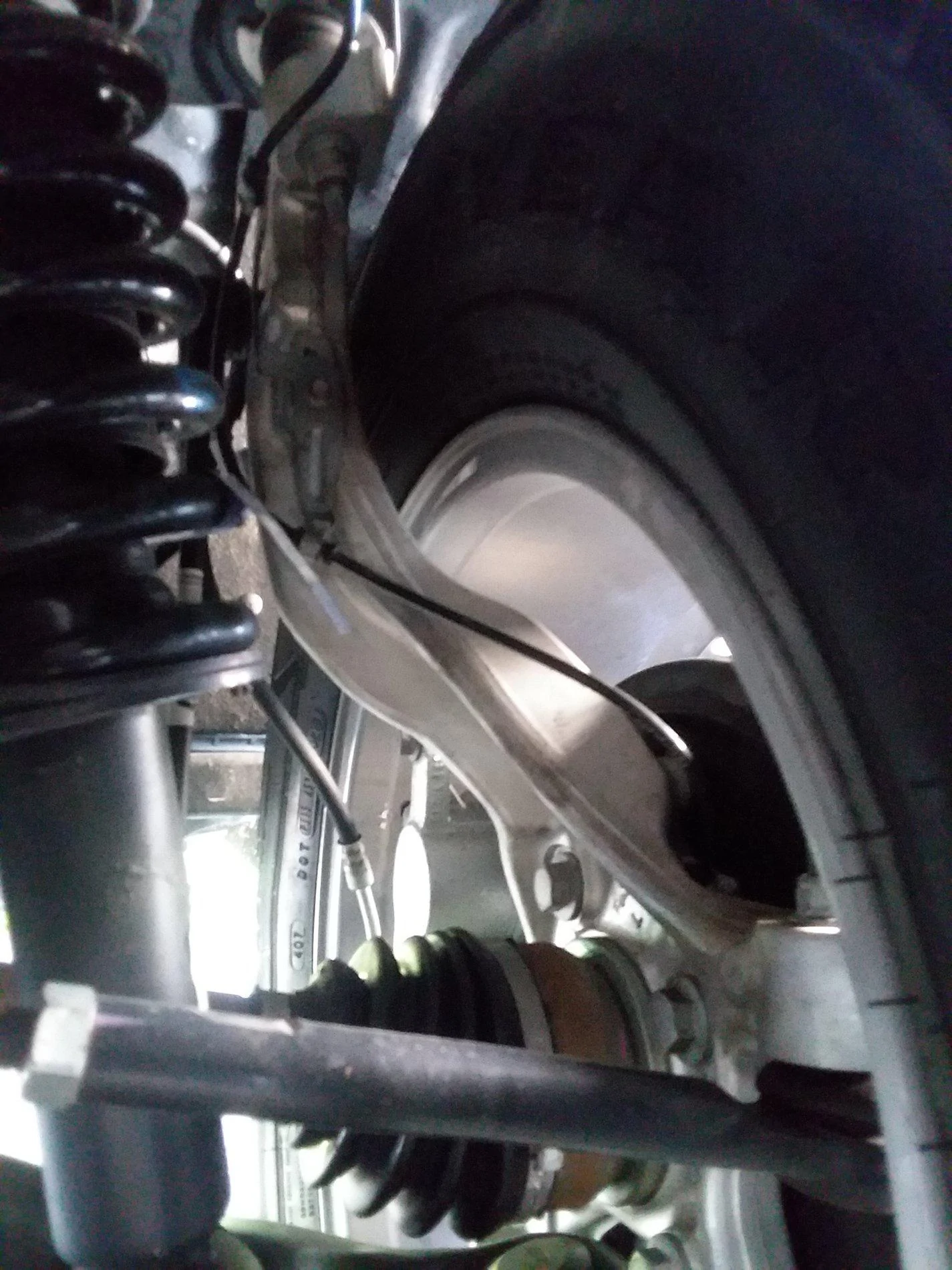

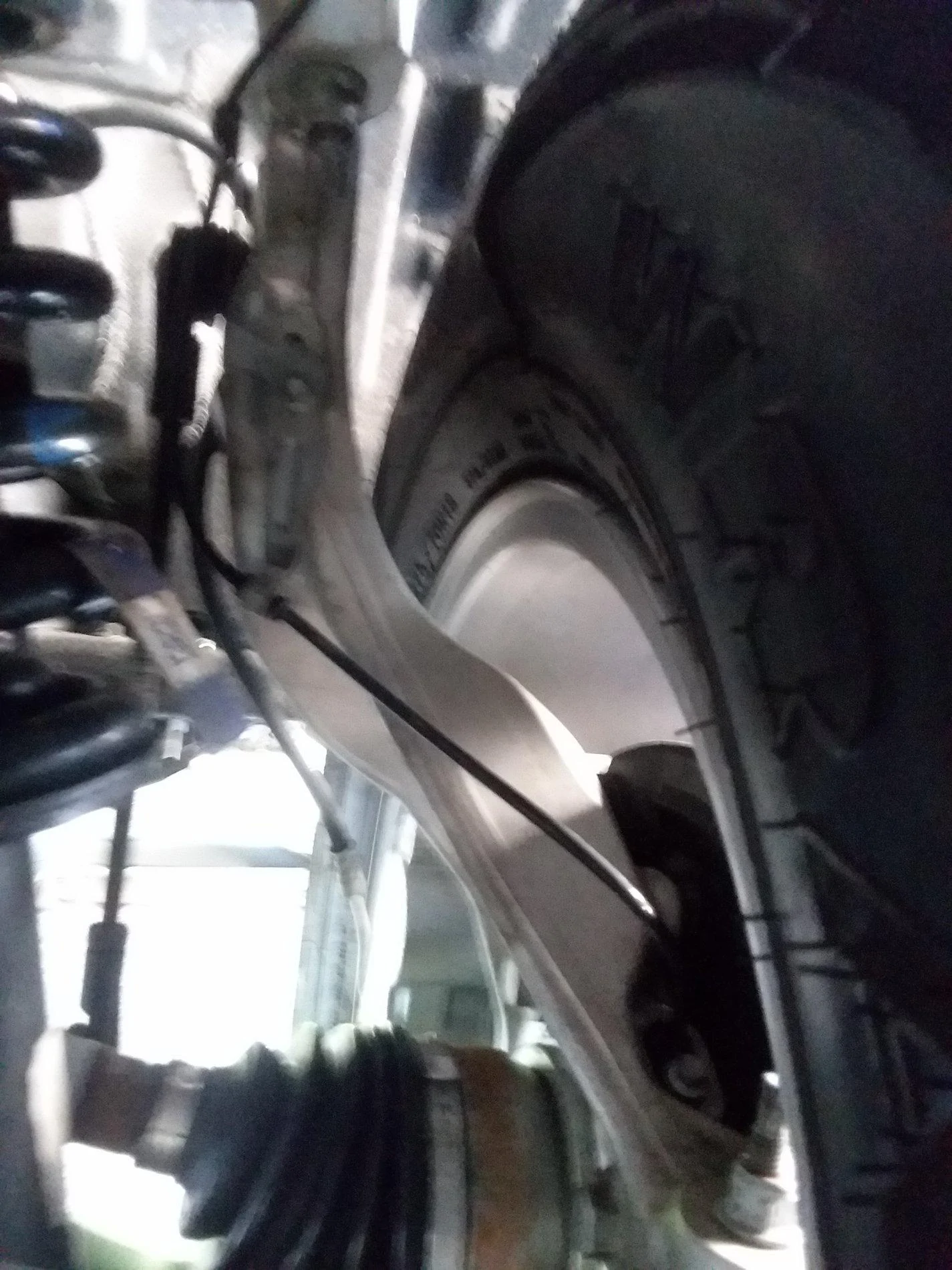

I Finally got around to installing my BORA 1” spacers on my stock sport wheels.
A little backstory….
I installed a 3” Ready Lift Level kit and BFG KO2 LT275/70R17 tires on my stock wheels right after getting the truck.
With this set-up, I had no rubbing issues so there were no modifications at all to anything, crash-bars, etc. I did the full-lock, left-right and forward-reverse on pavement…. no rubbing. Truth be told, it was REAL CLOSE at full lock, especially front crash-bar drivers side, full-lock turned to the right.
Over the Winter, I did a little off-road and a lot of snow driving but no rock-crawling or anything too crazy…. again, no rubbing issues at all.
I wanted a bit “more aggressive” stance, so I purchased the 1” BORA spacers directly from the manufacturer MotorSport Technology.
It took a few weeks to get the spacers (I think they make them to order?), but they are top-shelf quality. The fit & finish is perfect!
I installed the spacers and rotated my tires at the same time.
Here are a few pics:
Install was easy, as you can see, the spacer lugs are tucked into the spacer so the mounting surface for wheel is flush, no trimming of the studs:
Before Spacers:
After Spacers:
Another angle before spacers:
And after spacers:
After the install, I took my truck back up to my local parking lot for the full-lock testing. With the new spacers, I had just a little rubbing at full-lock, wheels turned to the right on the drivers side only. (not sure why pushing the tire/wheel out 1” created a rubbing situation?)
Upon closer inspection, on my truck, it appears the passenger-side front crash-bar was positioned about 3/8” forward. This gave more clearance compared to the drivers-side front crash-bar, thus the rubbing. (you'd think they'd be the same from the factory?)
So back home to remove the drivers-side tire/wheel. I loosened the crash-bar and pushed it forward, as far as it would go, about 3/8”. Tightened it up and went back to the parking lot AND ALL IS GREAT.... NO RUBBING!
The spacers do give much more clearance inside (knuckle, etc.). I don’t know if the 3/8” clearance at the front crash-bar is going to be enough in some hard core off-road settings? There is a lot of room at the rear crash-bars, so no issues there.
I am very happy overall with the stance of the truck with this set-up.
Cheers! ?

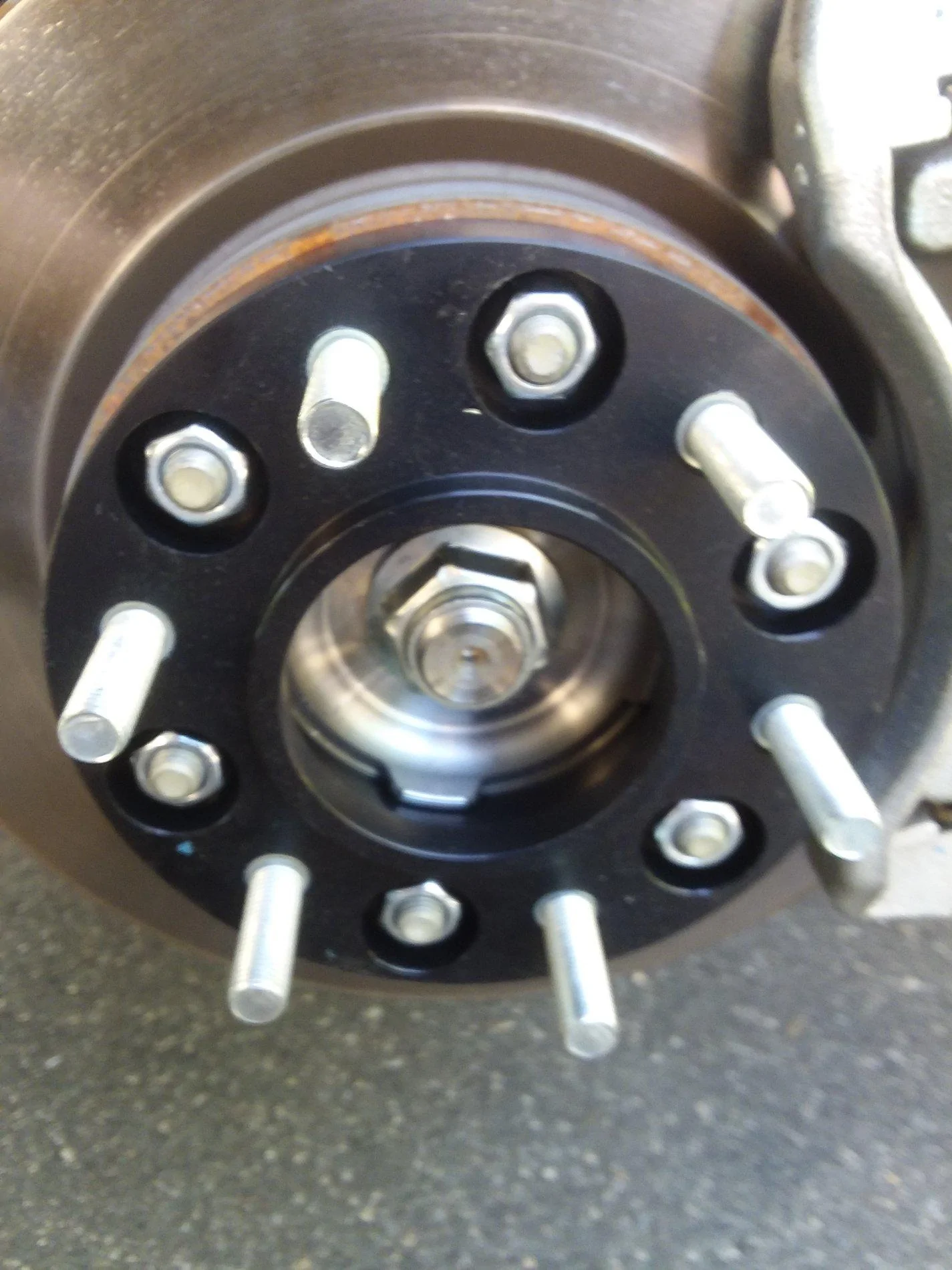

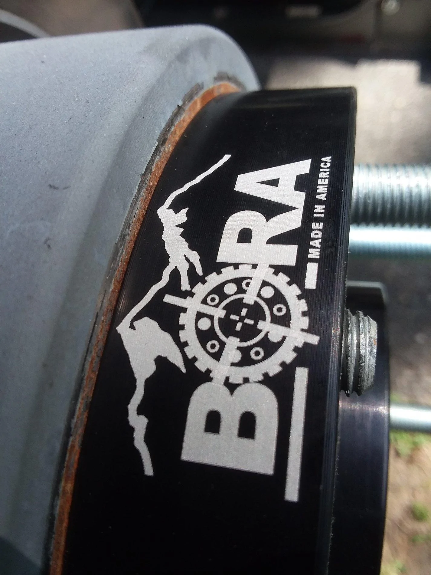

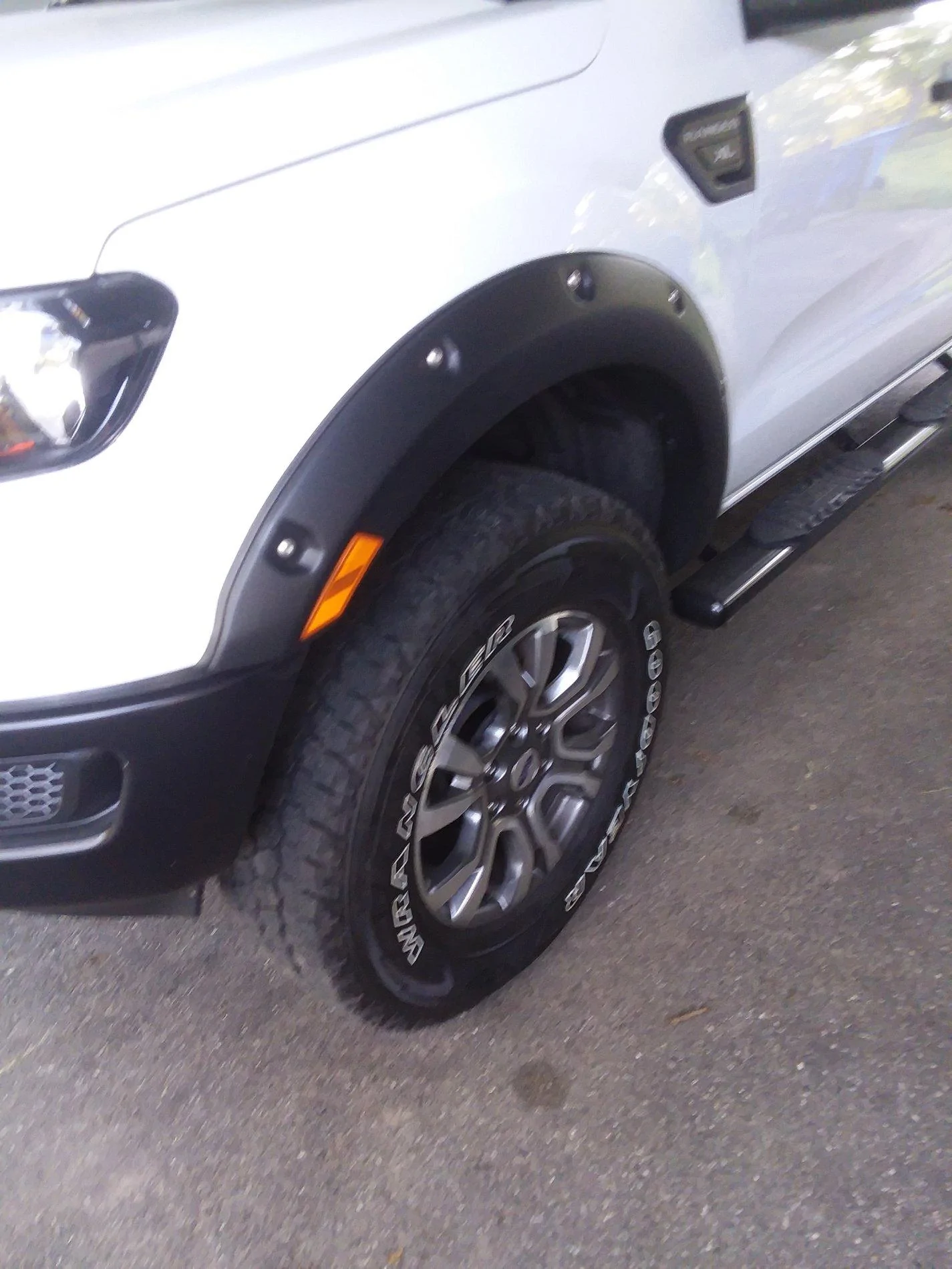

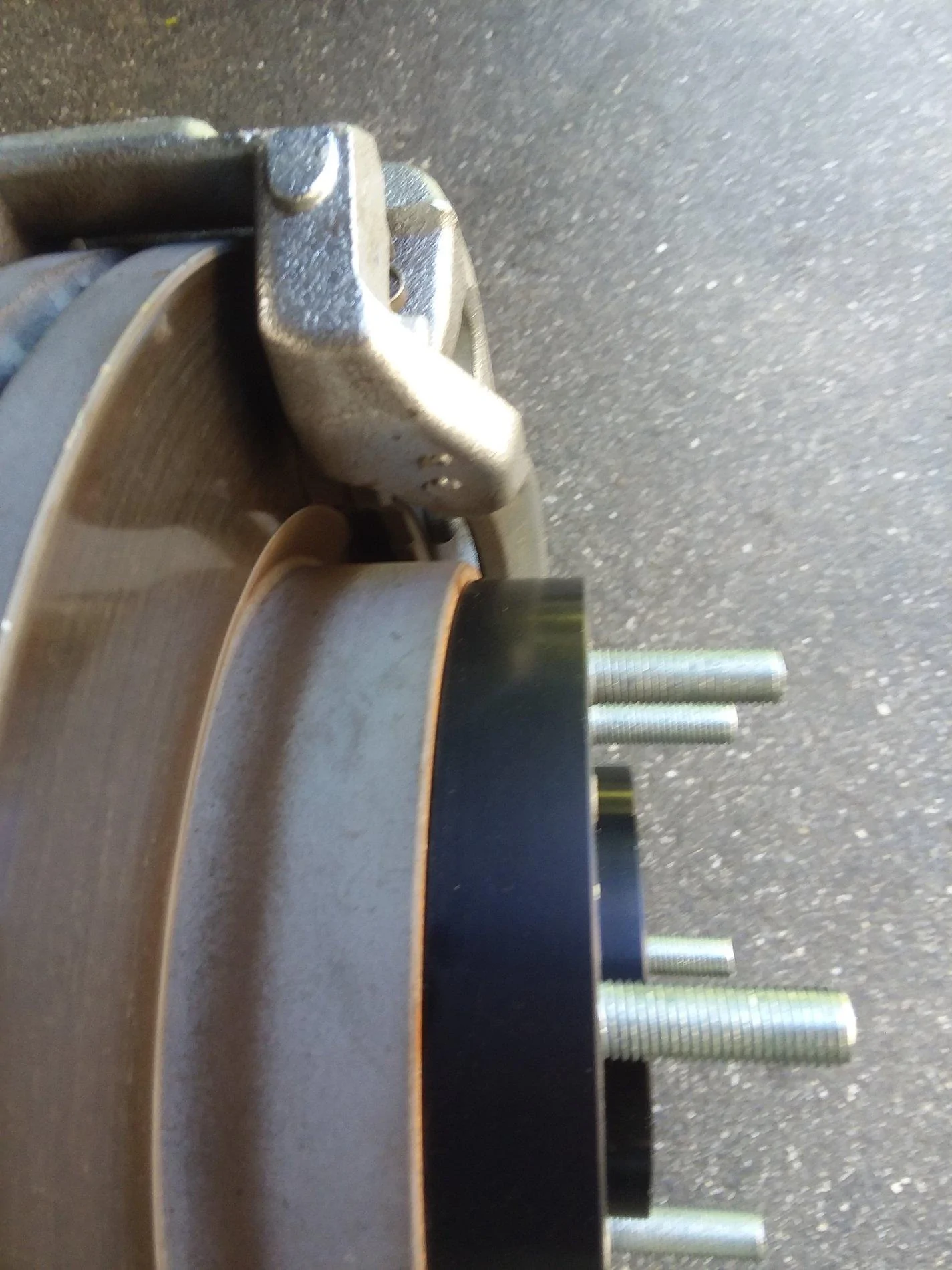

Needed follow up on this. I finally got around to putting the 1 inch Bora spacers on my 20 ranger. And the guys that replied that they fit without issue were correct. Thanks for your imput. BUT believe or not the passenger side rear. Had longer/different sized wheel studs than the other 3 hubs. See pictures below. I had to cut about 4 threads to make the one wheel fit properly. So the only thing I can ad when installing 1 inch spacers. Is pay close attention to every wheel. Some before and after shots. And the last photo will be of the wrong sized studs.

Here is a few more after photos. The truck does look better with the wheels pushed out. Kinda wished I went with a 1.5 inch spacer now. And I can say for a fact. Anything less than 1 unch will require cutting of the stock studs.

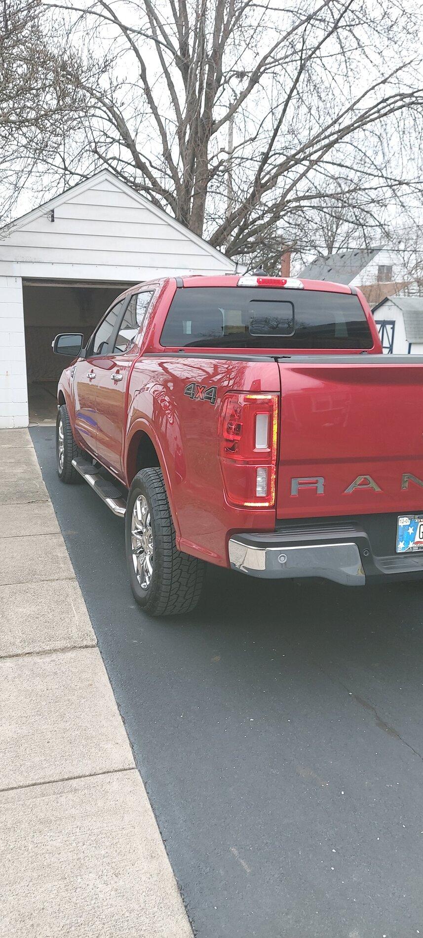

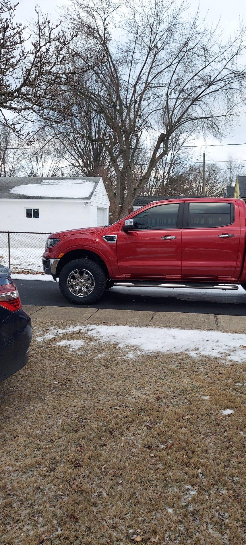

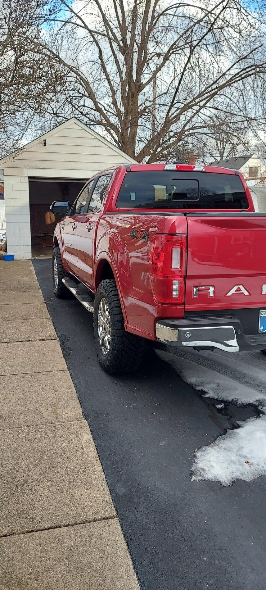

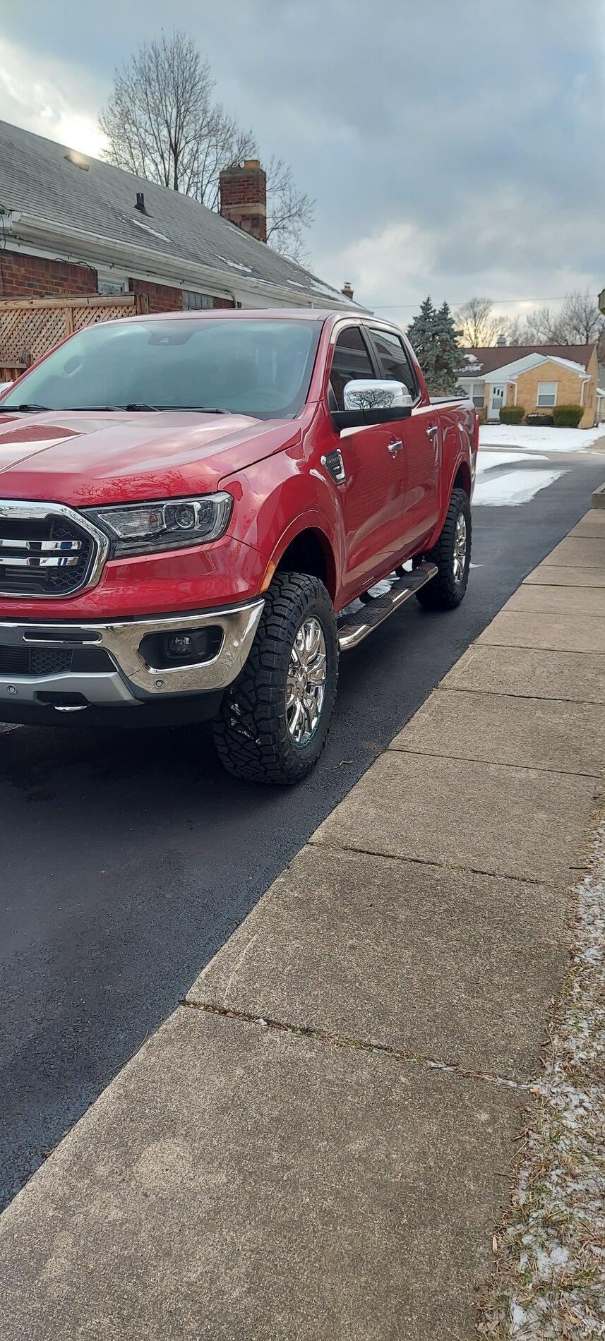

I've got the 1.5 on my 18 inch wheels with factory Hankooks had slight rubbing on drivers side crash bar ! Removed it and ordered high clearance ones from cj pony parts haven't got them yet , having dealership install roush stage one level and new nitto ridge grapplers 275-65-18 as soon as they get the parts.

This is with 1.5 inch spacer and stock 18 hankooks
