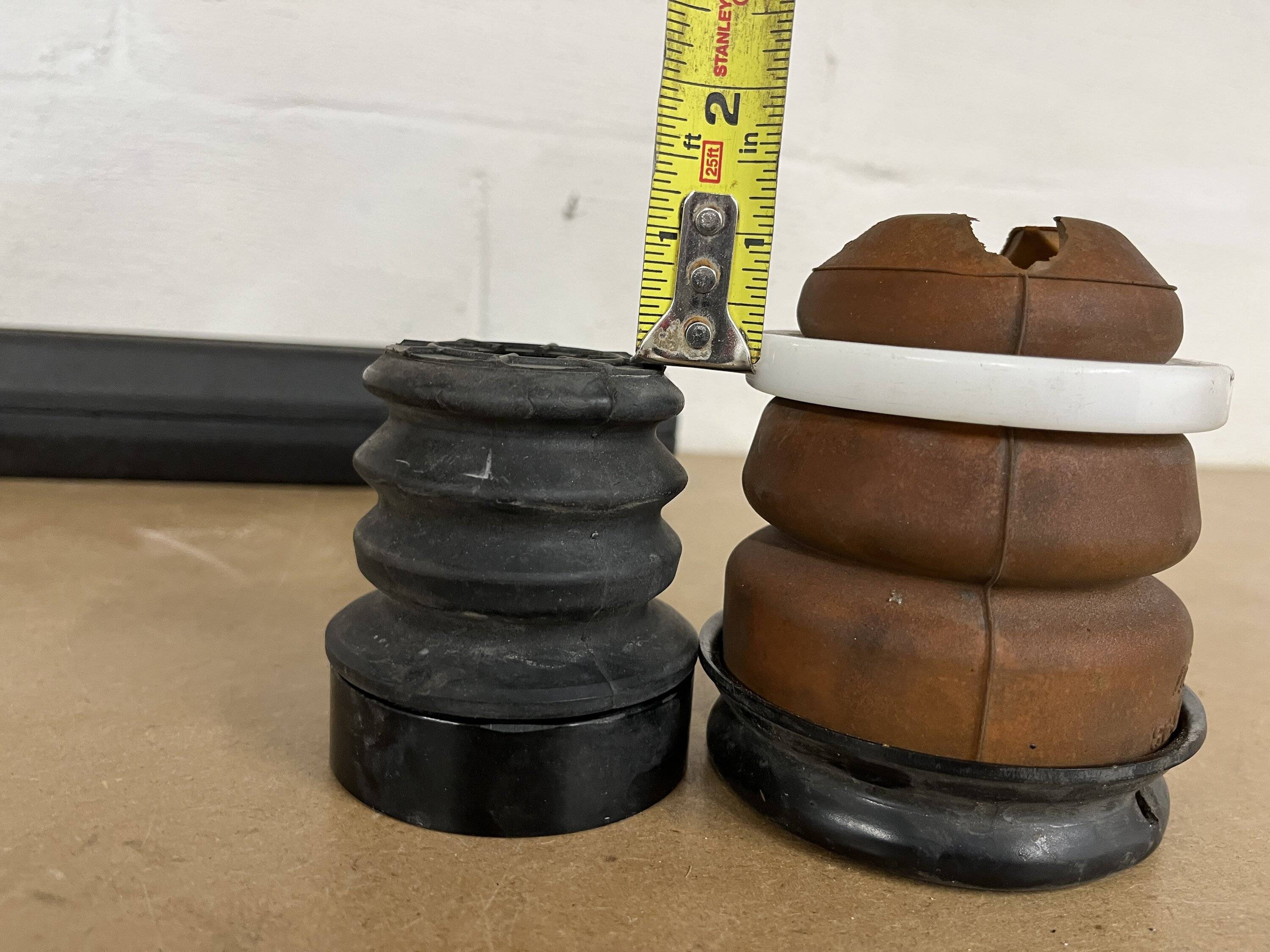

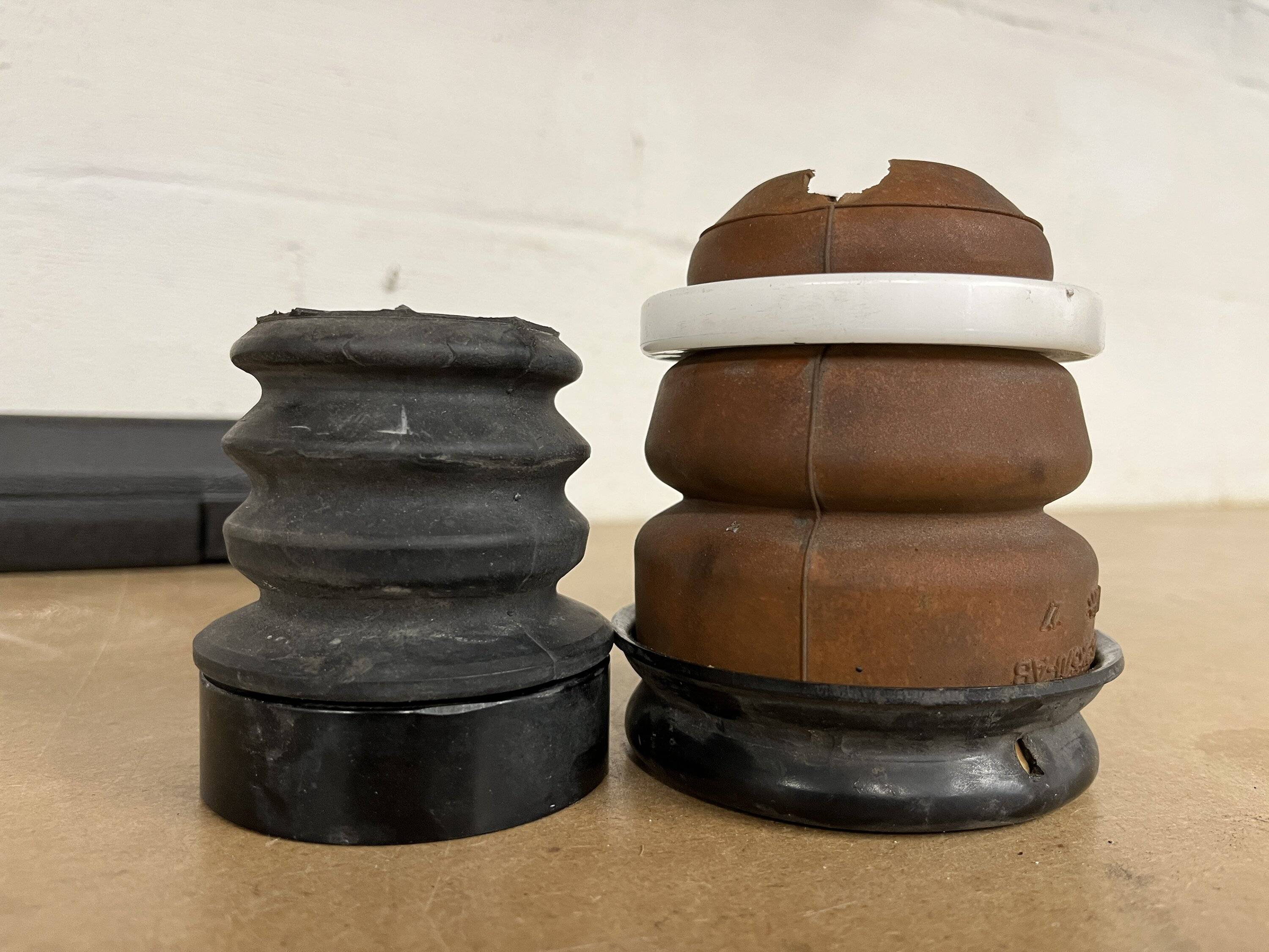

so today i was swapping bump stops around.
took some measurements.
things i’ve noticed.
stock is a polyurethane foam, so soft and progressive.
icon is way harder, more of a traditional bumpstop.
the icon one is actually only 3/4” shorter. the notched area on the stock one im not taking into account because you can fold that part in with your fingers.

I wonder if the ring helps keep it's shape and size.

Ohhh, nobody would want it to split. That would be all kinds of bad.
