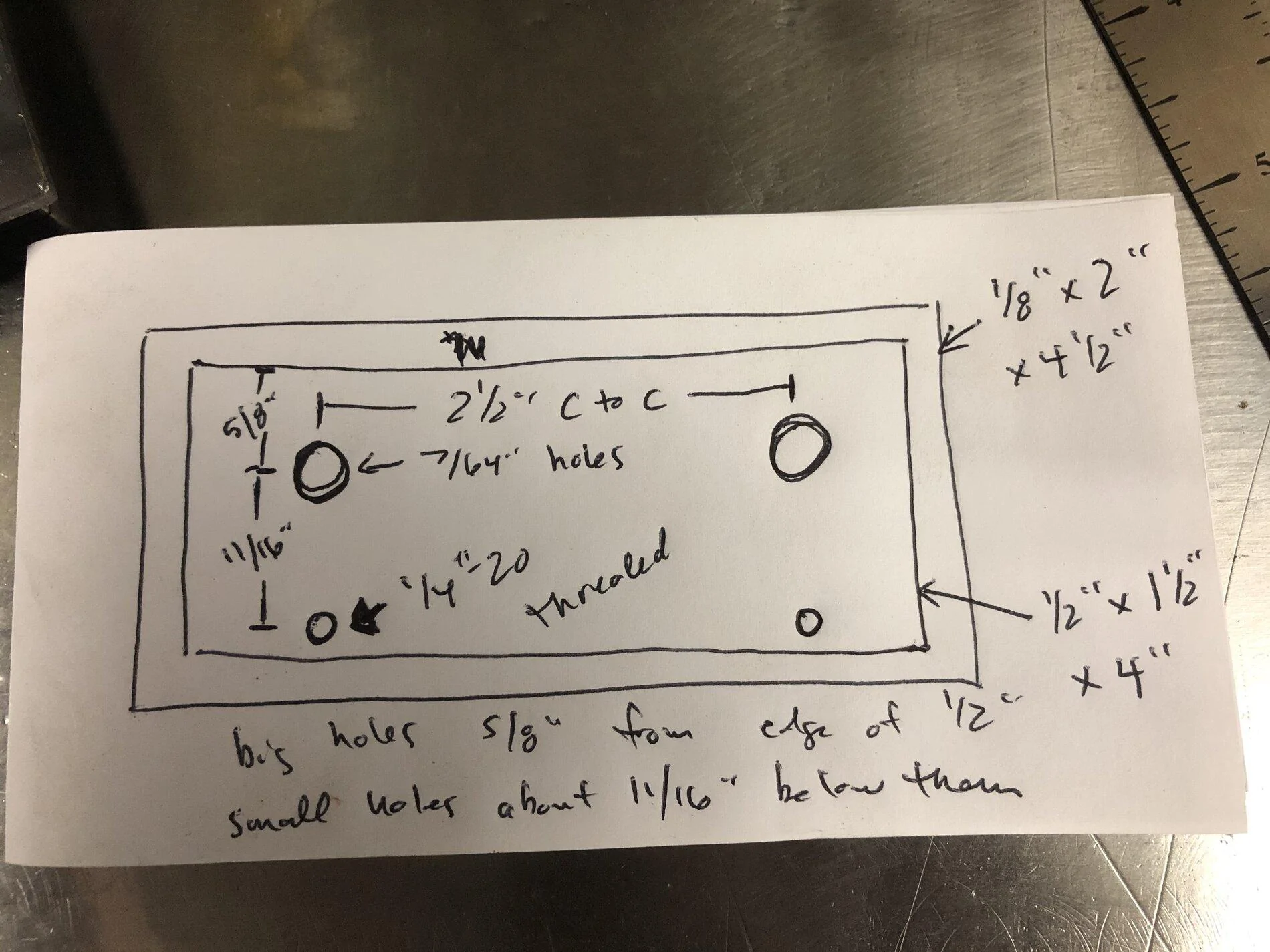

No worries, thanks for the response. Do you happen to have any drawings or dimensions of the final product that you can share?
It’s a pretty crude drawing but I made this for @BC_Express as he was asking for it too. Maybe he can make you a set if he bought enough material for his?

I bought some aluminum flat bar from metalsdepot.com.
4x2x3/4.
I just drilled (2) 7/16ths holes 1 1/8 inch down from the top 3/4 inch from each side. But use the brackets as your guide before you drill them out. Honestly it wasn’t difficult.

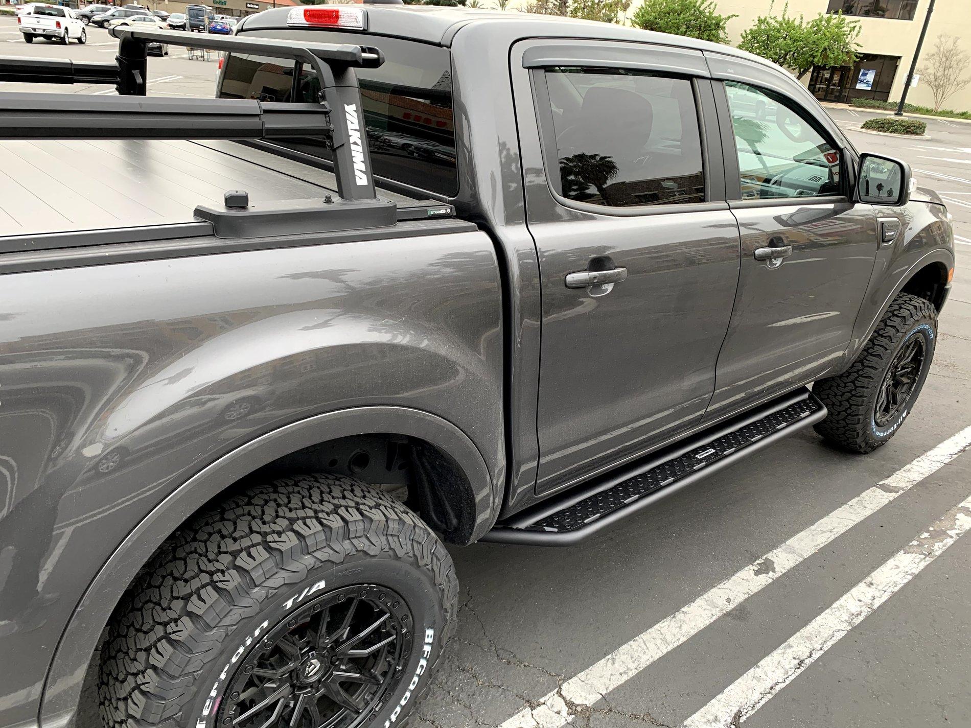

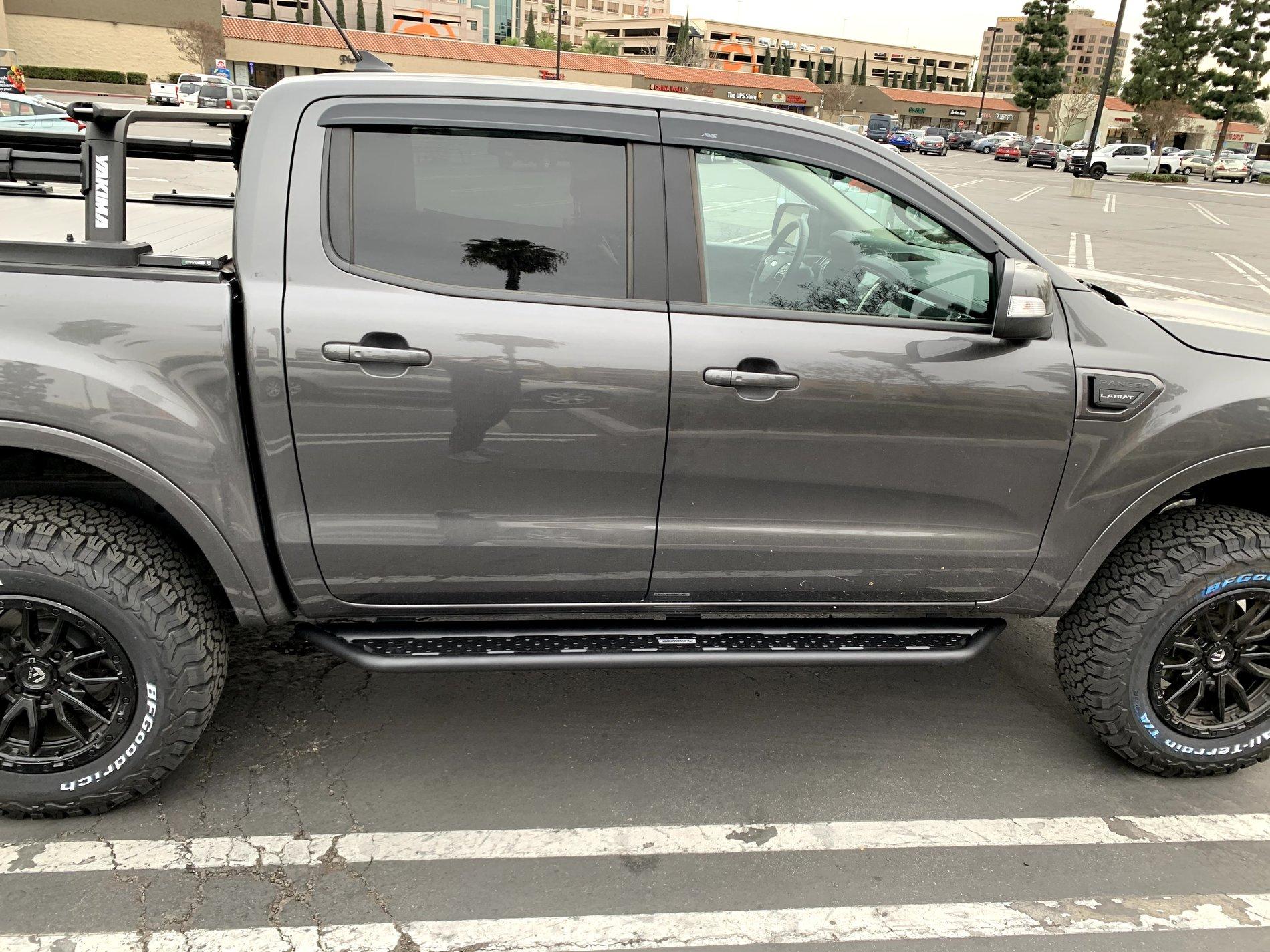

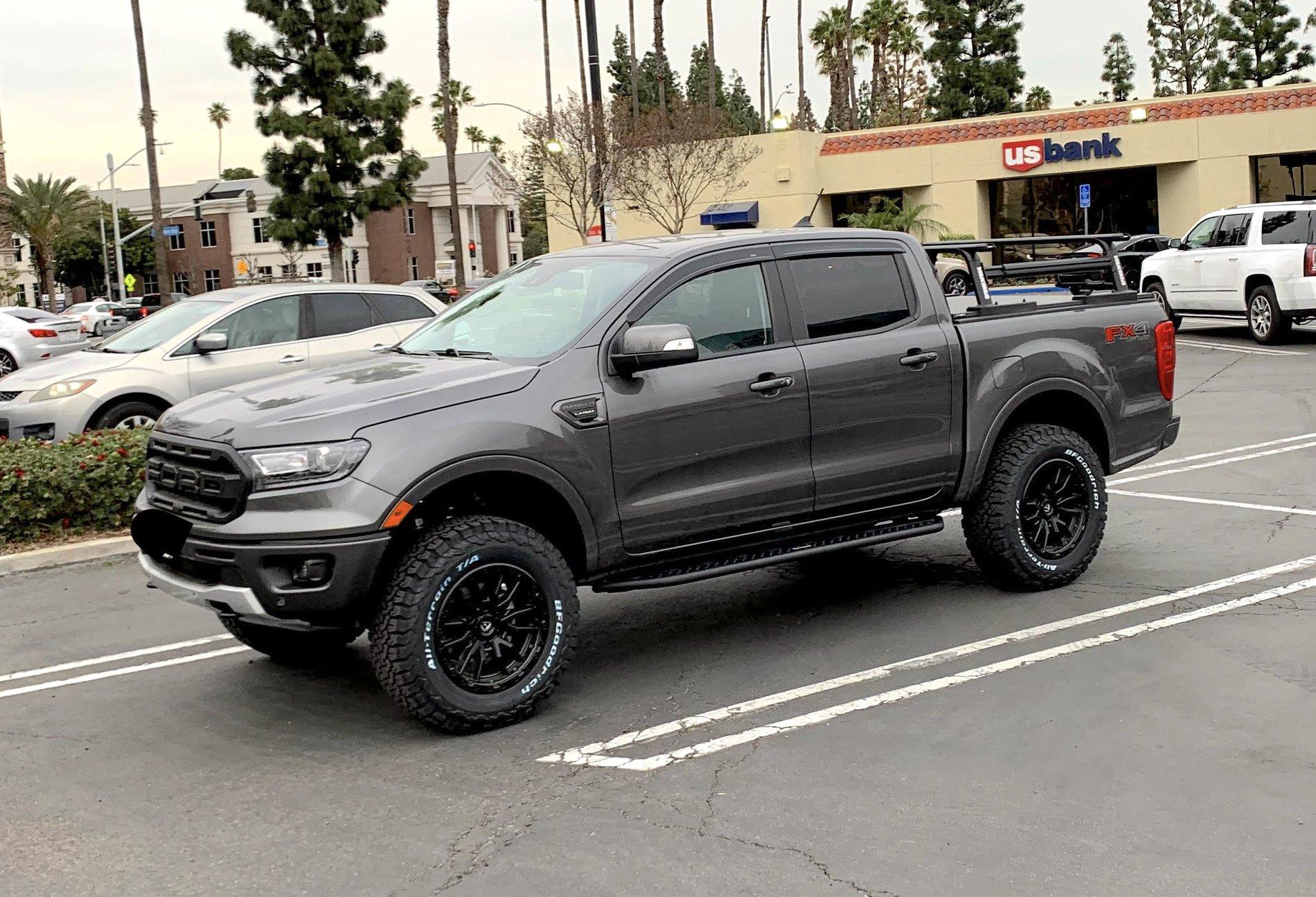

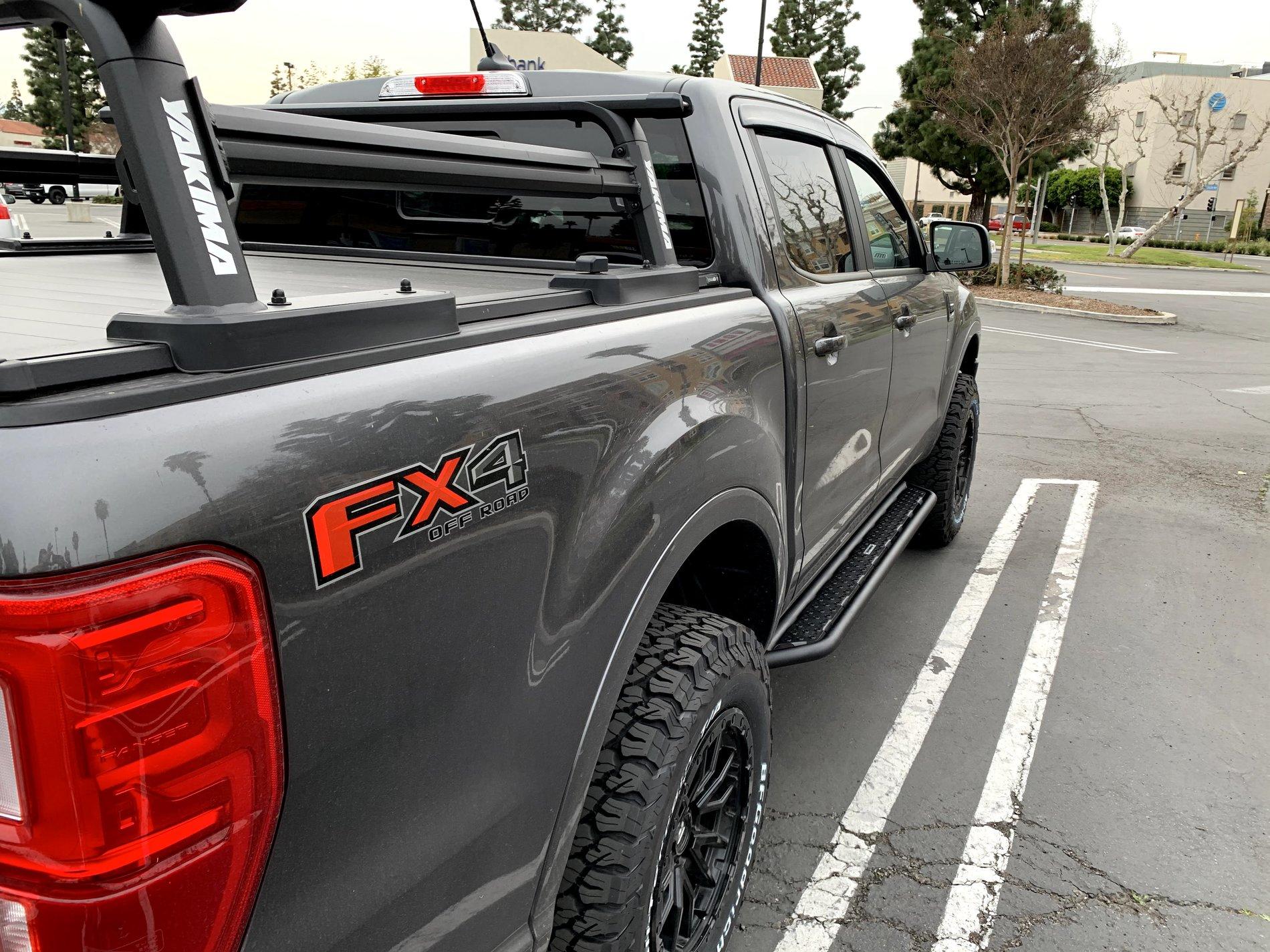

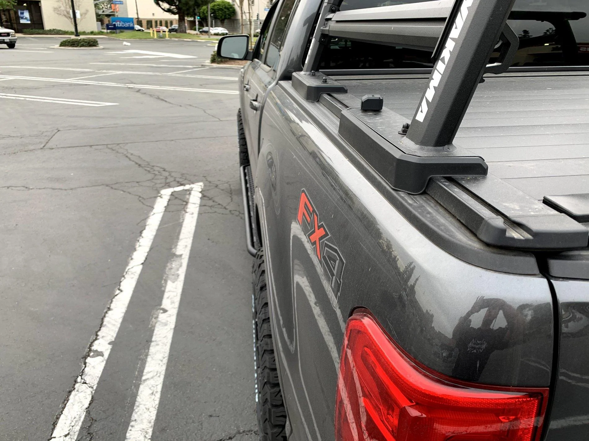

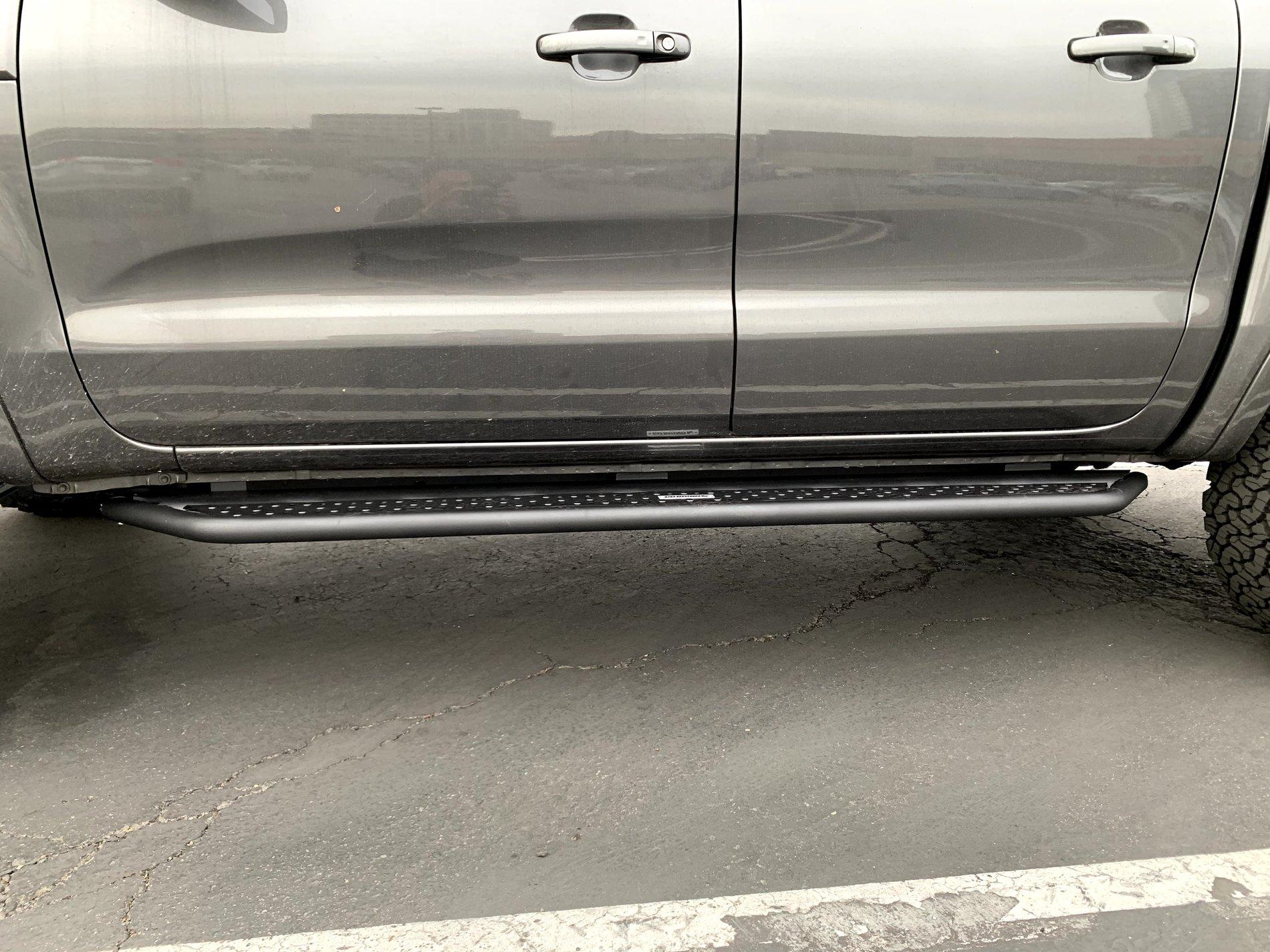

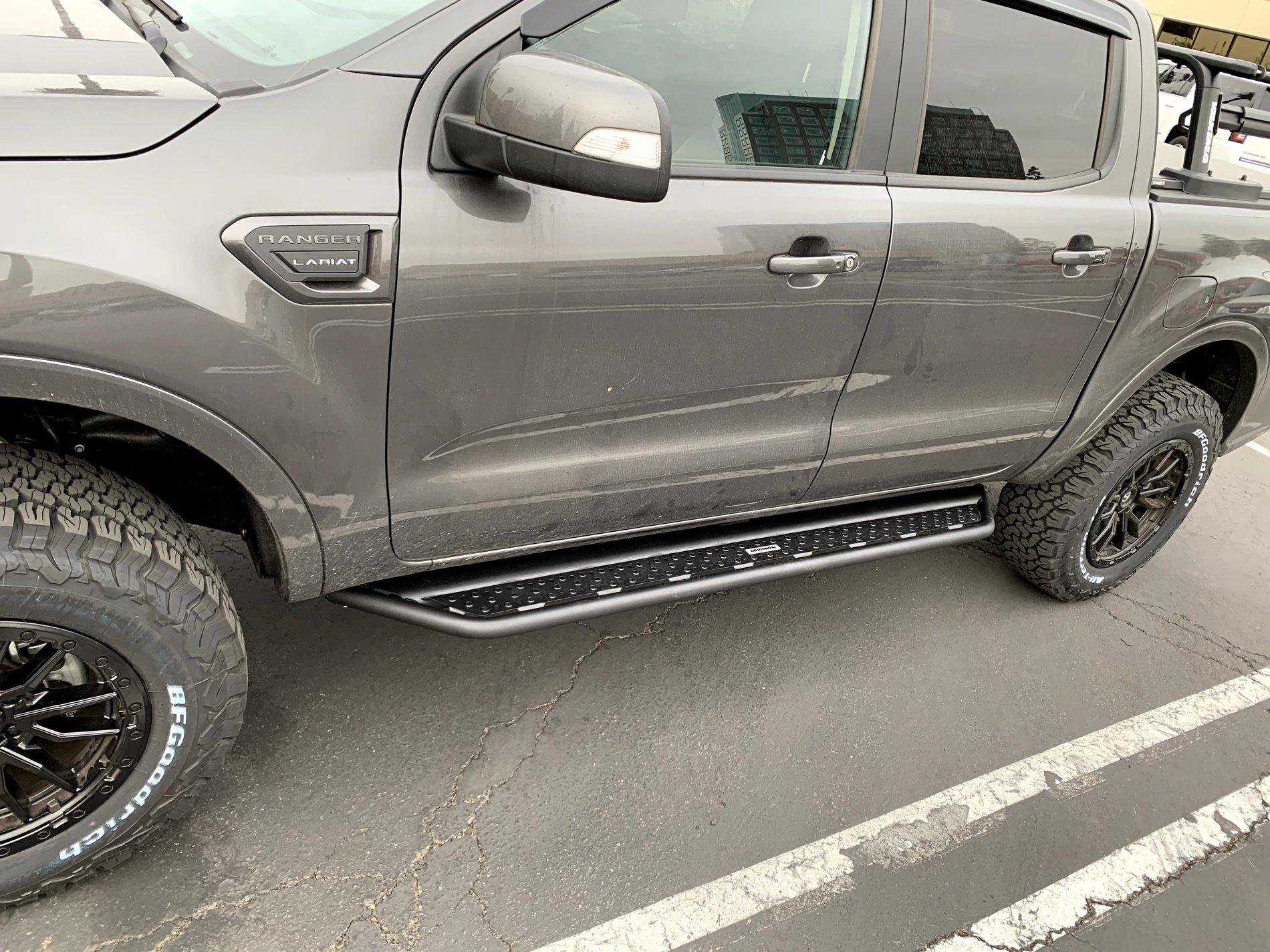

OK, got the D6's installed. First thing I would say is that they are definitely running boards width wise. It still has a slider look which does give the truck a more rugged appearance. I tried to get a bunch of different angles to get an idea of the width, how far it sticks out, and just how it looks. I think this is only a good option if you have wheels with an offset that stick out further than stock. I have a +20 offset and 18x9 wheels with 285/65's and they are about evenly aligned.
For me I was looking for a step for when I get a roof rack and a little more protection. As a step to get into the truck its probably pointless. I won't use it as a step into the truck and it will take some getting used to feeling it hit the back of my leg when I get out but they should serve their purpose for my needs. I will say there are 2 sets of holes to install them vertically, maybe a half inch apart from each other I'd have to measure, so they can be installed slightly lower than I installed them, very slightly.

They are 18x9 Fuel Rebel 6. These particular pics are with the +20 offset. I have since swapped them out with -12 offset just to get a wider stance. It actually goes much better with the D6's and flares.
Thanks for the response. I Love the way the D6's look but I'll definitely want to widen out the truck to compensate. I wanna be able to get a foot on there, and my 12 year old needs a little step too, with the lift.

It works great as a step. Definitely helps me with a secure extra step when putting the baby seat in the middle seat. Should be useful once I get my roof rack installed as well.
Thanks John .. just getting back to doing this. I don’t understand why the 2 size plates and the threaded holes. I was thinking 1 plate and get longer bolts. But I am sure you have a reason and a plan. Teach me, please.
