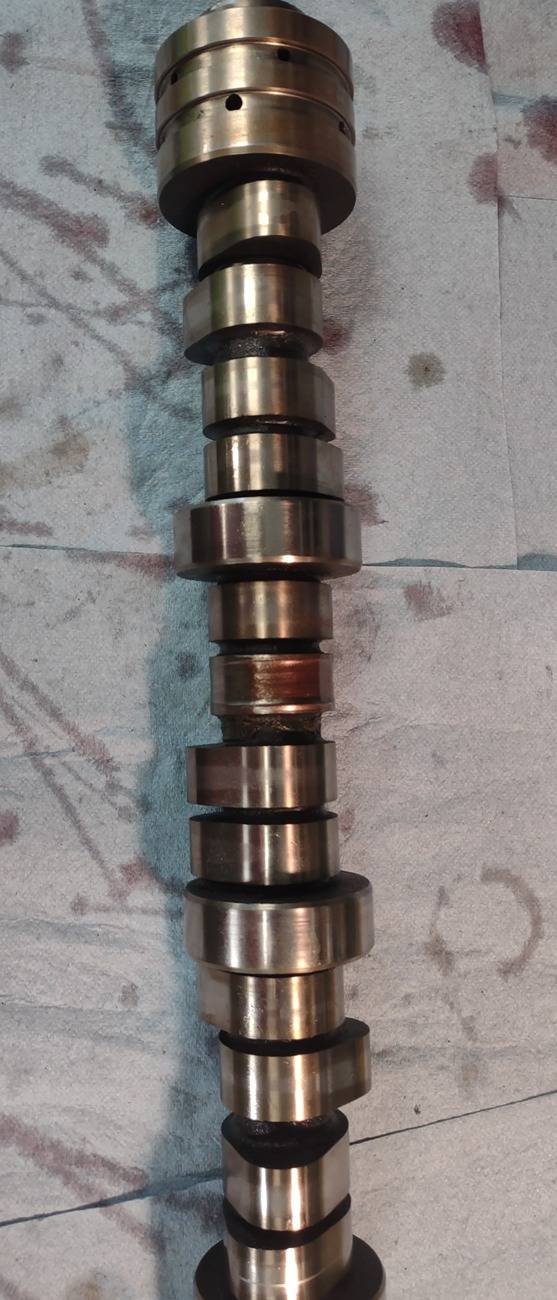

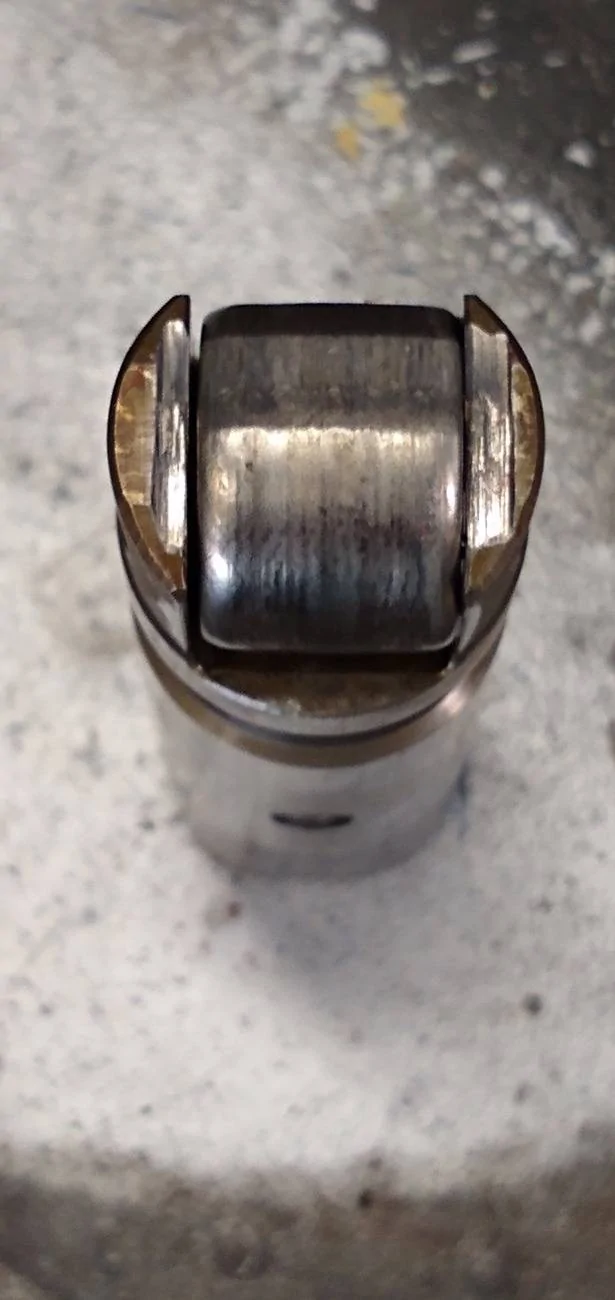

Yep, it's called Multiple Displacement System or MDS. I got the Hemi in my hot rod because one of the MDS lifters failed and wiped out the cam. When I rebuilt the engine I replaced all the MDS lifters with standard lifters, removed the MDS solenoids and plugged the ports.

That is the way the Hemi MDS system works too. Here are a couple of pictures of what happens when one of the lifters fail.
I speculate that when a cylinder deactivates the load of the cam pushing on the lifter against the valve springs goes away. When it reactivates there is a sharp increase in load. Over time the needle bearings in the lifter take a beating and one fails resulting in the roller not rolling over the cam and the lifter and cam lobe are ground away.
When I rebuilt the engine these parts came from I got rid of the whole MDS system.
