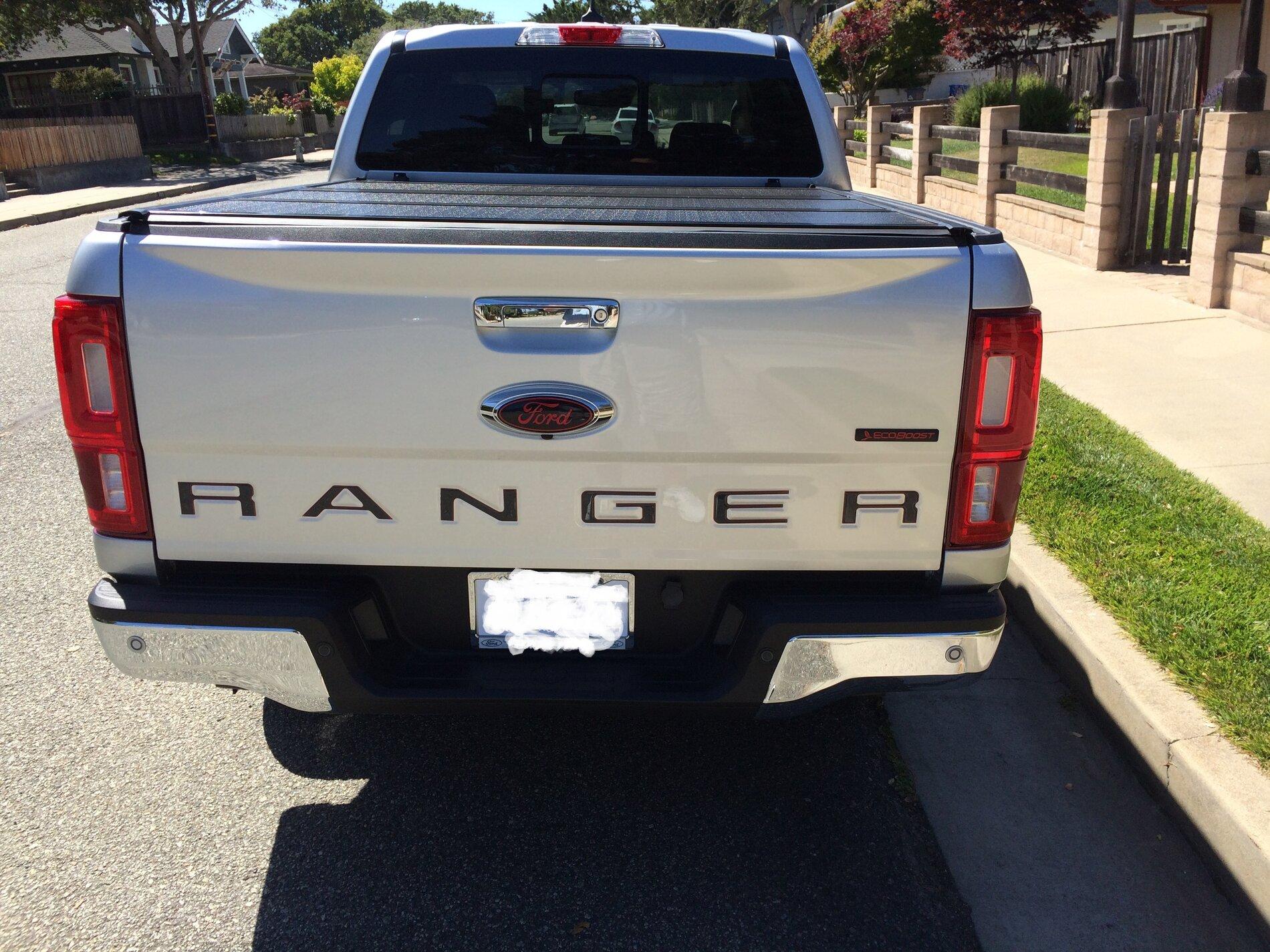

I'm with you Ranger Marc, that little ecoboost badge doesn't bother me at all but that crooked FX4 decal had to go

The ecoboost badge has a cool retro factor to me. teal reminds me of the early thunderbirds. Stays.

Just pulled off the 4x4 stickers off mine. Looks 1000x better.
I also removed the ecoboost badge, maybe people will think its a 2021 ? ?

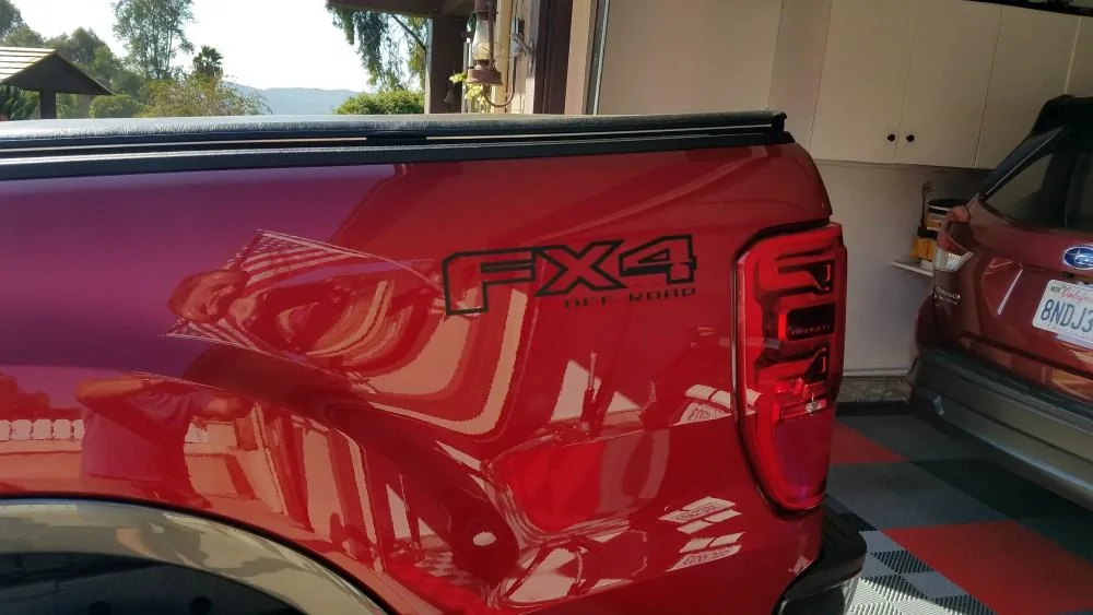

I ended up doing this. I think I like the subtle look better with the Rapid Red. However, I really like the O.E.M. FX4 on the white trucks.
That's what I'm planning on doing to my lightning blue truck. Really don't like the OEM red sticker. Stands out too much, I also go for the more subtle look. Looks good on the red! Now I really want to get it done.
