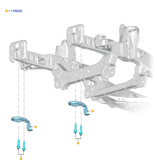

Thanks. Not planning on anything crazy and would plan to use a Y
If you do you need to be sure to have the two legs of the 'Y' as long as possible, or you will be applying a lot of right angel force (inward) to the tow hooks, when they were designed for straight line force.
Trigganometry
Dec 4, 2020
153
5,832
25,367
Engineering
As far as bolt tinsel strength. The weak link I’m thinking is the rivet nuts in the frame. If you yank on your hooks hard check the torque later on. Threads might stretch
