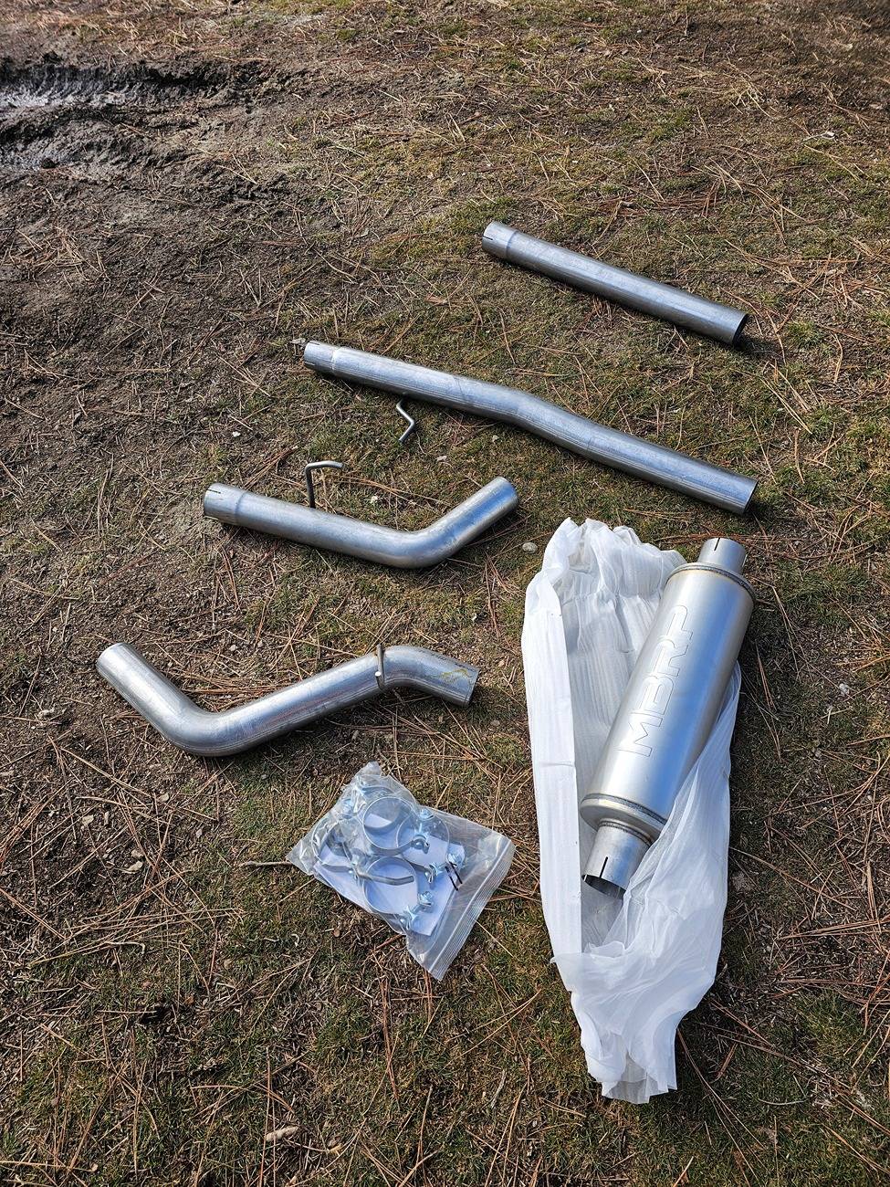

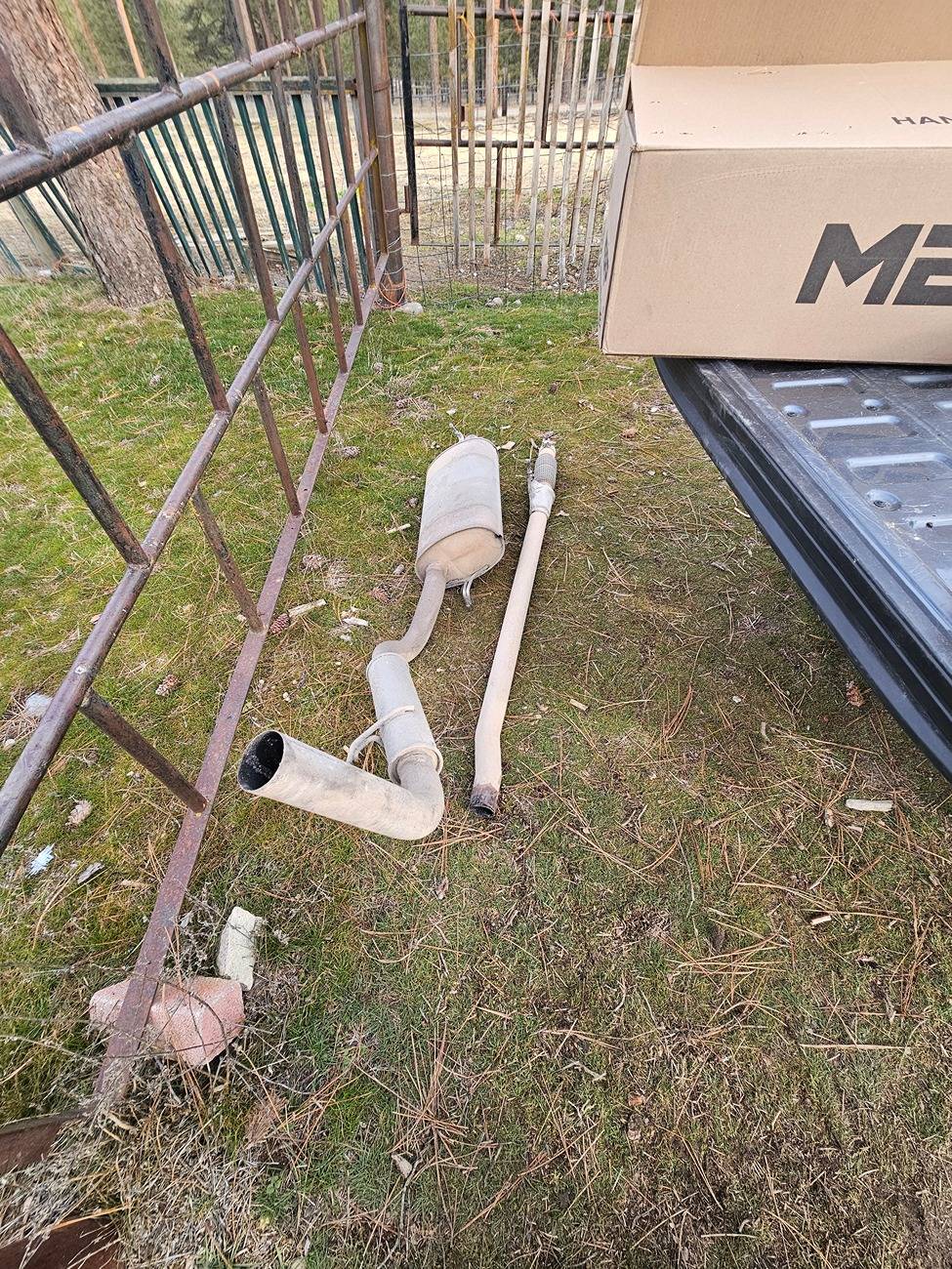

No flex on my mbrp system. No issues with 15k miles including off road and lots of miles on washboard/ dirt roads. Images of old and new system. This plus the open cone intake really helped let it breath. I can hear the turbo spool up and it hits hard all the way till redline. Before the truck felt like it was always not able to move the air fast enough. The intake was fine stock but the exhaust system really helped.

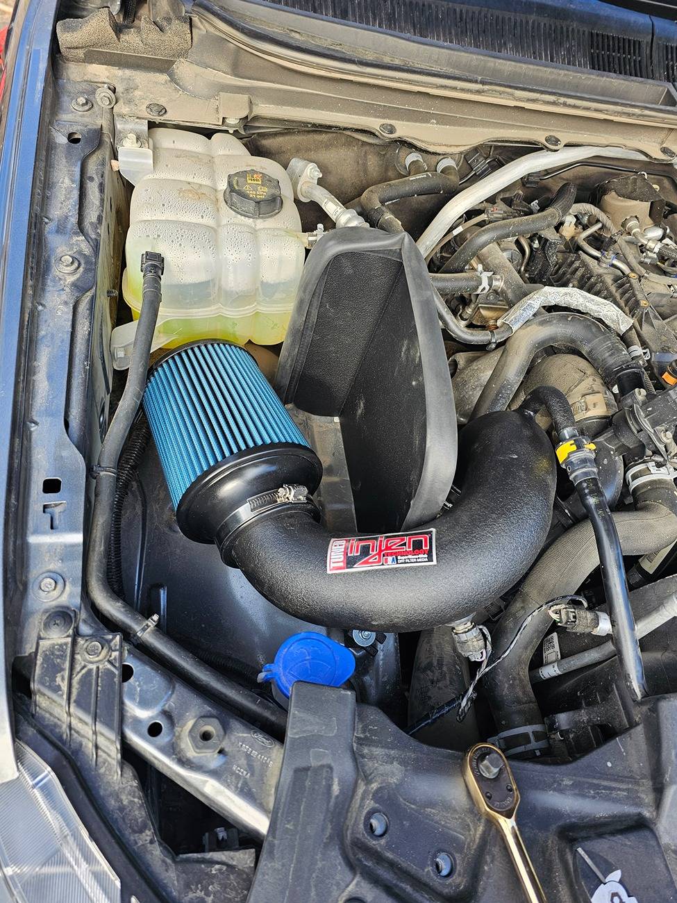

I have the same Injen intake and love it. I chose the Flowmaster 717909 FlowFX Cat-Back Exhaust System which came with the flex section. 3" is a bit larger than stock, so the expanding gass wiIl cool and slow, so I wrapped the whole thing stem to stern with fiberglass then painted it with hi temp brush on paint. I did a muffler delete as the wrap soaks up tons of sound and keeps my cab cooler in the summer.
