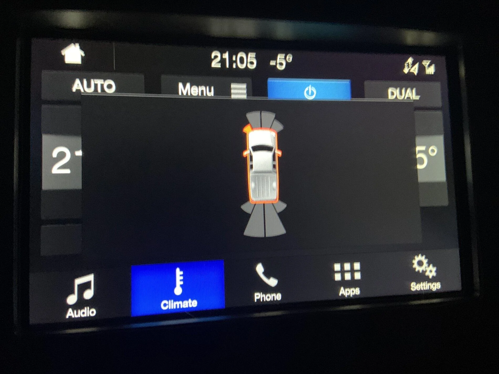

Like this? Started today. Sound signal too. Turns off when I start moving. Has been snowy and icy but the sensors look clean. Truck was in doors for 2 hours tonight but outside on way home it started again.
