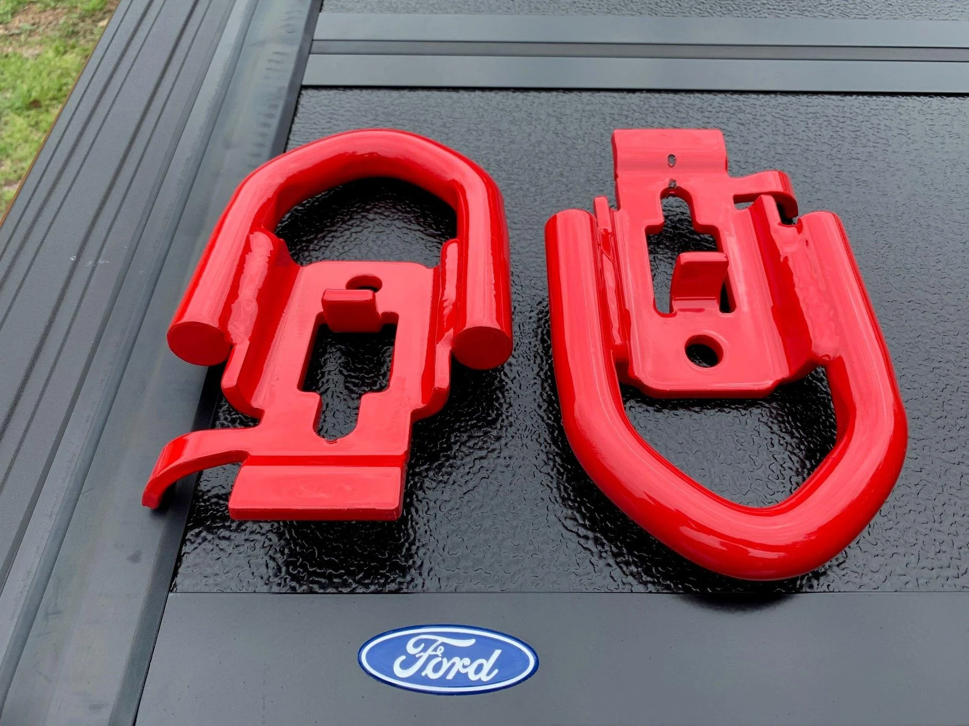

The tow hooks are different between the 2wd and 4wd models. If you have a 2wd and plan on swapping the skid plate from a 4wd, you'll need the 4wd tow hooks. The skid plate actually mounts to the tow hooks, not the bumper.
I have a Lariat FX4. Anyway 2WD or 4WD, did you notice any difference other than color between your new and old tow hooks? I was wondering if they were any heavier duty or just painted a different color.

2wd hooks dont have provision for mounting the skid plate, the 4wd hooks do. The Ford Performance tow hooks are the 4wd type
