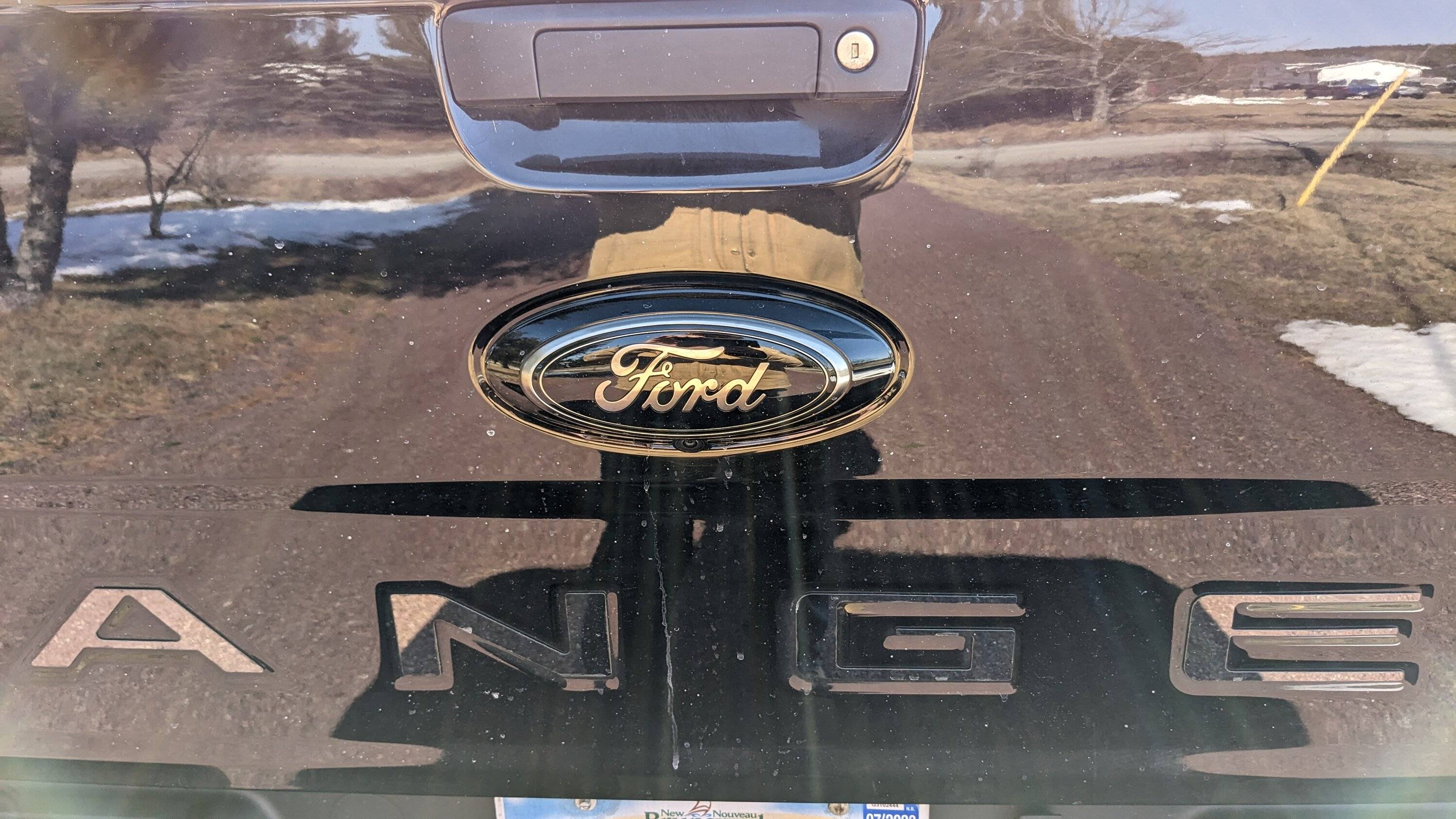

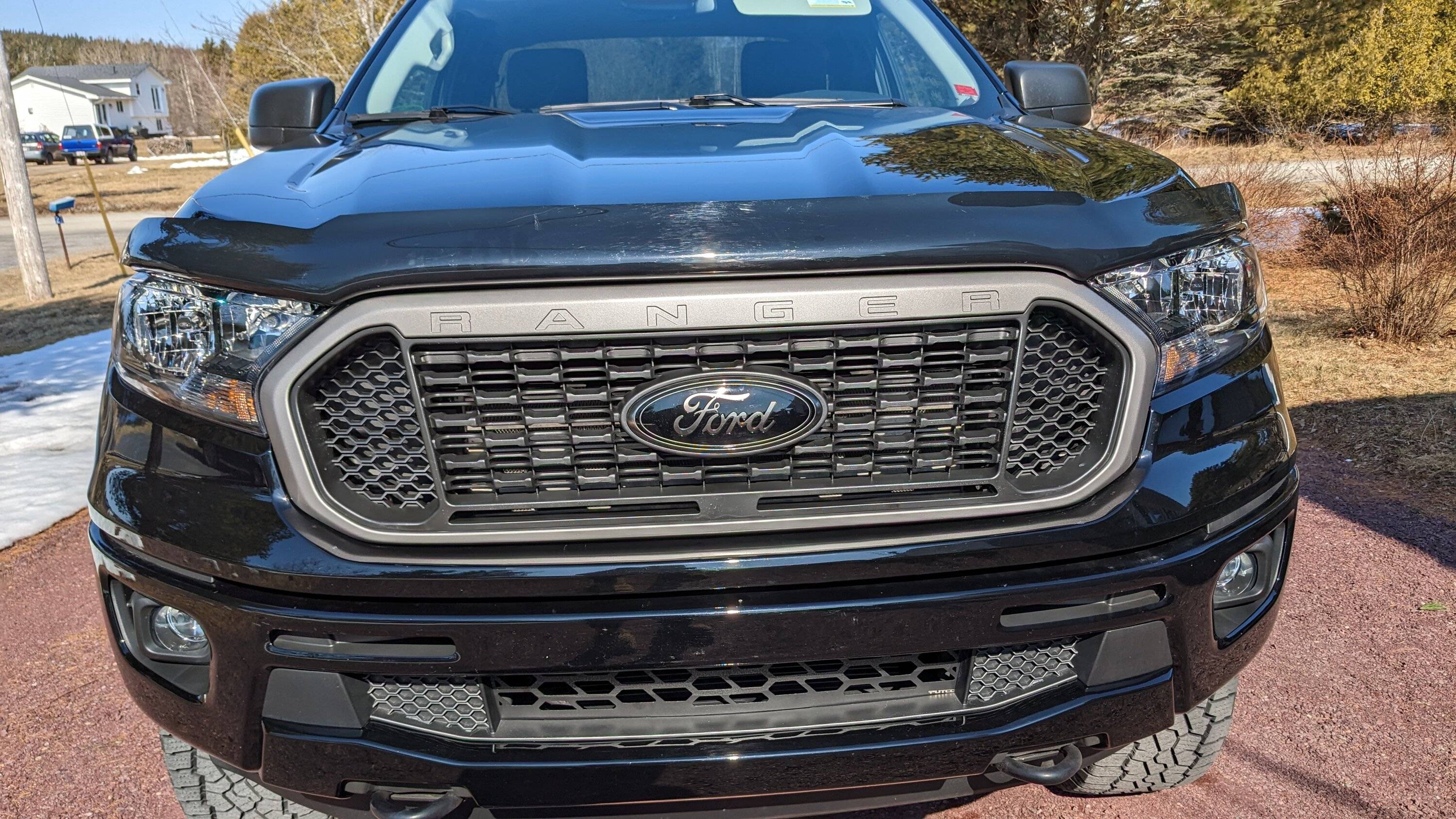

From what I understan these have rivets that need to be cut so I am goping to pay the dealer to install
No the rivets are only for the DIY colour mods. If you buy the factory parts, it's just a pair of 10mm(?) nuts on the back of the grill for the emblem. Also some bolts and plastic clip pins to remove the shroud. Pretty easy job, I rate at 2 out of 10.
The tailgate has a small notch on the under side of the emblem. Insert a small screw driver and gently pry it off.

so I watched the video again ... and took another look at my engine bay ... and I tend to agree with you. not that hard and no rivets so will just pick the emblems up and do the install myself. it's about time I started doing some of this shit myself again. With my Mustang I was in in the sandbox most of the time and didn't really car about the cost so I just paid to have stuff done while I was out there and could just sit back and enjoy the car for the month I was home. Now I can take the time to do it and save myself some bucks that can go for other fun parts. Electrical stuff however I will continue to pay for, cause if you fuck that up it's hell to fix
Yeah, I have confidence in you ;)
There is nothing to really nothing to hurt as long as you don't over-tighten and break them, or drop something and scratch the paint.
Looking forward to photos.
