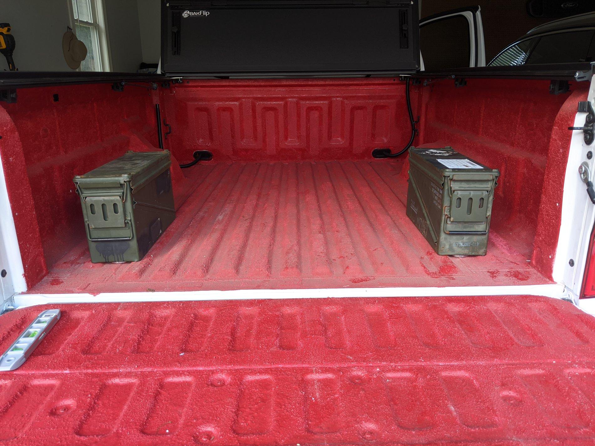

So I've been looking for some ideas for bed storage for my recovery gear and small items and I thought I'd try something different.
I was able to get ahold of some ammo cans and drilled three heavy duty magnets into the bottom of them. This will allow me to take them out and put them in the bed quickly if need be.
I'm not sure how they'll hold up when on trails and everything is bouncy around and what not, but we will see this weekend how that goes.
