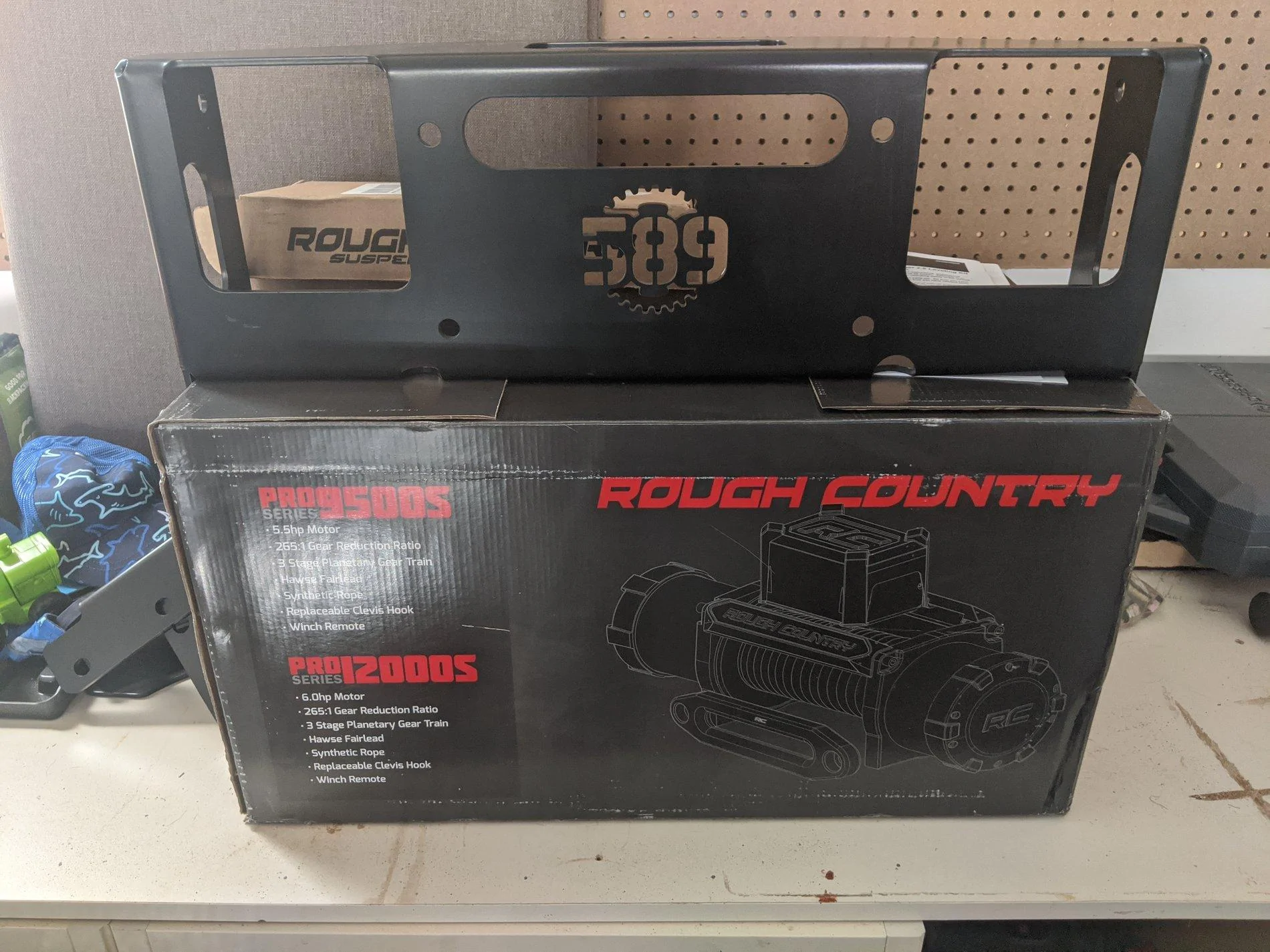

Today my hidden winch mount came in from 589 Fab! This will allow me to add a winch and keep my stock bumper. Will be working on the leveling kit and this all day tomorrow. As always, I'll post pictures once the job is done.

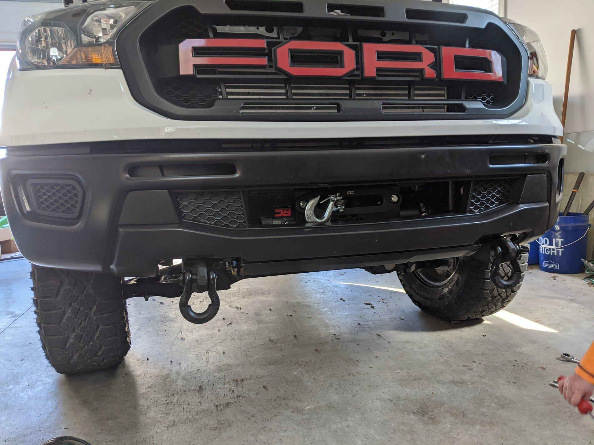

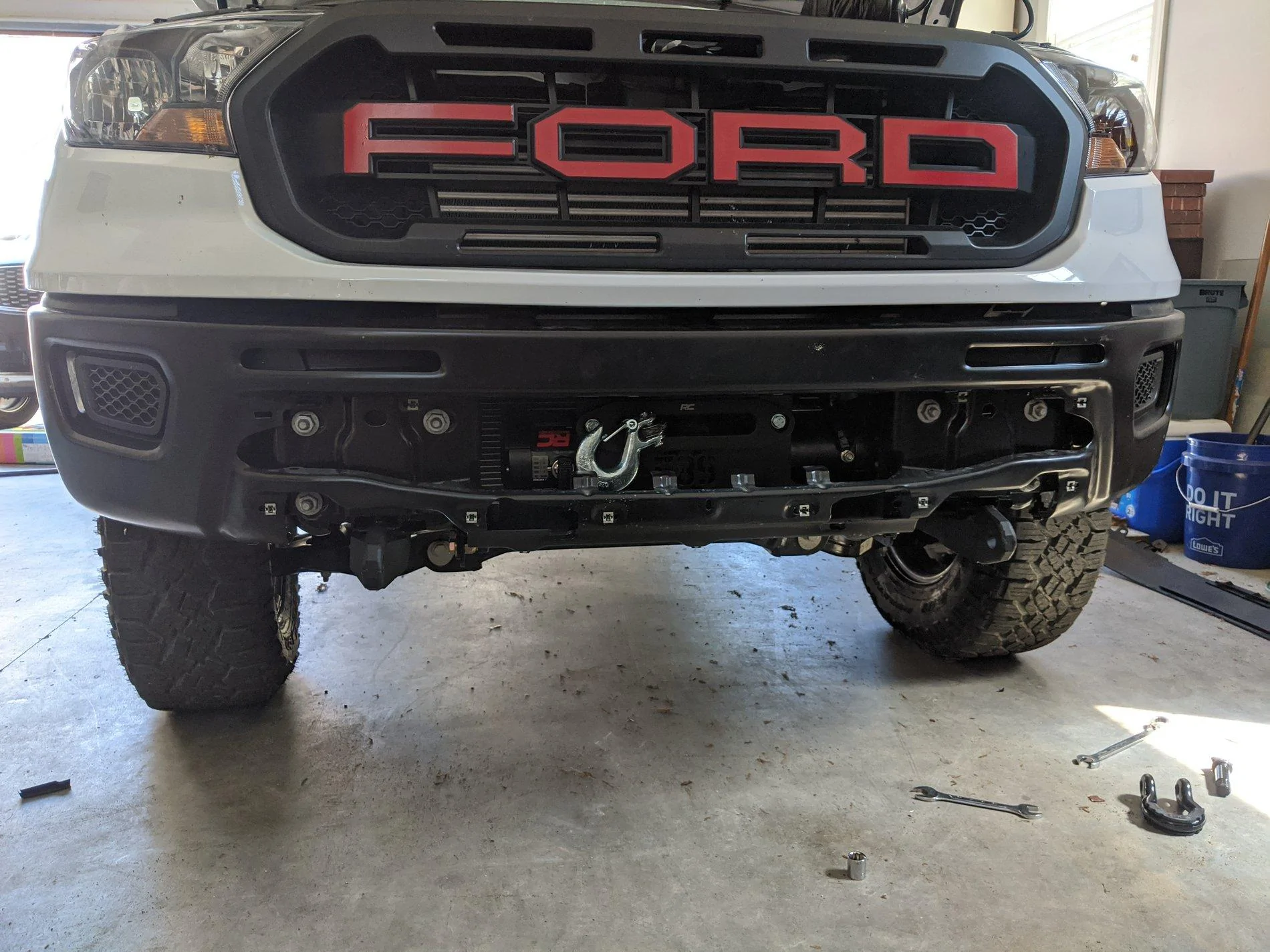

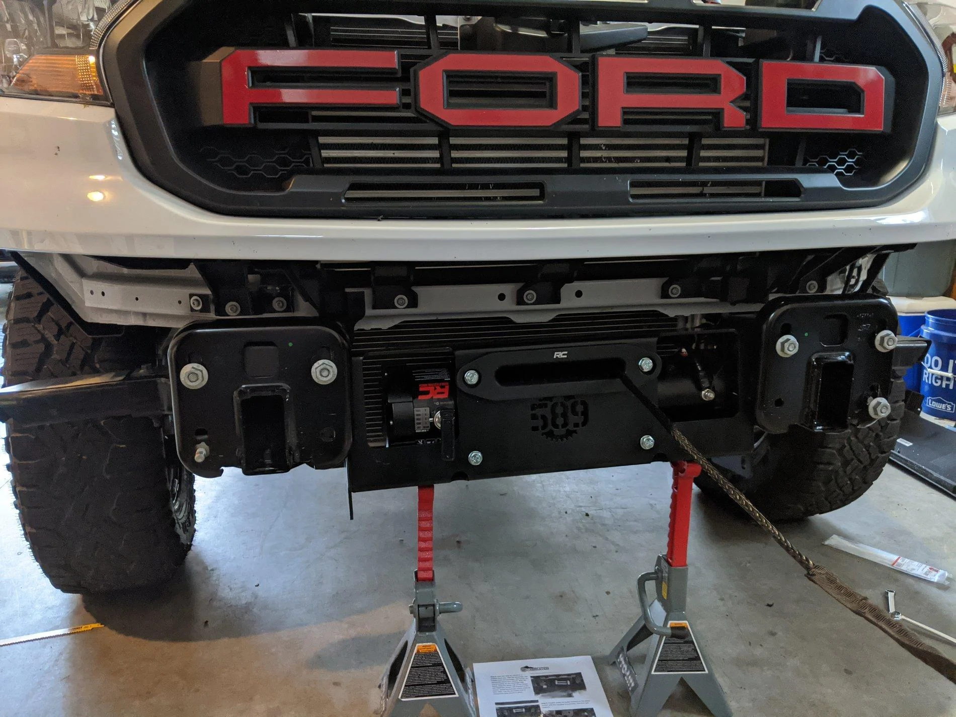

Alright, so some progress was made with getting the winch and winch mount on.....this isn't just a bolt on mount. Some work has to be done that isn't laid out in the instructions, especially with a base model XL. I'll write 589 Fab and let them know so that maybe then can add some extra notes to the instructions to future folks like myself.
We had to stop with the install today since we need to get some extra bolts. This mount fixes into the front hook mount location, but if you dont have front hooks, you don't have the bolts to make it work. I reached out to Ford to get the bolt size, still waiting to hear back.
I could go into more detail about the issues I had if any one has specific questions.
As for getting the winch itself hooked up, it was very easy, just make sure to read the instructions lol I have issues with that at times. Again, if you have specific questions, feel free to reach out.

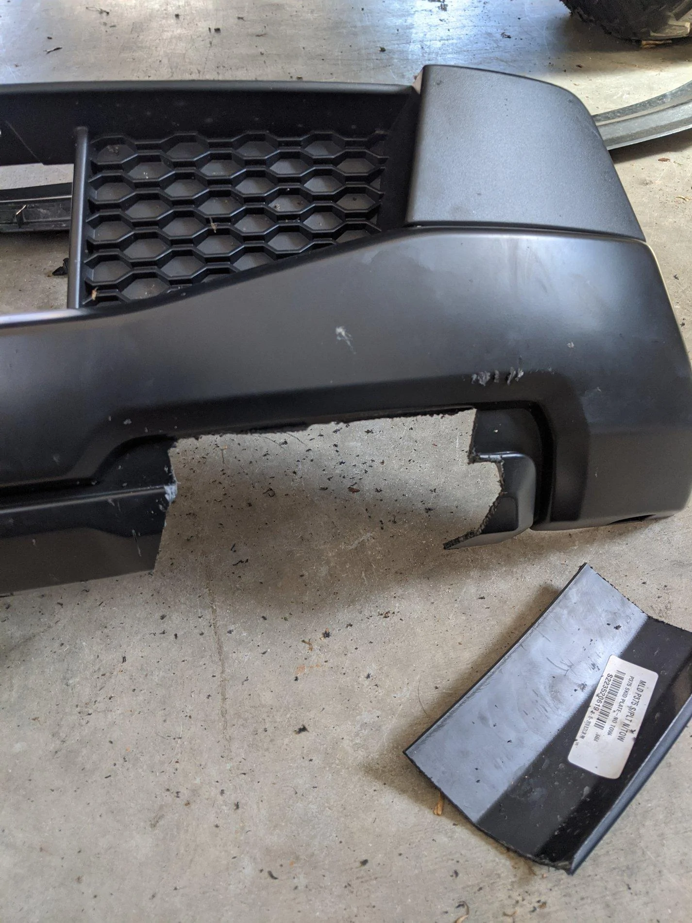

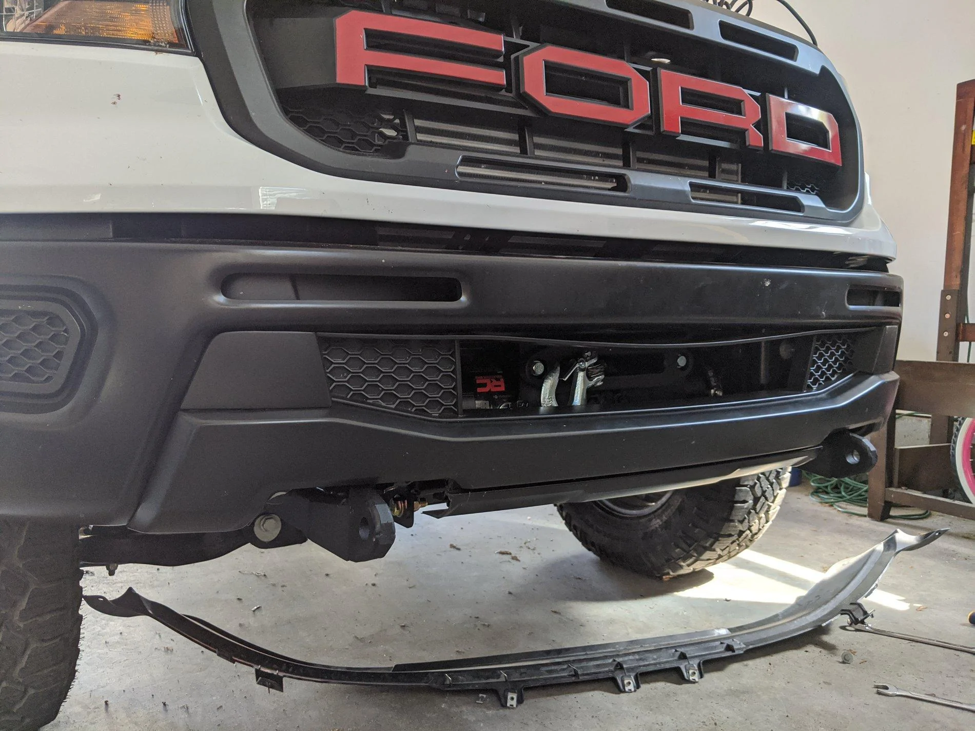

What a long day of work. So, alot of things had to be moved around to make this set up work. I even had to do some custom fabrication to make slots for the tow hooks. In the end, I love how it turned out. I'm not going to write too much about the work I had to do outside of the instructions, but if another owner is looking to do this l, feel free to reach out and I'll help you out.
