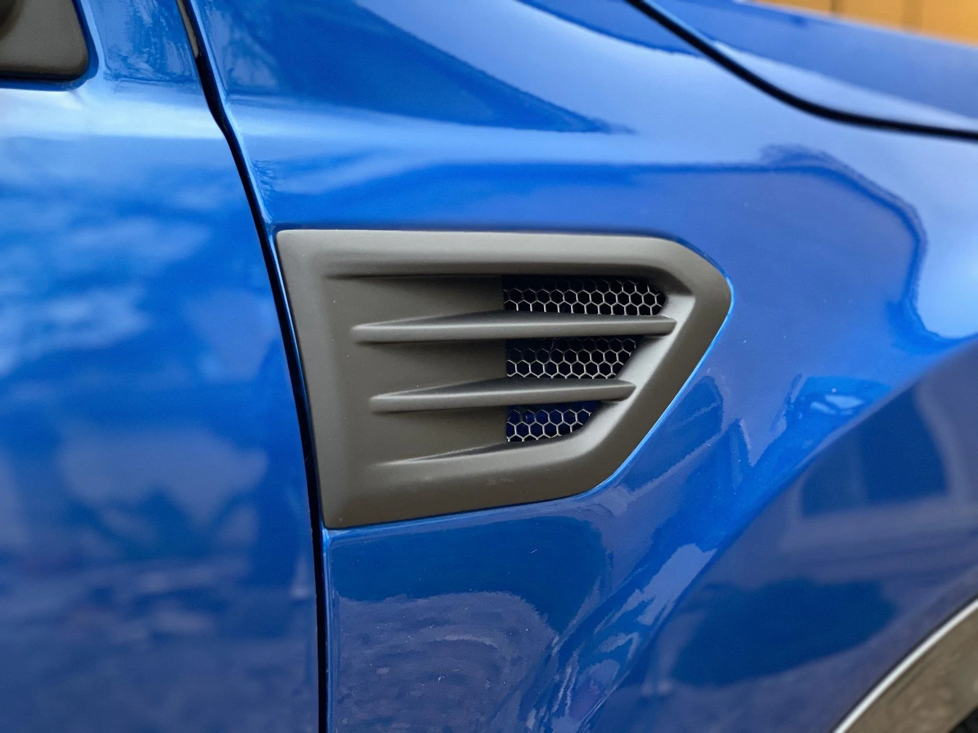

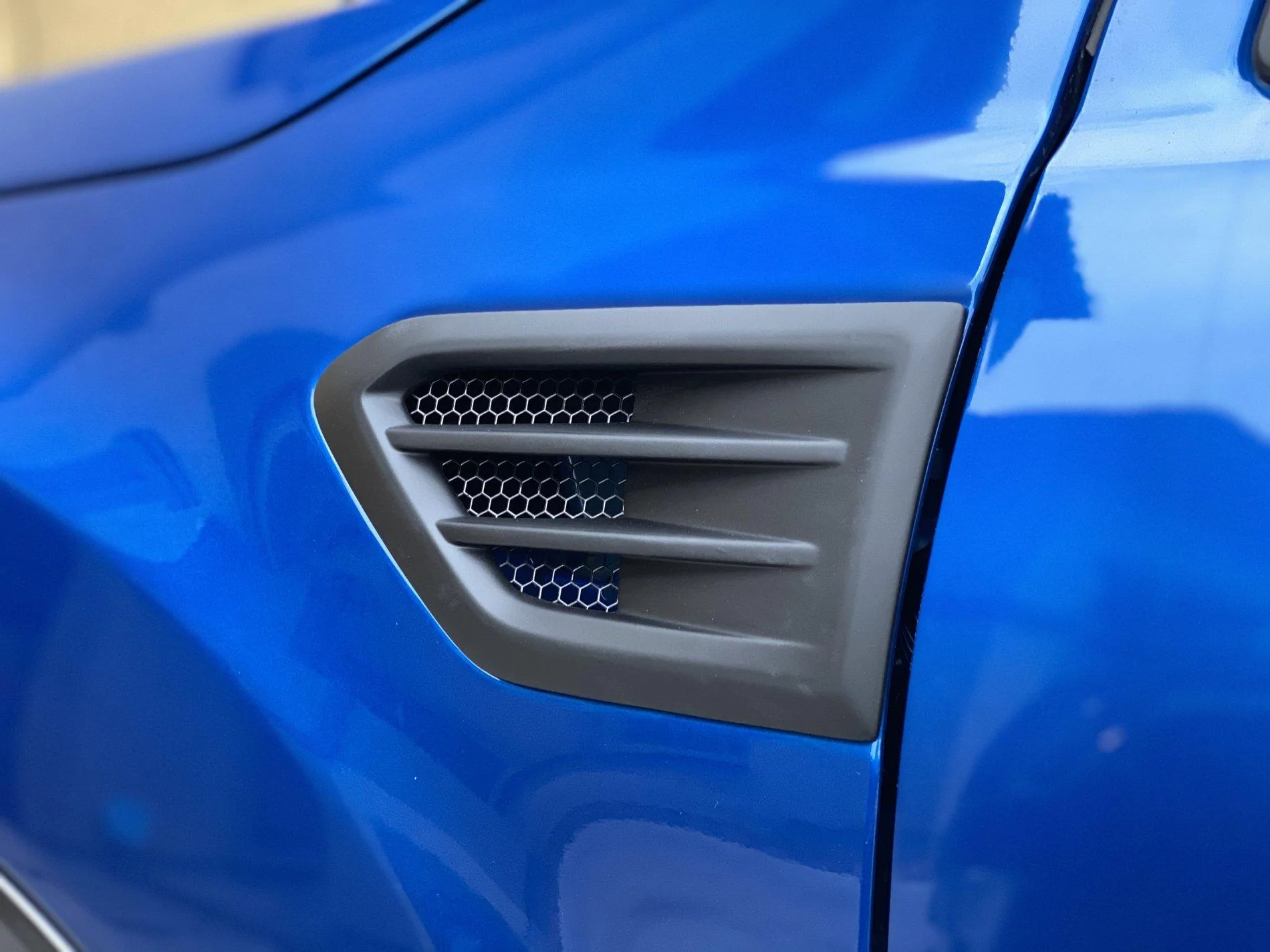

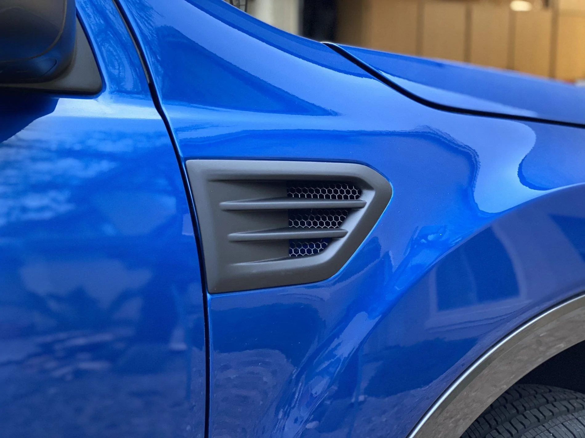

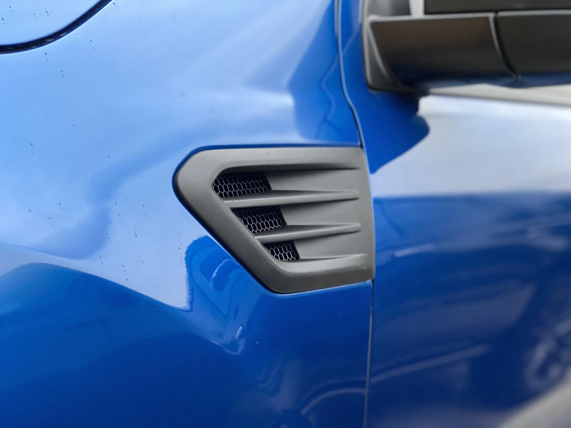

Mine just arrived from Rogue Off-Road....
Getting ready to remove the stock ones and put one the cool ones...

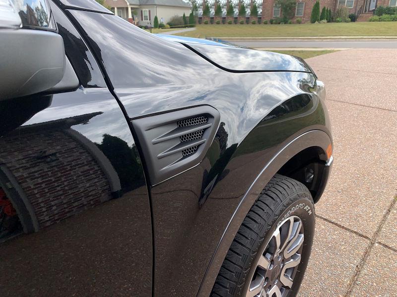

@BHunted what did you use to pry it off??
Auto door clip, panel and trim removal tool and my fingers. Original held on with about 5 clips and a small strip of 3m tape. Get under it with your fingers and slowly un-clip.... Slowly remove it from the tape. Heat it up with a hair dryer or similar if necessary. Tape is on the side near the door.. I did it when it was in the sun and hot out. Just makes it easier.
