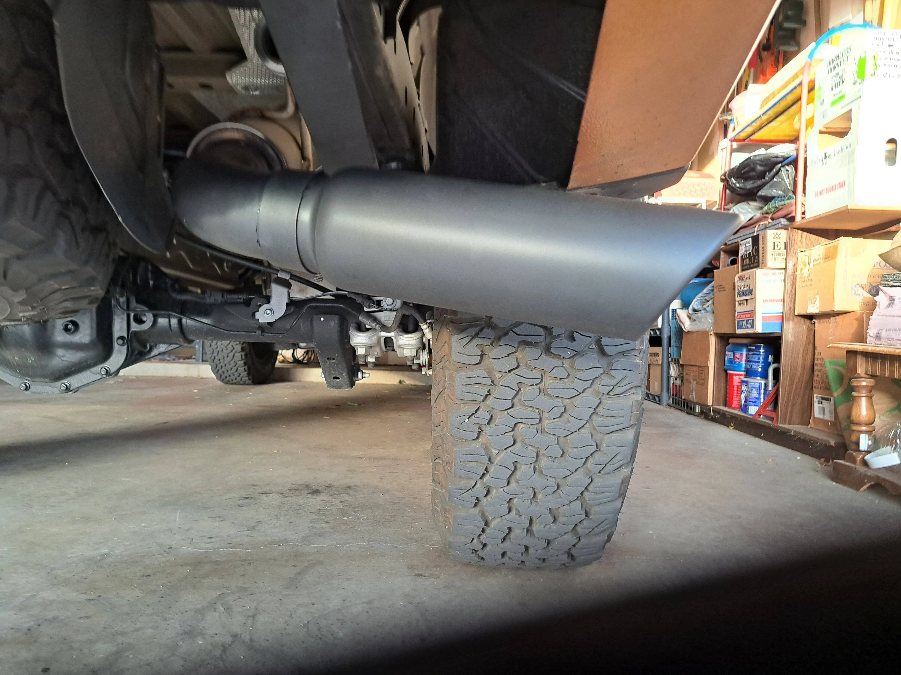

MIne is a Gibson, its a black ceramic coated stainless steel, heres a link. Mine came with the kit i ordered but you might get lucky and be able to buy just the tip.
Tip Description: 3in. Black Ceramic T304 Stainless Round Slash-Cut Tip. Clamp on.
https://gibsonperformance.com/i-23266808-black-elite-cat-back-single-exhaust-stainless-619717b.html#!year=2019||make=FORD||model=RANGER, FX4||submodel=2.3L, SUPERCREW W/5 FT. BED

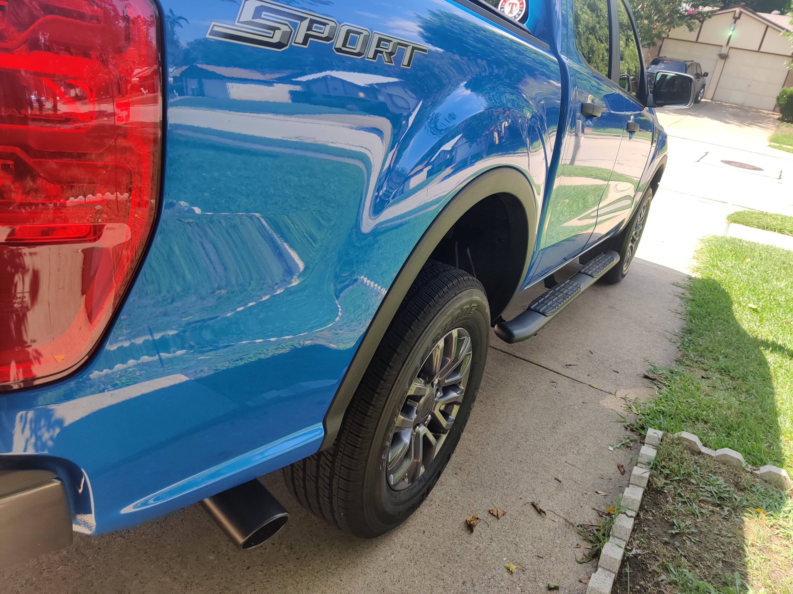

Mike,
I looked at your link and it showed:
BLACK ELITE CAT-BACK SINGLE EXHAUST, STAINLESS, #619717B
Did you get this complete exhaust system or only an exhaust Tip? I got just only an Exhaust Tip from Go Rhino :)

Mike,

I ordered the complete kit however if you go to there home screen at the top there is a link to all of the tips they sell with the kits, but when i clicked the link (after i posted 1st reply) the link to my tip only brings up all the info on it and it did not show a price, surely if they stock them a guy should be able to buy it if you placed a phone call to ask?
I went with the ceramic coated black because it is stainless plus easier to keep clean with all of the asphalt roads and sealers around here i was constantly removing tar off of my chrome tip i had on my F150.

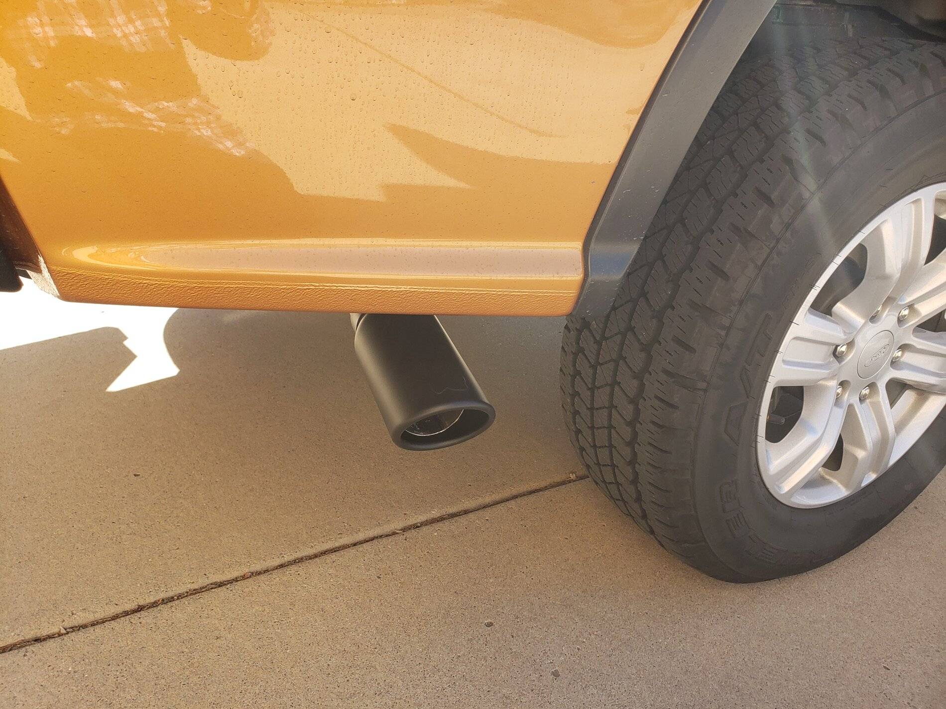

Glad you got the 14" instead of the 10" which I started with but now have the 14" Also painted the tailpipe with Rust-Oleum High Heat semi-gloss for Grills. :)

That stuff is awesome. I had to repaint the tip I got due to fading... already. Works great on a grill or exhaust.
It is great and long lasting! I learned that the secret for success is in following the mfg.'s instructions. I sanded and cleaned the tailpipe then applied 3 coats waiting approximately 2 minutes between coats or until the previous coat stopped looking wet. Then waited an hour after the last coat and took a 1/2 hr. drive to bake it in with the heat of the exhaust. Not a blemish on it :)

I read your post about swapping out the 10 for the 14 and thought that since I am an old guy, I should try and learn from someone else's mistake for once. And wouldja look at that! it worked!!!
