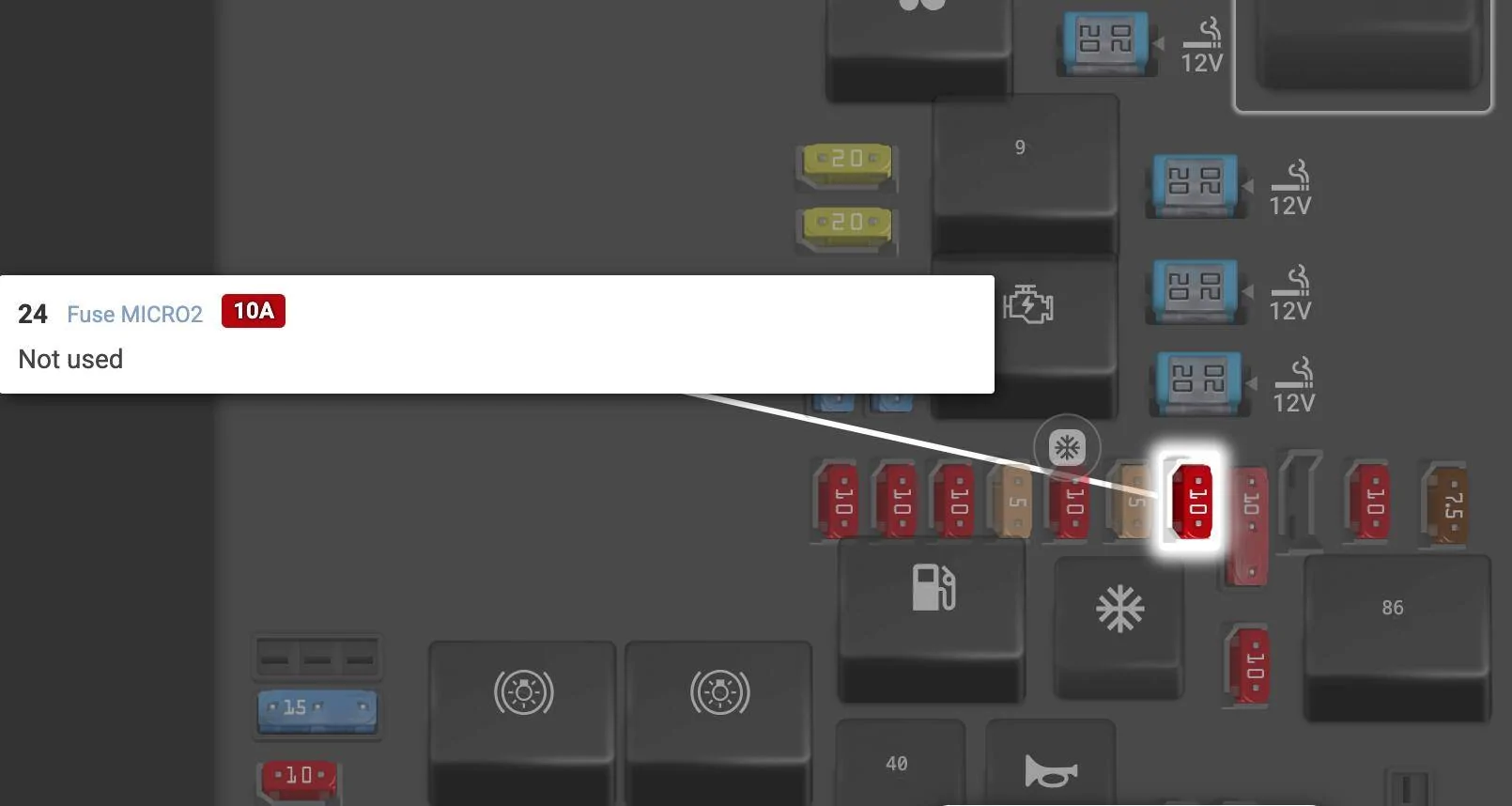

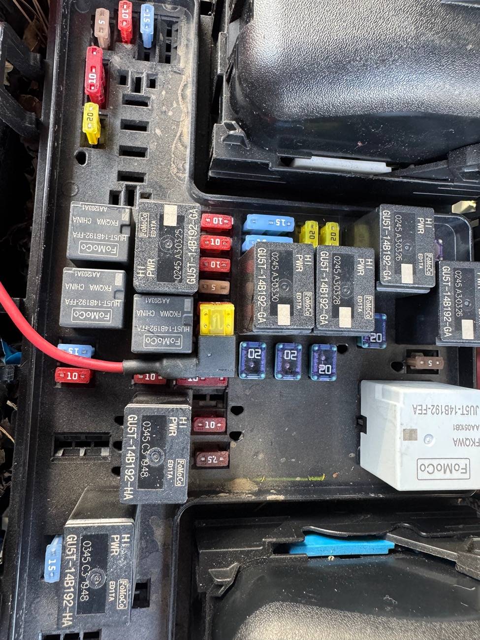

FYI - Fuse #24 is NOT a available slot for ALL, some such as my Ranger, fuse #24 is an EMPTY slot and no contacts at all in that spot, I do not know what the specifics are (Year-Trim-Etc) on if you actually have a source to tap.
adv_ranger
Nico
Mar 16, 2020
97
88
Seattle, WA
2020 Ford Ranger XLT FX4
Medical Student
Fun fact, you can fuse tap an unslotted fuse port as longer as there is a metal contact in that port for you to put your tap into. You just run a single surge fuse on the tap, and do not need to add an original port fuse. I will have to take a look at my fuse box and see if I have one there or not!
airline tech
Aug 24, 2022
4,631
8,845
Midwest - KS
Aircraft Tech
True, but both of my slots on my 2022, are just (Plastic) no pin contacts at all on either slot. I think some Rangers are set up for (one) side of the fuse is internally wired but there is not a pin on the other side. (so, no output wire) feeding over to the C1035 connector.
Since this is a (UNUSED) fuse location, somewhere Ford wanted to save (PENNIES) and removed the internal contact for the main power feed.
I am going to say, if you have a physical fuse in spot #24 then you have (one side) powered, if it is empty (it's completely) dead.
This may be a (Unseen) & (Unknown) Covid - If is not needed why make the PCB with power for it.
adv_ranger
Nico
Mar 16, 2020
97
88
Seattle, WA
Medical Student
Just checked and I do have fuse #24, so I plan on tapping it tomorrow! Sorry that yours does not have a line in on power. I think fuse #22 would be my next option if I didn't have #24

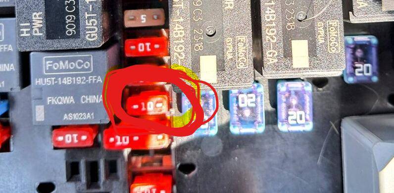

gannbino2001
chris
Jan 5, 2025
30
Nevada
2022 Ranger XLT
It is this one... It is hot when the key is on. I moved my radio feed to the inside fuse box but that one worked well.
I really would like a power feed that is hot when the radio is hot.
What fuse did you use in the inside fuse box?
