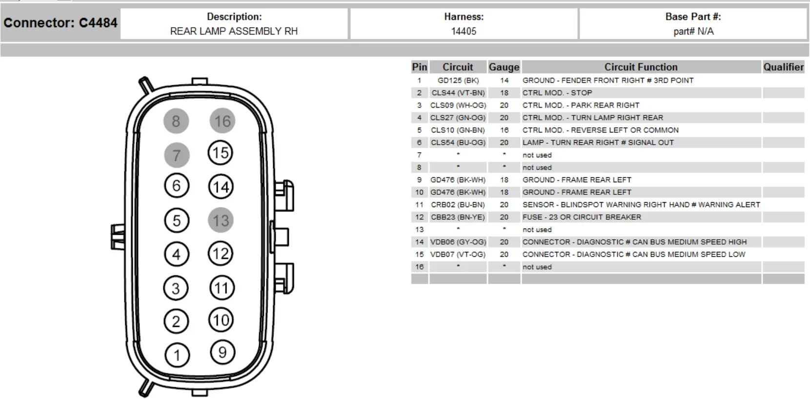

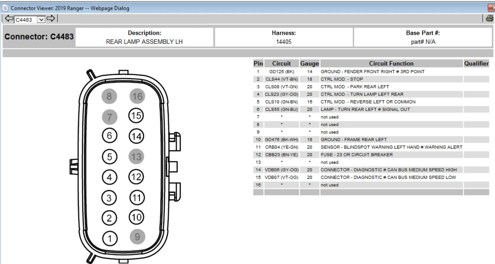

@airline tech would you happen to know what is the AWG of the wires on C4483/4484 connector?
