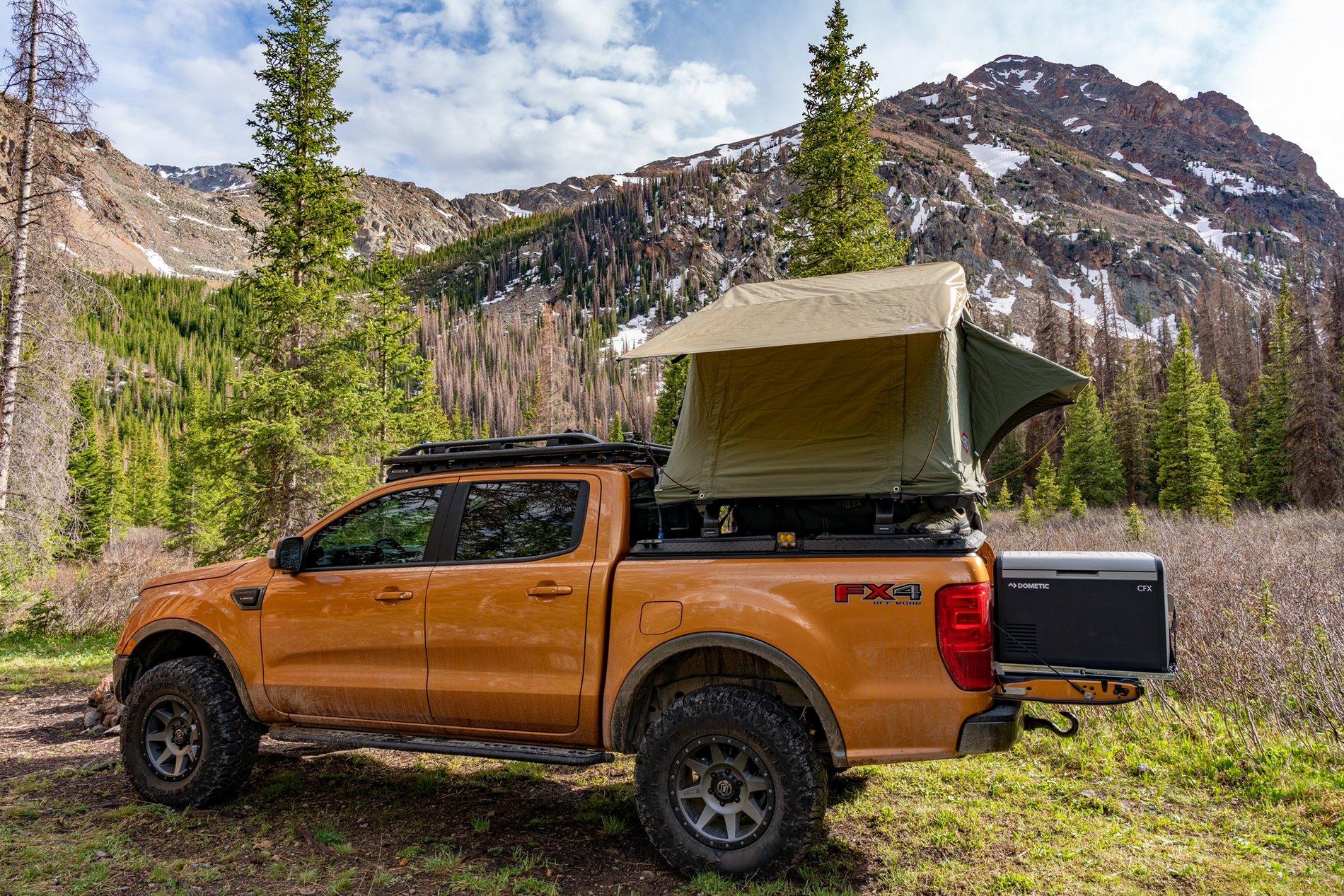

Decided to install a fridge in the bed for the longer camping trips. Has made life on the trail even more enjoyable and easier to keep healthy foods around.
Fridge: Dometic CFX3 55IM
Slider: DFG Off road (I replaced the slide with a longer 28” one to allow clearance past my diamondback cover.

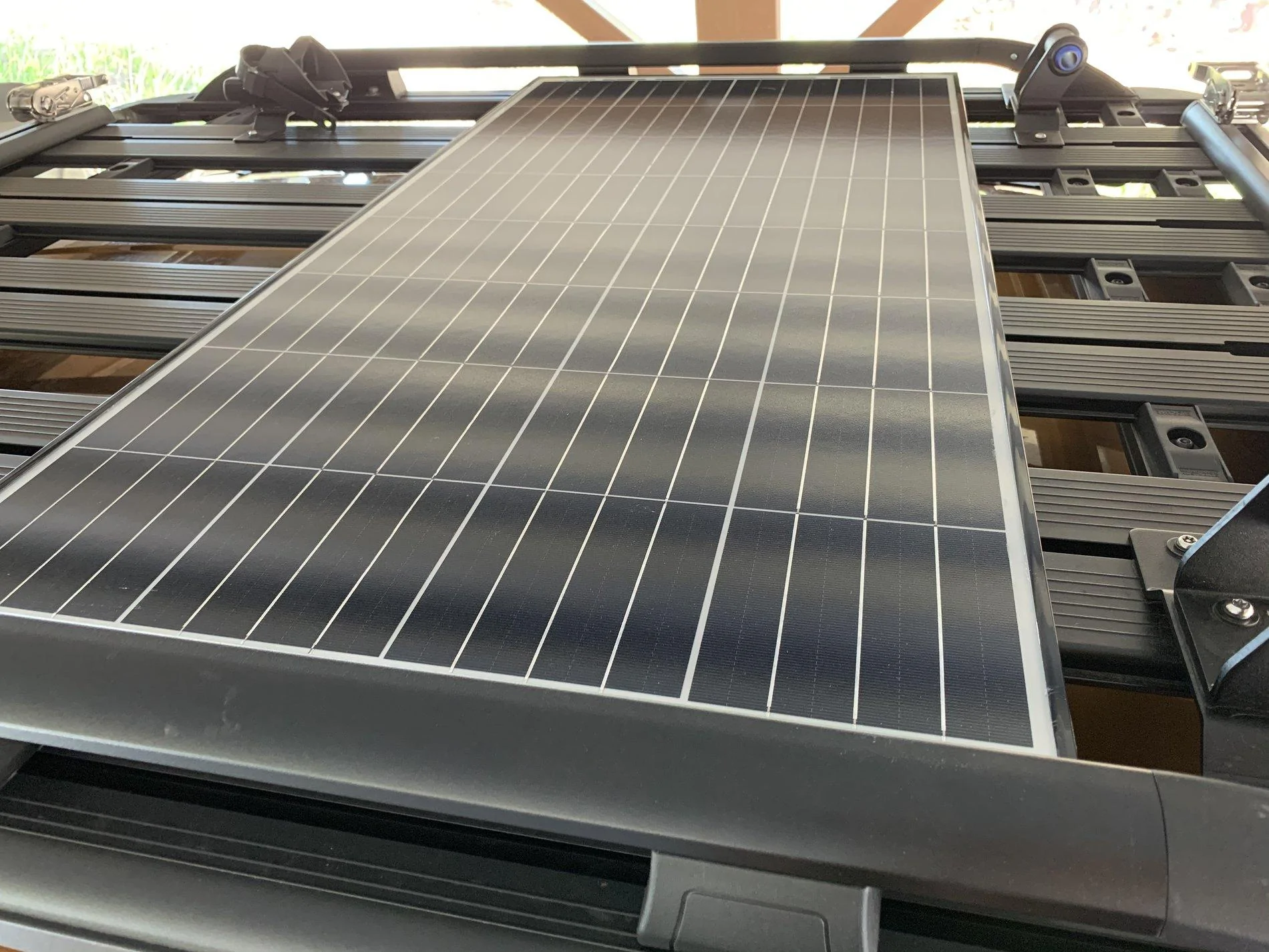

Fridge is running off a lithium battery pack in the bed and 100w solar panel that’s attached to my roof rack.

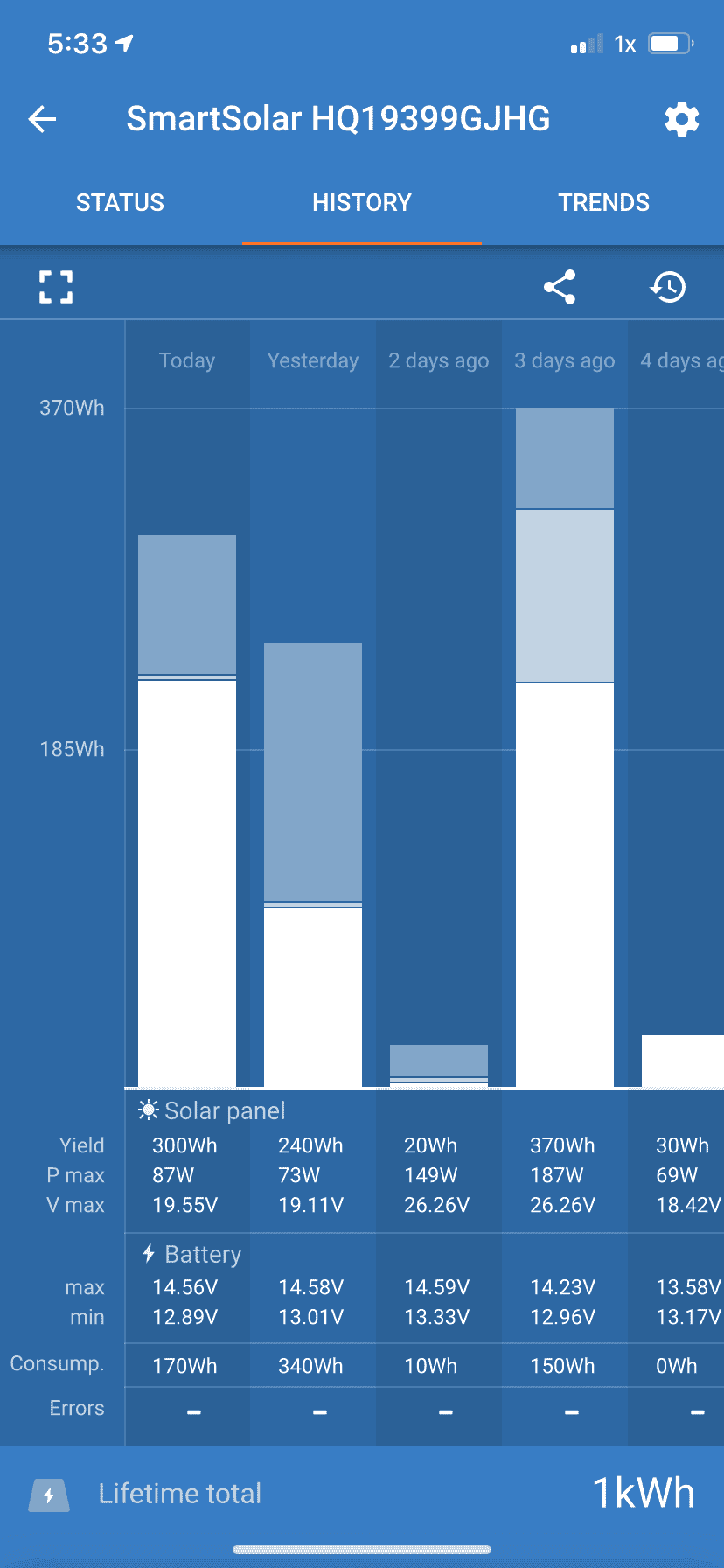

The fridge uses on average 1.2ah at 36*.
The “Yesterday” usage is from filling the fridge with food and drinks at ambient temps. Showing a use of 340wh to bring it all to temp and keep it there for the 24hr period. The “Today” usage is what a normal day would use to maintain internal temperature of 36*.

Waking up an old thread, did you bolt the DFG slider direct to the bed, or do you have a baseplate of some sort? I'll be transferring my ARB fridge to the Ranger when it gets here, but still not 100% sure on how. I was considering a full bed cargo slide, but am now leaning towards bolting a baseplate down so I can attach the slide and some L track in other places for strapping cargo boxes. That CFX3 55IM looks so nice, I'd love to have the ice trays for camping cocktails!
