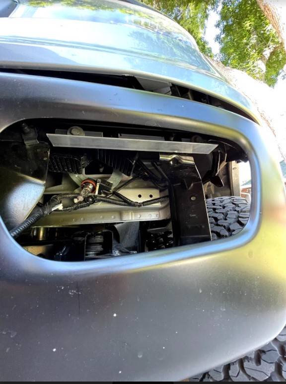

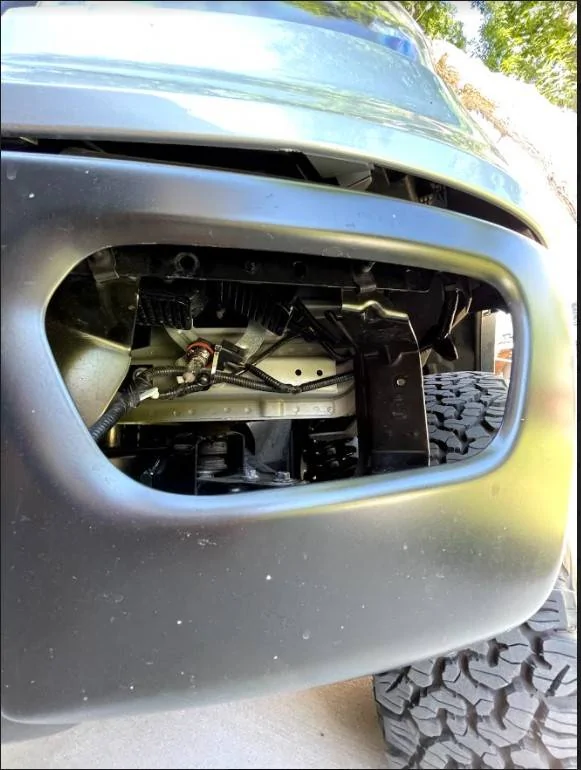

Hi all,
Weighing options for LED fog lights to replace the existing OEM, I was disappointed in how expensive a simple bracket was to mount an LED in place of the OEM fog light. Upon taking out the fog light housing, I realized that the other DIY LED pod method meant sandwiching the light between a plastic bracket. Thinking long-term, I could see issues with melting the OEM housing if you go that route.
So, I went my own way:
Removed the OEM housing and fog light:

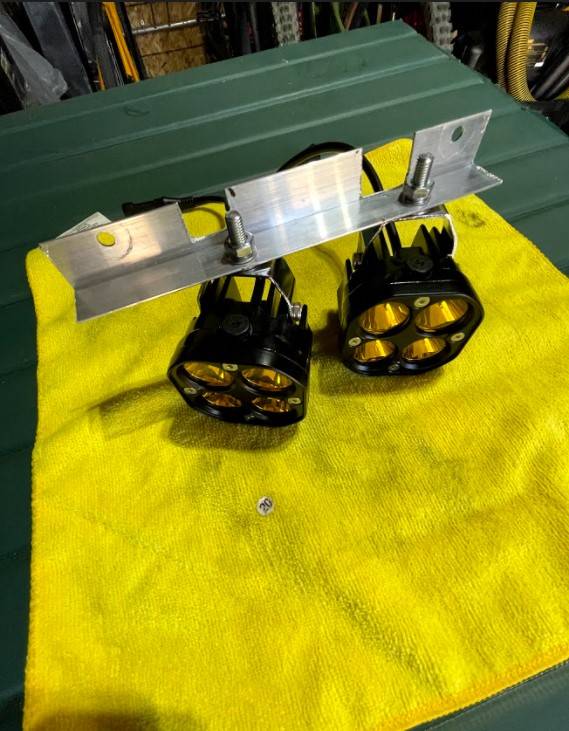

Created a simple bracket from scrap aluminum 1'' angle:

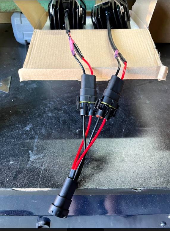

Wired up the lights:

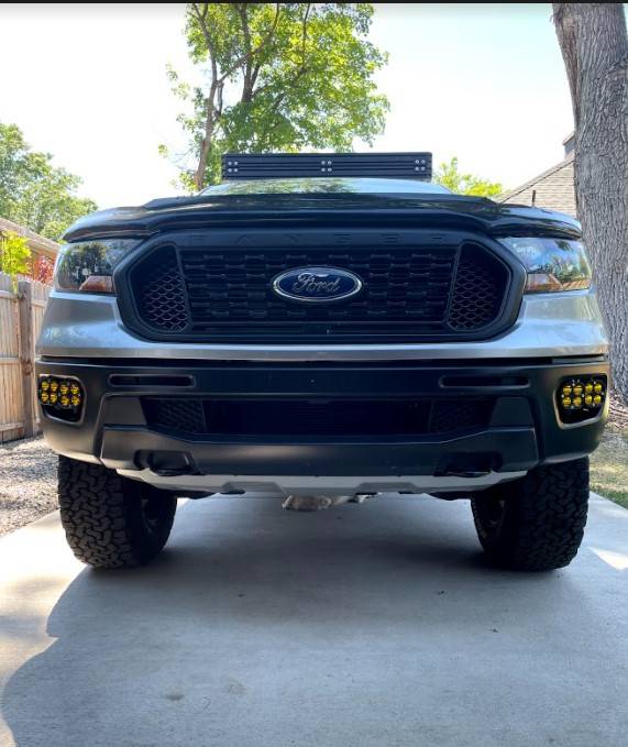

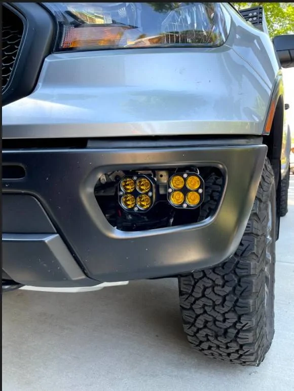

Boom! Dual LED Fogs, wired up to use the OEM switch:
Work great and are SUPER bright (If you plan to use as fog lights on the road, Make sure to purchase DOT approved fogs). I do not use these lights in traffic.

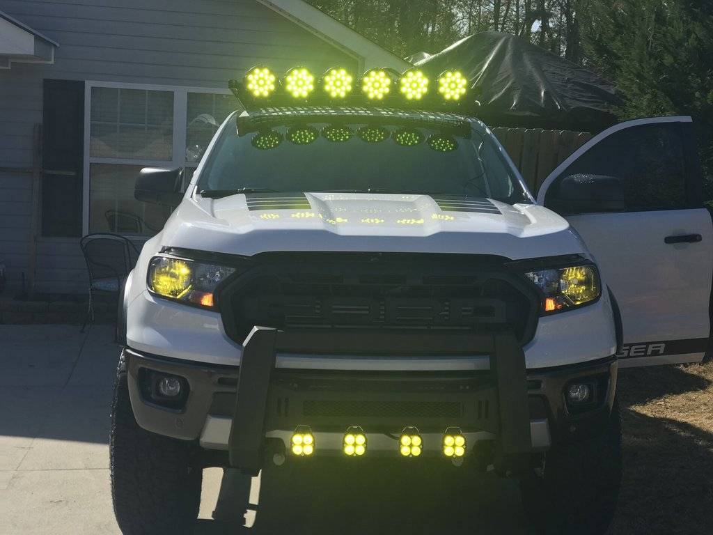

I had those lights too at one point. lol They are bright.
(very old picture at this point, lighting setup completely changed)

Great write up. Now if only we could buy a fascia to fill the gap, I'd be in.

That's cool! same concept, but DIY allows you to save $100 from buying a prefab bracket. I plan to redo mine with angle iron (aluminum won't cut it long term). I like the idea of adjustability in the bracket.
How about heavier gauge aluminum? Lighter than iron and rust proof...

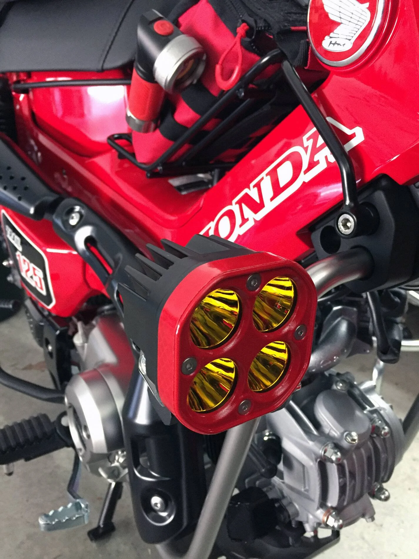

Those are the same lights I mounted to my Honda 125 =)
That's an idea too! I am leaning towards steel as I can purchase plate and bend it, cut out a slot to make the light positions adjustable... But we shall see.
