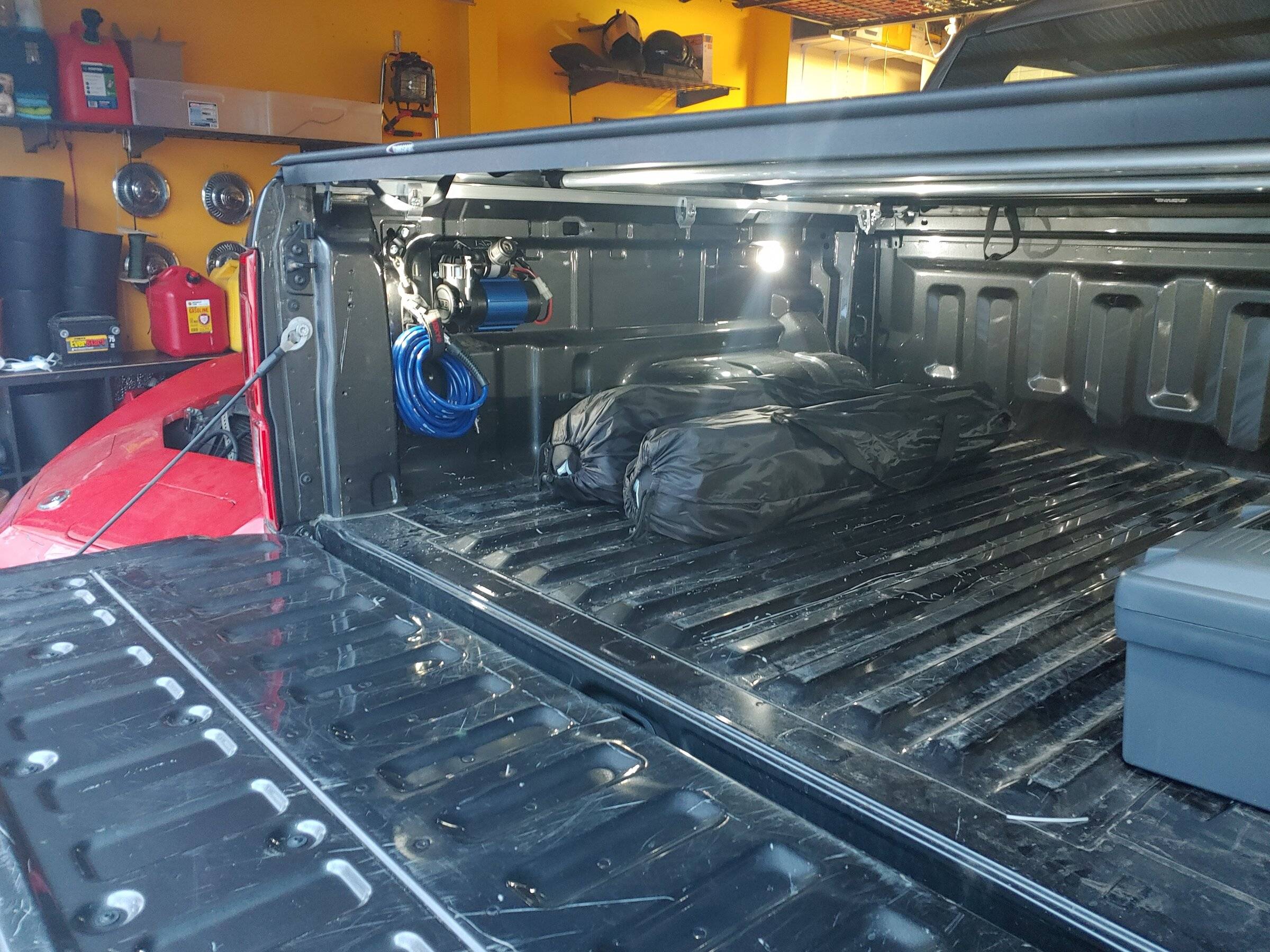

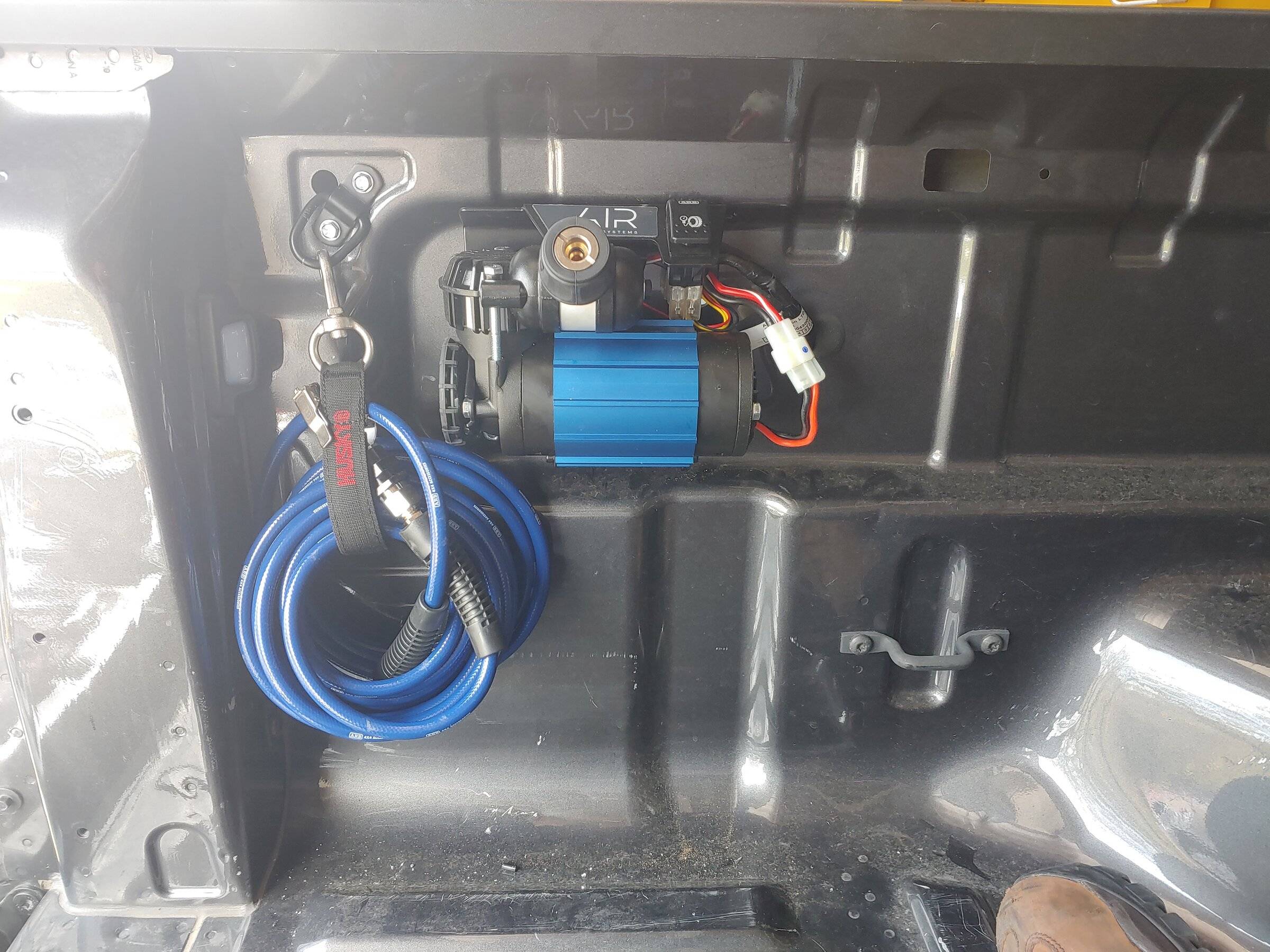

Lol so chamces are you have the same kit I ended up buying(except mine said Ford Performance). I wasnt a fan of opening the hood just to get an air compressor moving so I thought of doing a onboard system using the portable kit. What I did was run the wires from the compressor all the way to the battery and it works well. If you look at the pictures you will see how it is. Now it may not be how you want to do it but that is totally fine.

Did the kit come with a harness to wire like this? This looks exactly like the kind of set up i want to install
Nope. The harness it came with being a portable kit was the basic leads(maybe 5 ft long) with heafty alagator clips. I had to buy my own wire. It work well to say the least
