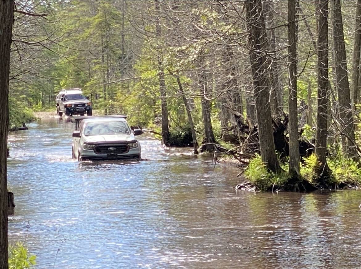

No water in diffs, tcase or cab. Checked fluids afterwards. Also was in constant motion with trail control set at 2 mph.

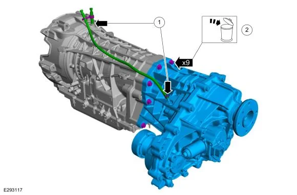

Hello fellas. Where front diff, gearbox, transfer case breathers located? I found rear and one (IDK which one near the oil filter) but can not locate others.?
airline tech
Aug 24, 2022
4,457
8,519
Midwest - KS
Aircraft Tech
Transmission & Transfer Case - Breather Tube Locations
The tube by the oil filter is the Front Differential - Breather Tube
