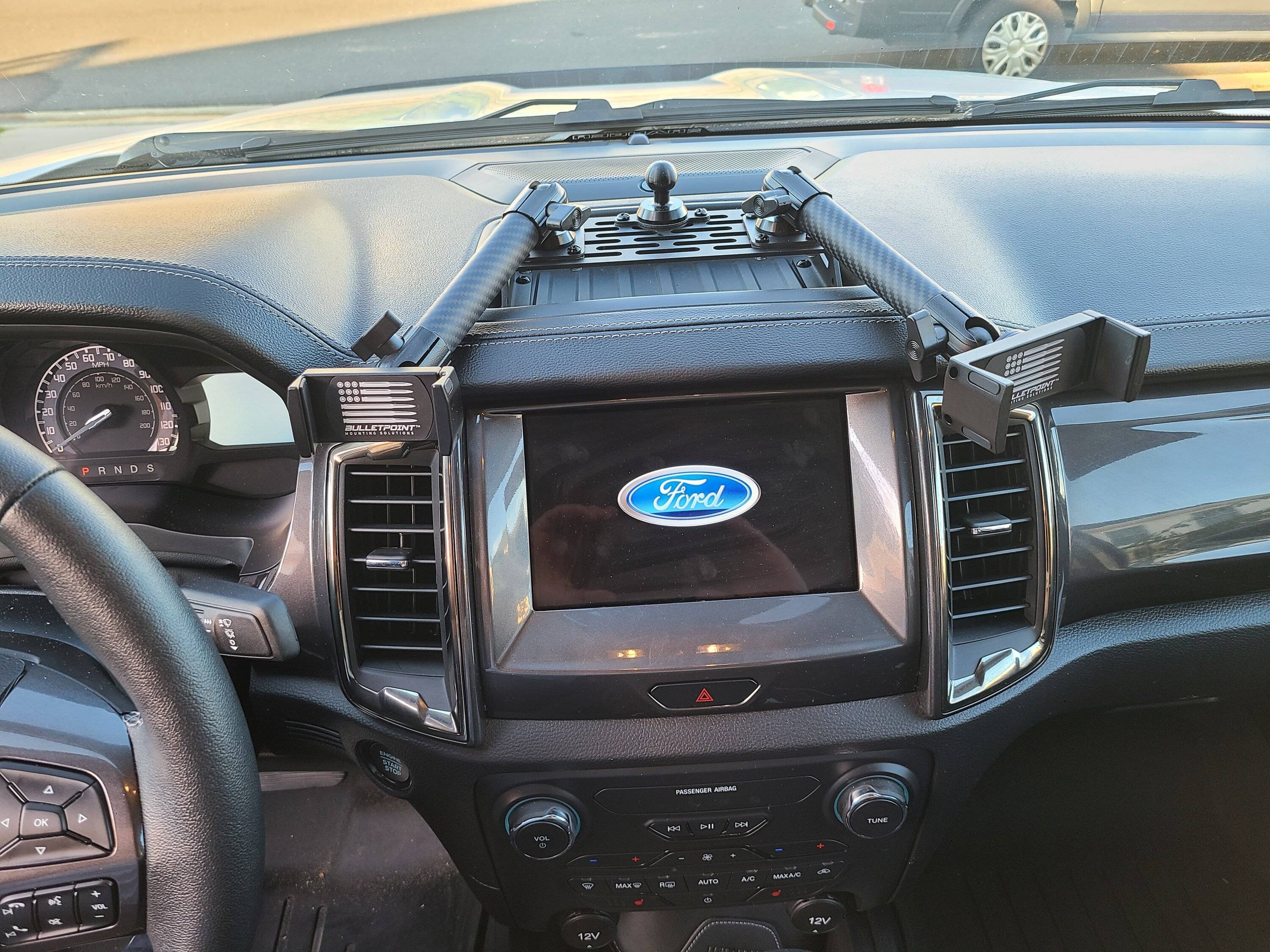

I jut did the same a few weeks ago for a bunch of wires, but from the passenger side. It' very easy from the passenger side to run the wires, but you have the extra step of dropping or removing the glove box. I removed mine because it's only 2 slide pins that hold it in, and was easier to just get it out of the way. The worst part was reaching up to disconnect the damper, but I don't think 22's have it, so even easier. Oh, nd my passenger seat was also out, so I could lay down on the passenger floor to see what I was doing up there.
The first group of wires I sent a single 14G wire in the front right hole (my red arrow) and it has easy pass through above the dash vent, then it's wide open up there. You may need a grabby tool or hook of some sort to reach up and grab it, ten attach your other wires and fish them up.
The second set of wires I used springy, reachy, grabby, flexi-tool thingy, and sent it in the rear right side hole (yellow arrow) aiming it toward the back of the truck and to the passenger side. It fed in very easily and popped out beside the glove box. This one was even easier, didn't even need to lay down to see it hanging in the center area, to the left of the glove box opening. Attach wires and gently pull them up. One wire had a bulky end connection, so I wrapped that in tape to prevent it catching on any of the plastic edges.
You may be able to use the flexi tool on the driver' ides well, I haven't looked up there, but it's pretty easy to run the wires under the dash to the passenger side and up.

Ok, so I'll confirm going towards the glove box is the easier route. I had no luck going towards the driver side, at least not with my patience, or lack thereof.
Popped the glovebox down and saw might light from beneath immediately, had it fished down in about 15 seconds. Then past the other end through an easy opening right behind the A/C control panel towards the driver side.
Used this to snake my wire up and through.
Tapped a hole in my dash tray for the camera screen power plug, might go back with a grommet to clean it up
Happy with my end result up top. Still need to finish wiring to camera and power, and switch.
Thanks for all the input everyone.
