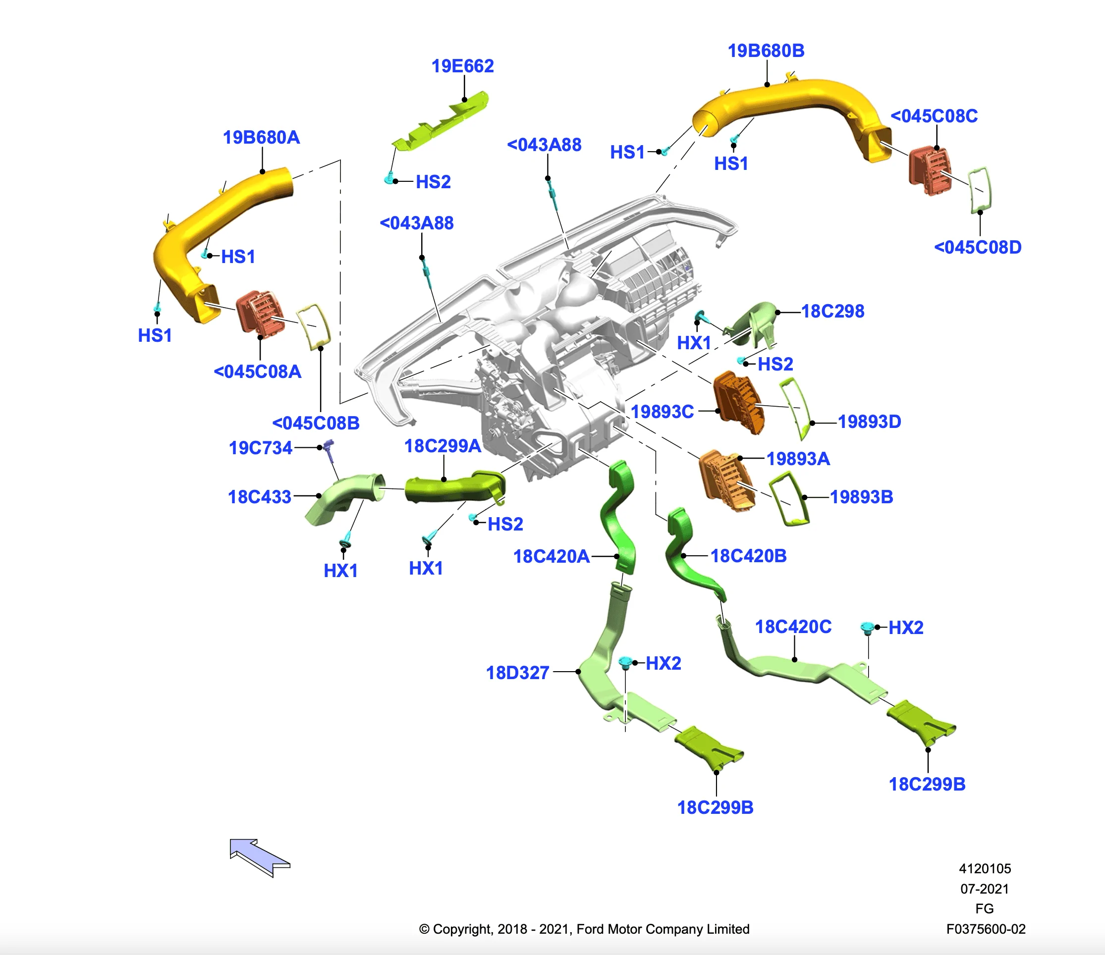

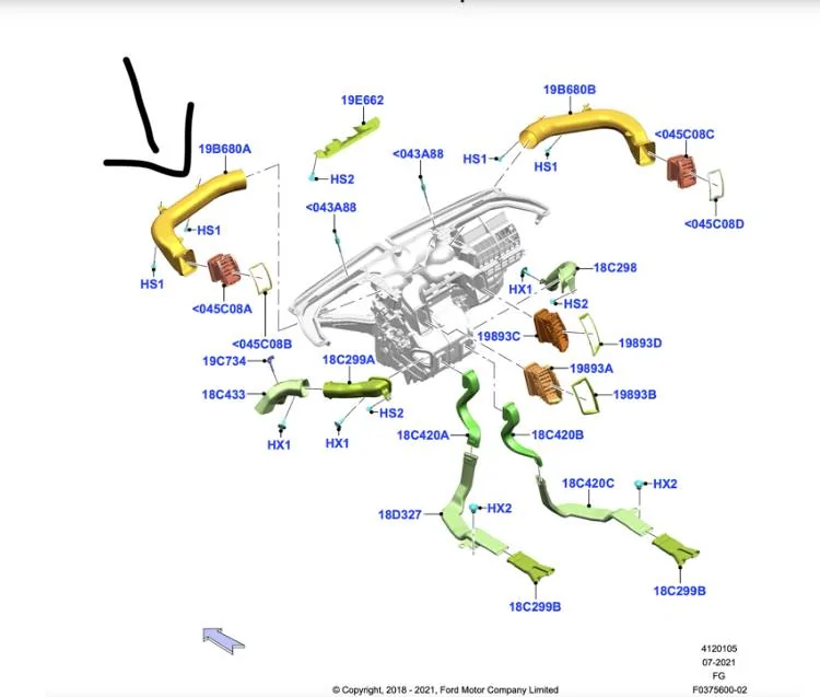

Well it got above freezing around here. I did remove all the insulation I added under the dash and the rattle has not returned. I attribute that to warmer temperatures.
I have an appointment with the dealer so I hope it gets cold again and I can capture the rattle on video.
I also want to try wiggling the defroster duct as you instructed.
So, I checked the defrost duct and it seems solid as a rock but it is about 50 degrees today. Definitely has some reverberation if you tap on it so I see how it could amplify a sound but it doesn’t seem loose.
